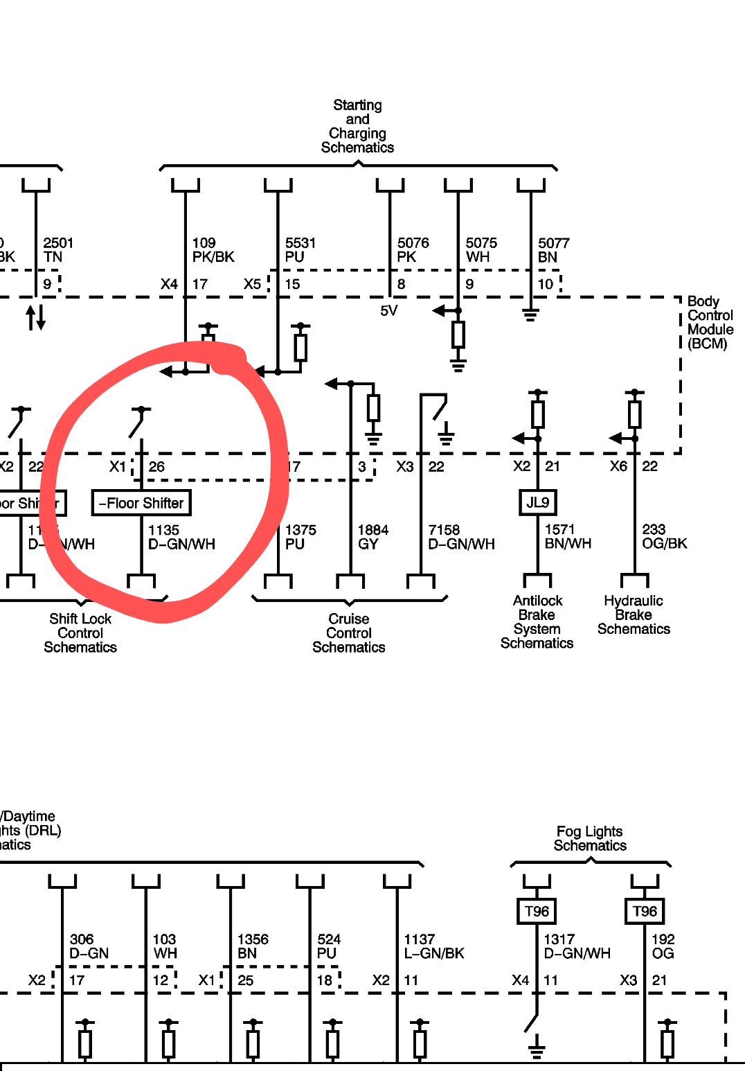

There's a green connector that plugs into the BCM.. What is pin 26 for can I replace it myself?
Jul 27, 2020 at 1:07 AM
AL514
  • 5,696 POSTS
Hello, it looks like pin #26 is the floor shifter going to the BCM, having to do with the shift lock controls. It looks like it's a green/white wire. You can verify by wiring color. I have also included how to replace the BCM. Check out the diagrams (Below). Please let us know if you need anything else to get the problem fixed.

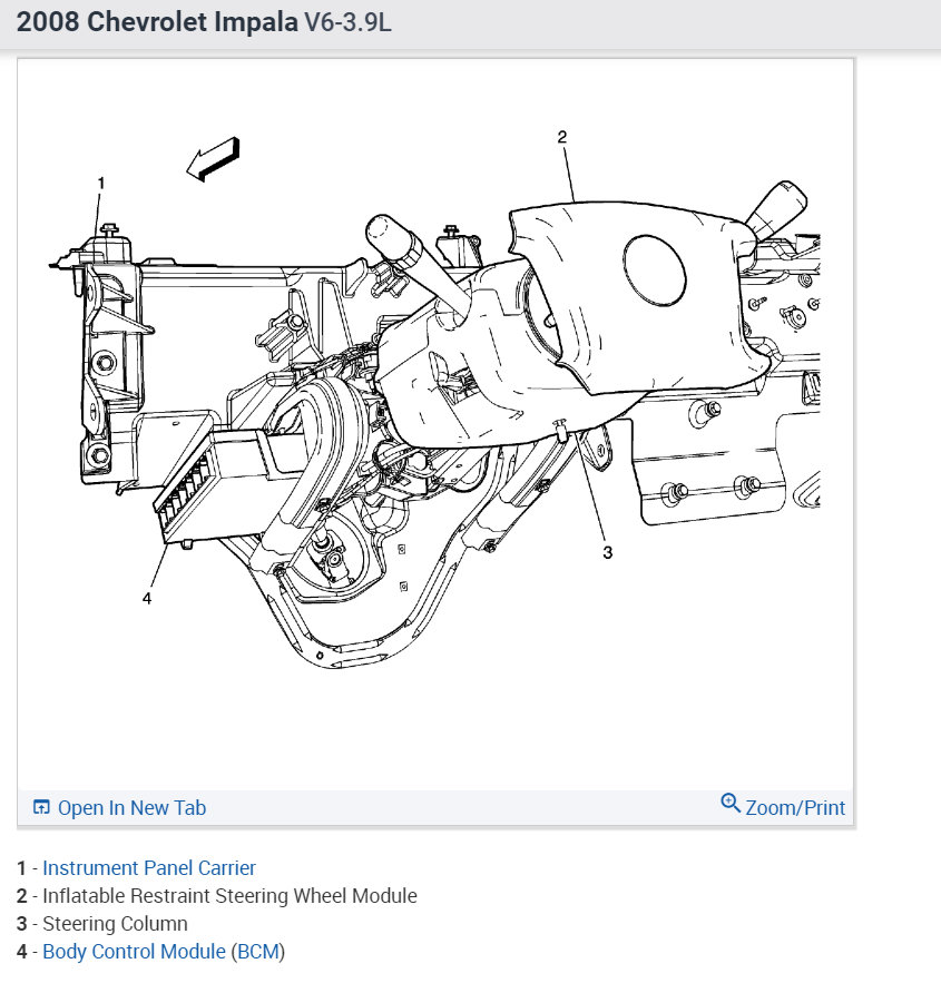

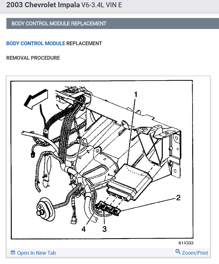

where is the body control module located?
Aug 25, 2020 at 10:43 AM (Merged)
under the dash just to the left of the steering column. Here is the BCM location in the images below.

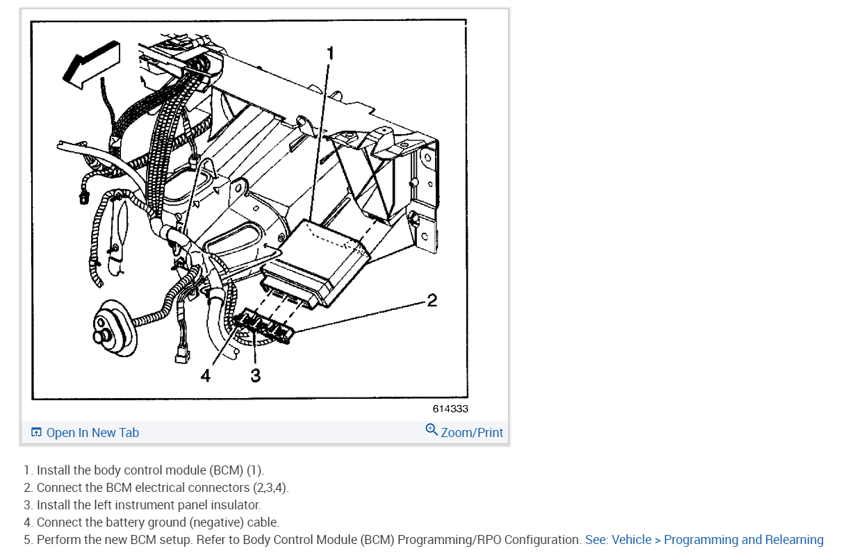

  • 55,711 POSTS
Your BCM is located on the left hand side of the steering column.
If you want to replace the BCM, you will have to have the new BCM programmed at a chevy dealer. You can't do it yourself. Once it is programmed though it's only a matter of swapping the BCM.

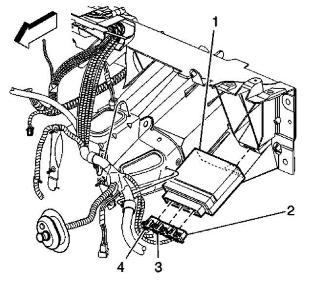

Aug 25, 2020 at 10:45 AM (Merged)
RICHZOMBIE
  • 173 POSTS
If you want to know where it is located it is mounted on the drivers side kick panel. It is a box with three harnesses attached to it. If replaced, it must be done by a dealer since the module needs to be programmed for your vehicle. You cannot swap out a module for a used one since the VINs must match.

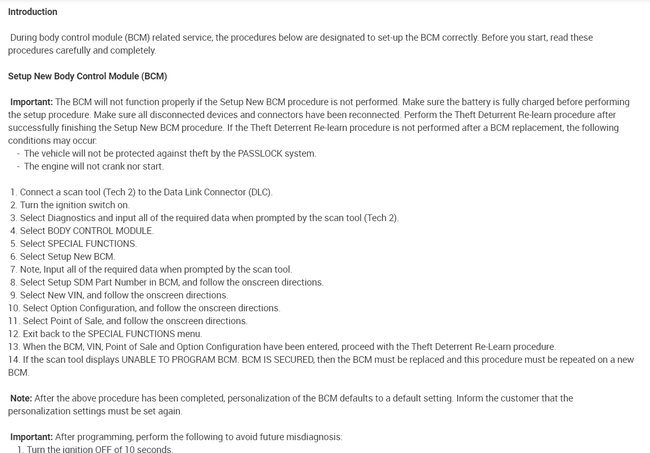

SATURNTECH9
  • 30,869 POSTS
INTRODUCTION
During body control module (BCM) related service, the procedures below are designated to set-up the BCM correctly. Before you start, read these procedures carefully and completely.
SETUP NEW BODY CONTROL MODULE (BCM)
IMPORTANT:
The BCM will not function properly if the Setup New BCM procedure is not performed.
Make sure the battery is fully charged before performing the setup procedure.
Make sure all disconnected devices and connectors have been reconnected
Perform the Theft Deterrent Re-learn procedure after successfully finishing the Setup New BCM procedure. Refer to Programming Theft Deterrent System Components in Theft Deterrent. If the Theft Deterrent Re-learn procedure is not performed after a BCM replacement, the following conditions may occur:
The vehicle will not be protected against theft by the PASSLOCK system.
The engine will not crank nor start.
Connect a scan tool to the data link connector (DLC).
Turn the ignition switch ON.
Select Diagnostics and input all of the required data when prompted by the scan tool.
Select BODY CONTROL MODULE.
Select SPECIAL FUNCTIONS.
Select Setup New BCM.
Note, Input all of the required data when prompted by the scan tool.
Select Setup SDM Part Number in BCM, and follow the onscreen directions.
Select New VIN, and follow the onscreen directions.
Select Option Configuration, and follow the onscreen directions.
Select Point of Sale, and follow the onscreen directions.
Exit back to the SPECIAL FUNCTIONS menu.
When the BCM, VIN, Point of Sale and Option Configuration have been entered, proceed with Theft Deterrent Re-learn procedure.
If the scan tool displays UNABLE TO PROGRAM BCM, BCM IS SECURED, then the BCM must be replaced and this procedure must be repeated on a new BCM..
NOTE: After the above procedure has been completed, personalization of the BCM defaults to a default setting. Inform the customer that the personalization settings must be set again.
IMPORTANT: After programing, perform the following to avoid future misdiagnosis:
Turn the ignition OFF for 10 seconds .
Connect the scan tool to the data link connector.
Turn the ignition ON with the engine OFF.
Use the scan tool in order to retrieve History DTCs from all modules.
Clear all history DTCs
Turn ON the ignition, with the engine OFF.
Attempt to start the engine, then release the key to ON (vehicle will not start).
Observe the SECURITY telltale, after approximately 10 minutes the telltale will turn OFF.
Turn OFF the ignition, and wait 5 seconds .
Repeat steps 1 through 4 two more times for a total of 3 cycles/30 minutes (the vehicle is now ready to relearn the PASSLOCK Sensor Data Code and/or passwords on the next ignition switch transition from OFF to CRANK).
IMPORTANT: The vehicle learns the PASSLOCK Sensor Data Code and/or password on the next ignition switch transition from OFF to CRANK. You must turn the ignition OFF before attempting to start the vehicle.
Start the engine (the vehicle has now learned the PASSLOCK Sensor Data Code and/or password).
With a scan tool, clear any DTCs if needed (history DTCs will self clear after 100 ignition cycles).
