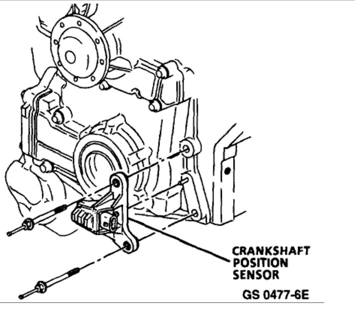

Engine turns over sparks plugs are not receiving fire.
Aug 13, 2017 at 11:45 AM
  • 55,433 POSTS

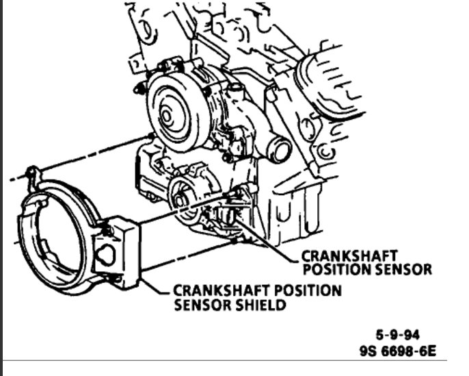

This sounds like you have a crankshaft angle sensor that is out. Here is a guide that will show you what you are in for when changing it out. This sensor will not create a code when it goes out.
Here are some diagrams that will help you see what it will be like on your car.
