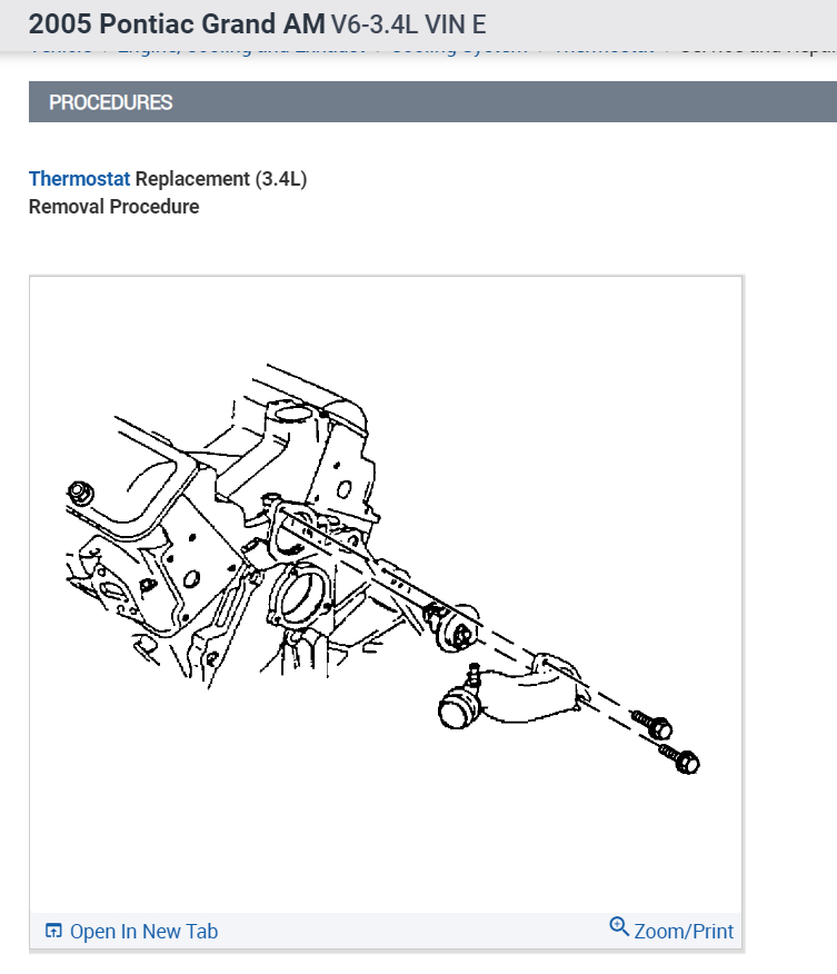

I changed the thermostat no visible leaks. Filled with new coolant now overflow is low and has dirty looking coolant in it. Have no heat either. Could it be a bad freeze plug? How many plugs does it have and how can I tell if 1 is bad??

I have replaced the thermostat but not the gasket. Possibly got a bad thermostat??

It is possible you got a defective thermostat also if the thermostat has an air bleed hole it must be at the top. Also, you can start the engine and allow it to warm up with the radiator cap off. Do not allow it to get too hot, then shut the engine off and the heat soak should allow the coolant level to drop once the thermostat opens. Check out the images (below). Please let us know what happens.
