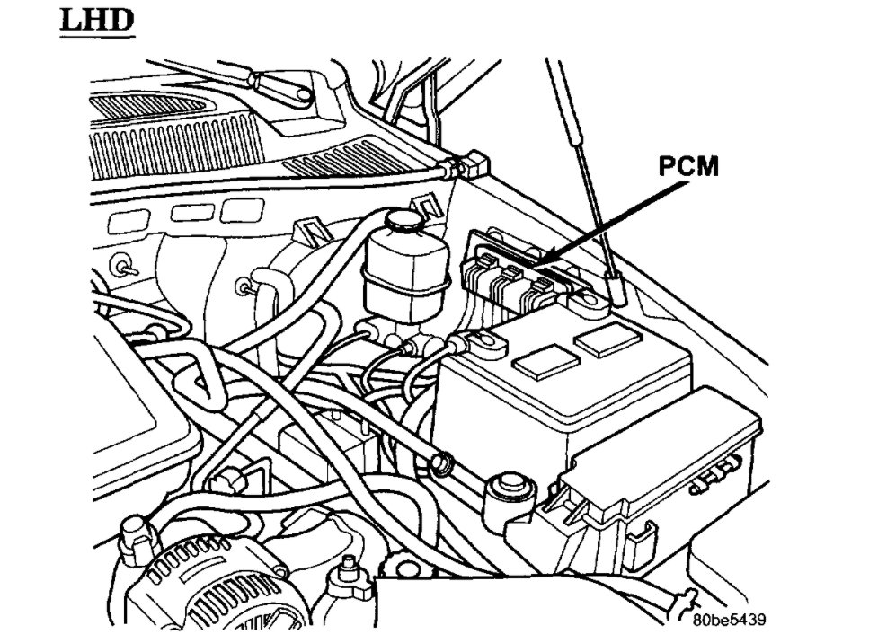

Pin 85 of the ASD relay is controlled by the ECM as in the diagram I sent you,
It also powers the other components that have no power.
From your readings, it looks like the ECM is the issue.
PROGRAMMING THE POWERTRAIN CONTROL MODULE
IMPORTANT NOTE: Before replacing the PCM for a failed driver, control circuit or ground circuit, be sure to check the related component/circuit integrity for failures not detected due to a double fault in the circuit. Most PCM driver/control circuit failures are caused by internal failure to components (i.E. Relay and solenoids) and short circuits (i.E. 12-volt pull-ups, drivers and ground sensors). These failures are difficult to detect when a double fault has occurred and only one DTC has set.
Note: if the pcm and the skim are replaced at the same time, program the vin into the pcm first. All vehicle keys will then need to be replaced and programmed to the new skim.

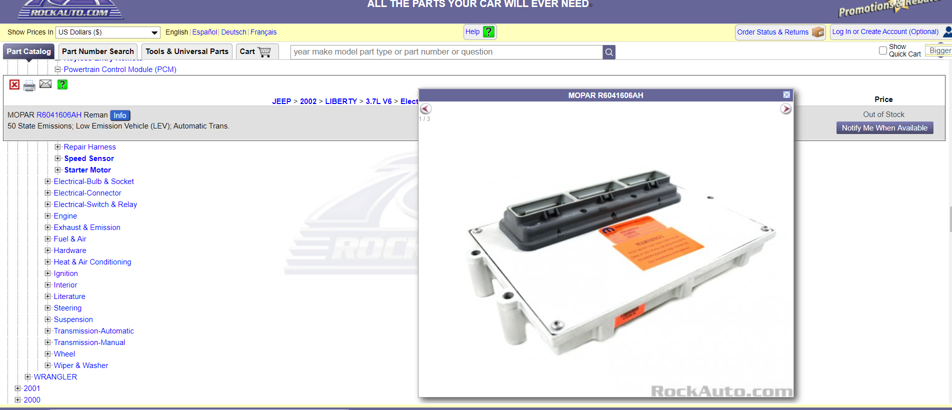

Any recommendation of PCM vendors? Did some looking last night. Major auto parts stores sold out or don't carry them.
Tuesday, November 3rd, 2020 AT 6:33 AM
  • 52,797 POSTS
I attached Rockauto for you. They say out of stock but if you call them, they can give you a estimate of when they will have it.

Okay, using jump wires I tested ASD relay plugged in and not plugged in. The relay is good, can here it clicking. Using a jump wire, when relay is plugged into fuse box, and key is turned to crank position, I get power at Pins 30, 87 and and 86. But not 85. 85 doesn’t get power in any situation, except when I take the relay out of the fuse box and wire the relay directing to 12V source with a toggle switch. So, I assume the conclusion is that the PCM is bad and should be replaced?
Saturday, November 7th, 2020 AT 10:59 AM
  • 52,797 POSTS
85 is powered by 86 and becomes a ground in the ECM.
Yes, I agree the ECM is the issue.
