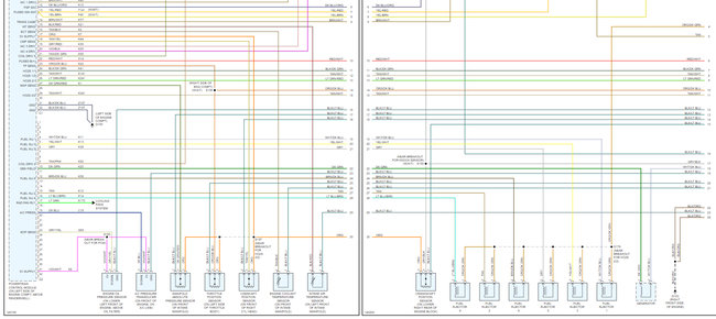

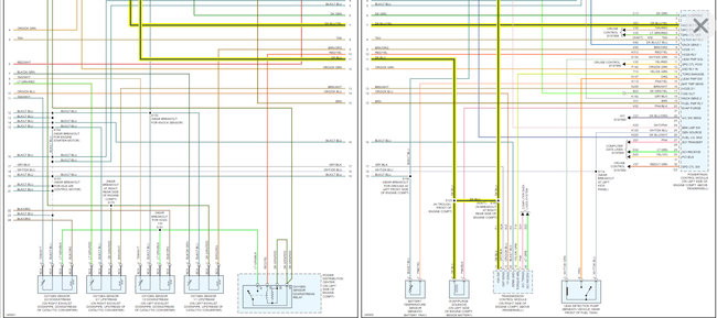

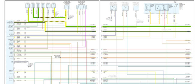

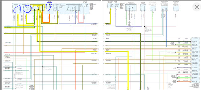

Okay, I attached the wiring diagram of the system for you.

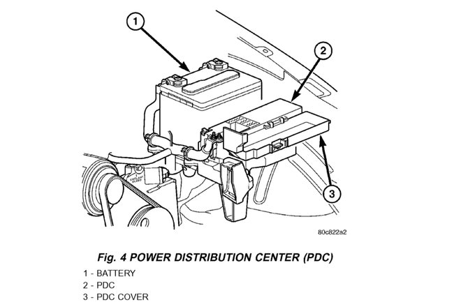

Check the fuses I circled as they are feeding the ASD relay. That is the relay that provides power to all the ignition components.
REMOVAL
The ASD relay is located in the Power Distribution Center (PDC). Refer to label on PDC cover for relay location.
1. Remove PDC cover.
2. Remove relay from PDC.
3. Check condition of relay terminals and PDC connector terminals for damage or corrosion. Repair if necessary before installing relay.
4. Check for pin height (pin height should be the same for all terminals within the PDC connector). Repair if necessary before installing relay.

I only see 3 fuses circled. is that correct?
Oct 26, 2020 at 2:23 AM
That is correct.
Verify power on both sides of the fuses with the key on.

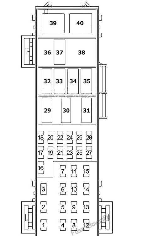

Confused.. it looks as though the fuses circled are 16, 26 and 6? (not clear).. the schematic I downloaded for the PDC layout says 16 is open, 26 is injectors and 6 is the ASD fuse. my concern is that 16 is open (no fuse) according to my download.

Okay, on the same web page, the PDC diagram for the optional diesel engine says 16 is an ASD Feed fuse. sounds like the diagrams may have been mis-labeled.

Okay. Here's how things went with the fuse/relay check with key on:
Fuses: #24 Fuel Pump fuse...getting power (But I have no power at the fuel pump)
#26 Injectors. no power (note that the Starter Relay Fuse did not have power either, but the starter still works when key turned all the way)
#16 ASD Feed. no power.
Relays:
ASD has power to pins 30 & 86.
Fuel Pump Relay power to pins 30 & 86.
I also bought a new relay and put it in, but didn't help.
I also checked the clear-top weird looking fuses that dealt with ASD or ignition.
#8 Ignition/start. power.
#6 ASD. power.
#13 Ignition/windows. power.
#14 Ignition/switch. power.
Relays:
#6 ASD. power.
Nov 1, 2020 at 11:35 PM

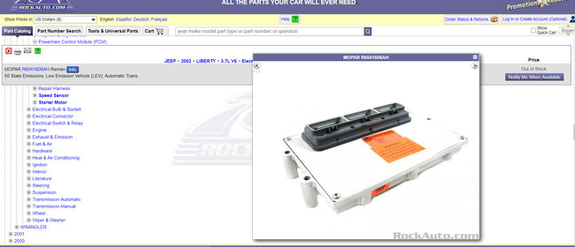

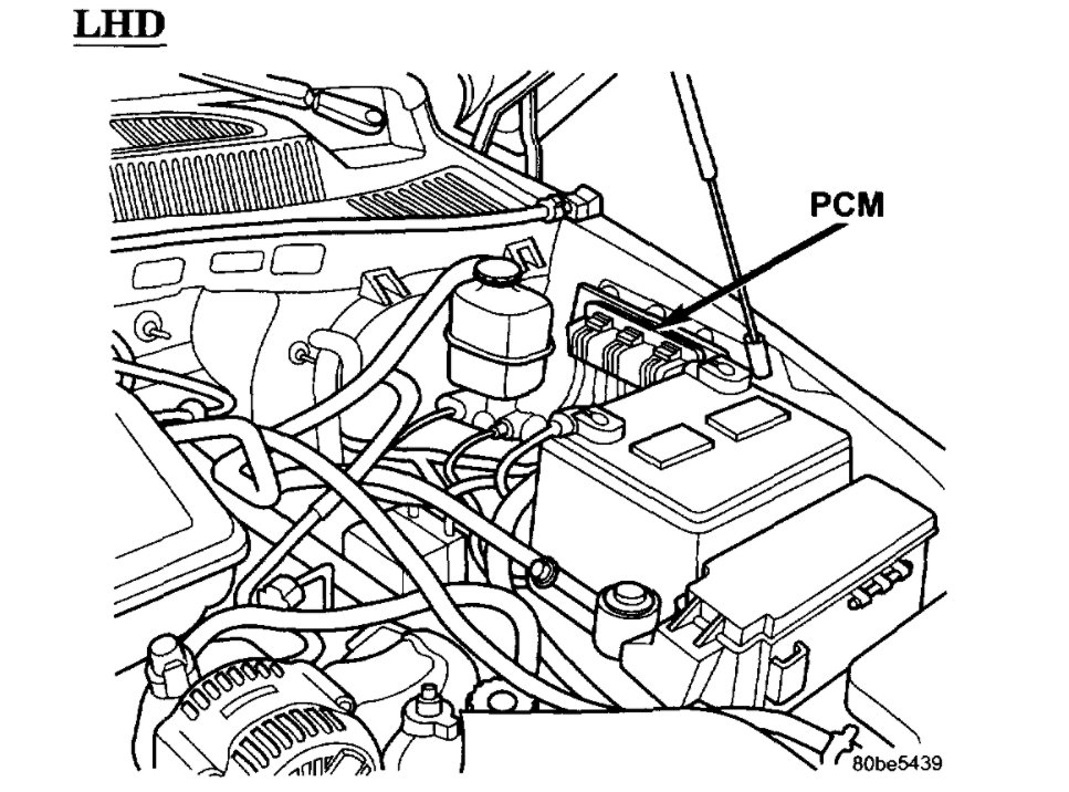

Pin 85 of the ASD relay is controlled by the ECM as in the diagram I sent you,
It also powers the other components that have no power.
From your readings, it looks like the ECM is the issue.

Nov 2, 2020 at 1:07 AM
I was afraid that was the issue. I appreciate your patience and help. I'll order a replacement and hopefully get it in this weekend.. again thanks.

Any recommendation of PCM vendors? Did some looking last night.. Major auto parts stores sold out or don't carry them..
