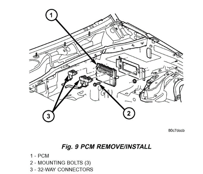

If it sputtered, yes, it may have some spark. The ECM does control the operation of the injectors based on the input from the crankshaft position sensor. Once the ECM see a RPM reading, it will command the injectors to fire off.
https://www.2carpros.com/articles/how-a-crank-shaft-angle-sensor-works
When you crank the engine, does the tach move up a little showing RPM?
I do not see any indication of the ECM at this time.
Do you have a scan tool that can read live data?

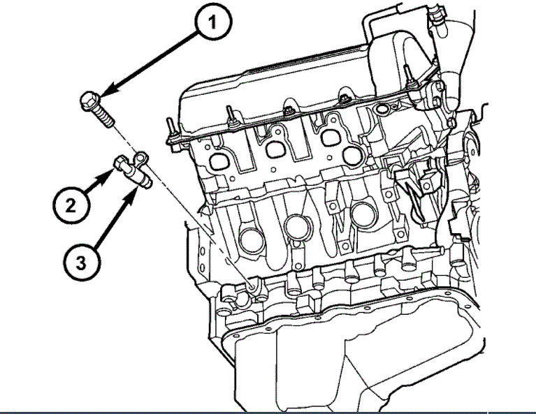

The Crankshaft Position (CKP) sensor is mounted into the right rear side of the cylinder block. It is positioned and bolted into a machined hole.
1. Raise vehicle.
2. Disconnect sensor electrical connector.
3. Remove sensor mounting bolt.
4. Carefully remove sensor from cylinder block in a rocking and twisting action.
5. Check condition of sensor O-ring.
INSTALLATION
1. Clean out machined hole in engine block.
2. Apply a small amount of engine oil to sensor O-ring.
3. Install sensor into engine block with a slight rocking and twisting action.
CAUTION: Before tightening sensor mounting bolt, be sure sensor is completely flush to cylinder block. If sensor is not flush, damage to sensor mounting tang may result.
4. Install mounting bolt and tighten to 28 Nm (21 ft. lbs.) torque.
5. Connect electrical connector to sensor.
6. Lower vehicle.
ECM
The PCM is located in the engine compartment near the battery.
To avoid possible voltage spike damage to the PCM, ignition key must be OFF and negative battery cable must be disconnected before unplugging PCM connectors.
1. Disconnect negative battery cable at battery.
2. Remove cover over electrical connectors. Cover snaps onto PCM.
3. Carefully unplug the three 32-way connectors from PCM.
4. Remove three PCM mounting bolts and remove PCM from vehicle.
INSTALLATION
Use the DRB scan tool to reprogram the new powertrain control module (PCM) with the vehicles original identification number (vin) and the vehicles original mileage. If this step is not done, a diagnostic trouble code (DTC) may be set.
1. Install PCM and 3 mounting bolts to vehicle.
2. Tighten bolts. Refer to torque specifications.
3. Check pin connectors in the PCM and the three 32-way connectors for corrosion or damage. Also, the pin heights in connectors should all be same. Repair as necessary before installing connectors.
4. Install three 32-way connectors.
5. Install cover over electrical connectors. Cover snaps onto PCM.
6. Install battery cable
7. Use the DRB scan tool to reprogram new PCM with vehicles original Identification Number (VIN) and original vehicle mileage

Compression 152. fuel pressure 50psi.. I will check at lunch to see if there is a RPM reading while cranking.. I do not have a scan tool. .So the ECM and PCM are the same unit (computer)?
Oct 12, 2020 at 1:45 AM
Yes, that is correct. they call it many different things but in the end it is the engine control module.

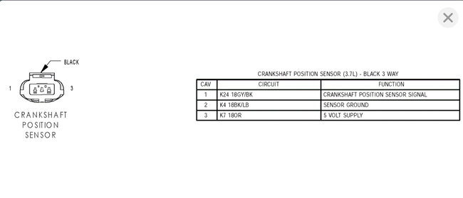

I attached a picture of the connector for the crank sensor.
Check terminals 1 and 3 for 5 volts with the key on. Those 2 signals come from the ECM.
Oct 12, 2020 at 4:25 AM
MIKE QUALLS
  • 55 POSTS
will do when I get home at 5.. what would be the next step if I get 5 volts. when checking do I put voltmeter positive (red) on 1 and negative (black) on 3 or positive on 1 and neg to frame, then positive to 3 and negative to frame?
Oct 12, 2020 at 4:34 AM
Red lead into 1 and black to good body ground.
Red lead to 3 and black to a good body ground.
Then red lead to 1 black lead to 2.
Red lead to 3 and black lead to 2.
Oct 12, 2020 at 4:42 AM

Okay, I couldn't get to the crankshaft sensor because I've got to jack up the jeep, but I checked the camshaft sensor at the front of the block and it read 4.35 volts on pins 1 and 3, grounded to Pin 2 and then to the chassis. It'll be Thursday evening before I can check the crankshaft sensor.....

Actually got a chance to check the crankshaft sensor yesterday. both the crankshaft and camshaft sensors are getting 4.35 volts each with ignition key on.
Oct 13, 2020 at 11:55 PM
You checked it exactly as I suggested? You have 2 powers? Did you check using the body ground as well as the ground for the harness?
Oct 13, 2020 at 11:58 PM
MIKE QUALLS
  • 55 POSTS
Yes, on both sensors.

Okay, attempted to remove the crankshaft sensor, wouldn't budge, so I soaked it down with penetrating oil overnight, still would not budge, started tapping it, still no budge, then tapped harder and head broke off.. I Googled the situation and seems it's common for them to be seized in by rust. some recommend chipping it out piece by piece.. what do you recommend? By the way the camshaft sensor came out very easily....
Oct 19, 2020 at 12:43 AM
Okay, why did you replace the cam sensor? We or I did not recommend that.
Yes, you will need to chip it out. Once you get down to the seal, it will free up and come out.
