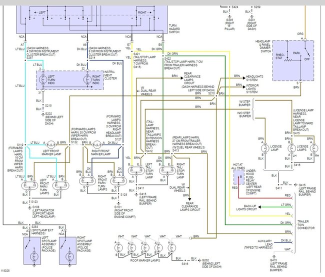

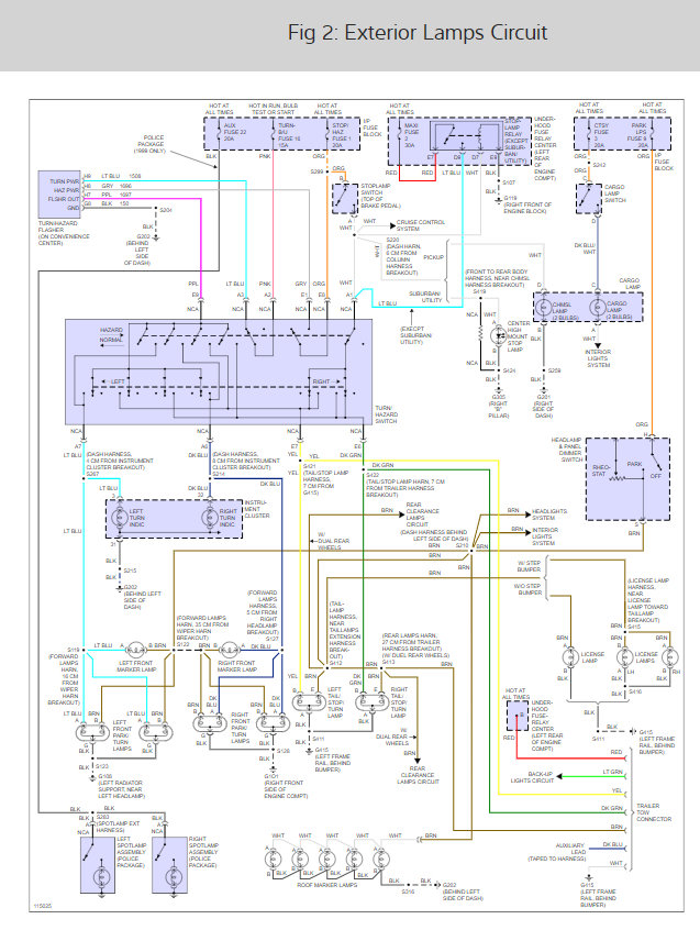

I have no brakes lights at all, my lights work but when i step on the brakes i get nothing. I changed the switch on the pedal and checked the fuses what else good be the problem? There is no relay under the hood.
check both fuses under the dash and under the hood both good but still replaced the bulbs are good but still replaced, replaced the brake light switch and still no brake lights,
the tail lights, back up lights and directionals still work,
also no cruise control and that fuse is good.

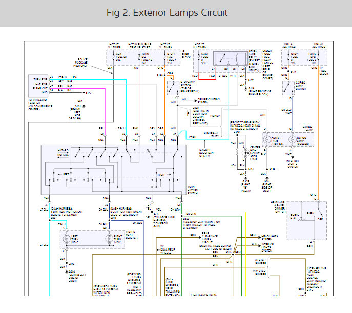

Hey,
It could be the turn signal switch, but before you go testing the wiring and connections, try cycling the emergency flashers. What happens is the switch connection get corroded and stop working, when you move the switch it cleans the contacts.
If that doesn't work here are some wiring diagrams and guide to help you get the problem fixed.
https://www.2carpros.com/articles/brake-lights-not-working
and
Please run some tests and get back to us so we can continue helping you and check the blinker wiring diagrams so you can see how the system works.

My brake lights went out on my truck. I checked the boards, bulbs, fuses, and replaced the brake light switch, and still no working brake lights. The running lights, hazards, and turn signals works.
My father ran a continuity test, and could not get power to the fuse box in the cab. I looked under the hood, and there is no stop lamp relay.
Is this a ground issue? If so, where is the ground located?
Any help is greatly appreciated!
Jul 27, 2020 at 3:29 AM (Merged)
HMAC300
  • 48,601 POSTS
the ground will be located on the lh side at rear of frame. check to make sure all the pugs are connected at back of frame on lh side as well. if th eturn signals work then it may be the multifunction switch or maybe the trailer connector. check the dark green and yellow wires from multi function switch while applying brake.

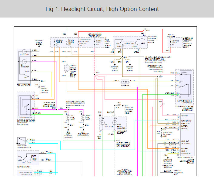

Also my taillights just have head lights. When headlight switch is off tail lights work. Put a new headlight switch, brakes switch is good, put all new bulbs.

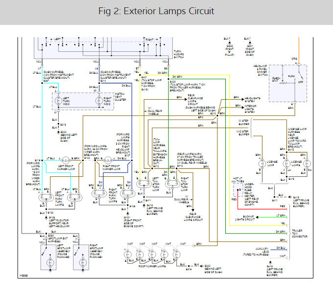

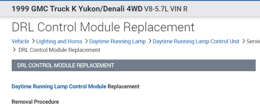

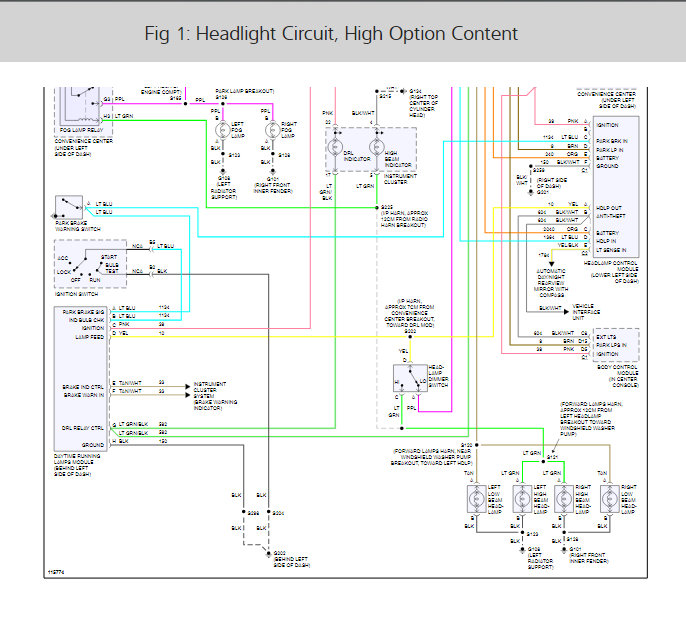

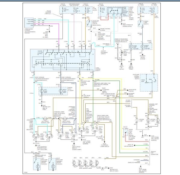

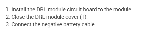

SCGRANTURISMO
  • 4,897 POSTS

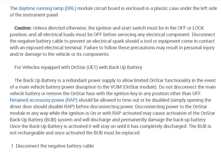

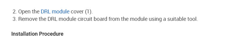

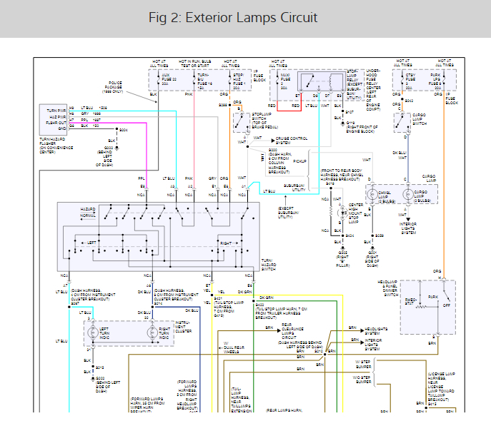

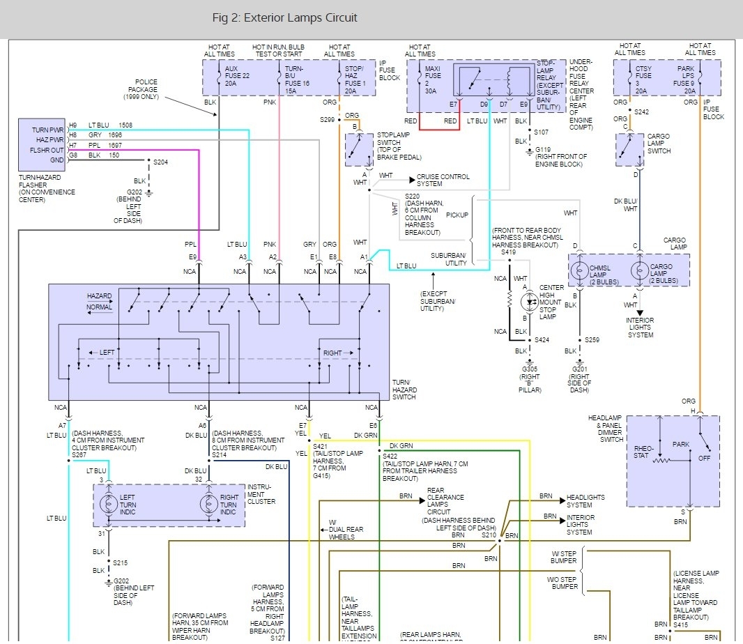

The Daytime Running Lamps Module is probably bad in your vehicle. In the diagrams down below I have included a wiring diagram of the exterior lighting circuits for you vehicle as well as the headlights wiring diagram. As you can see the Daytime Running Lamps Module not only controls the headlights but has outputs to the tail/brake lights as well. I have also included instructions for the removal and installation of the DRL Module in the diagrams down below for you as well. Please go through these guides and get back to us with what you are able to find out.

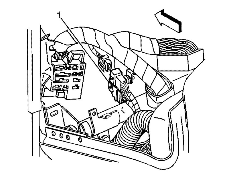

RUSTY PHILLIPS

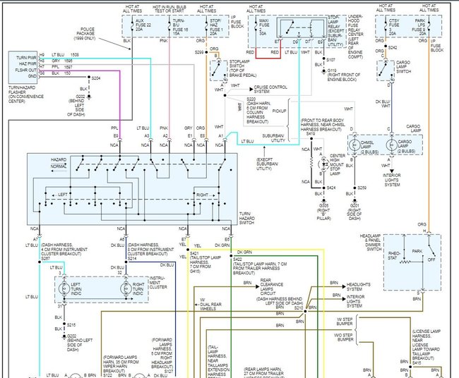

My brake lights have stopped working. All other functions work, running lights, turn signals, just no brake lights. Therefore I am assuming there must be a switch under the dash that the brake pedal depresses that has gone bad. All advice is appreciated.

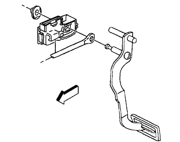

Good evening,
Yes, there is a switch on the brake pedal under the dash. I attached the procedure and the picture for you to view.
Also, check the fuse listed in the diagrams I sent you for power on both sides.
1. Disconnect the negative battery cable.
2. Disable the SIR.
3. Remove the pushrod retainer from the brake pedal pin. Use snap ring pliers.
4. Unsnap the stoplamp switch from the pushrod.
5. Disconnect the electrical connector from the stoplamp switch.

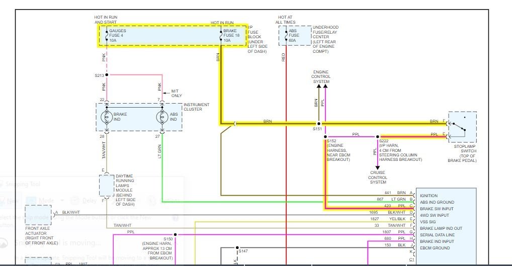

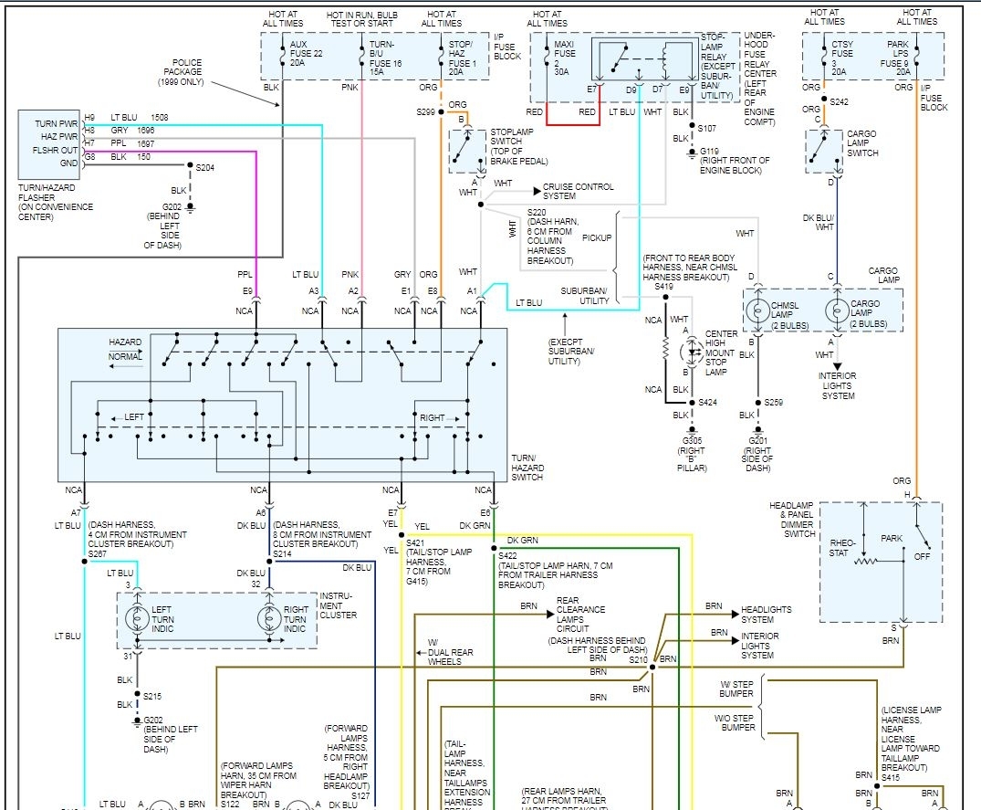

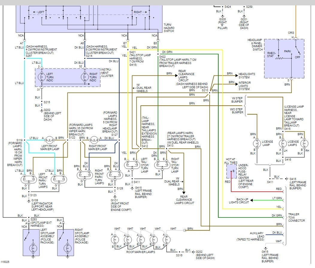

Good afternoon,
Check for power to the stop light switch. I attached a diagram for you to view. Let us verify we have power through the switch.
Jul 27, 2020 at 3:30 AM (Merged)
Here is a guide for checking a fuse. You need a test light or voltmeter to test the brown wire to the switch.

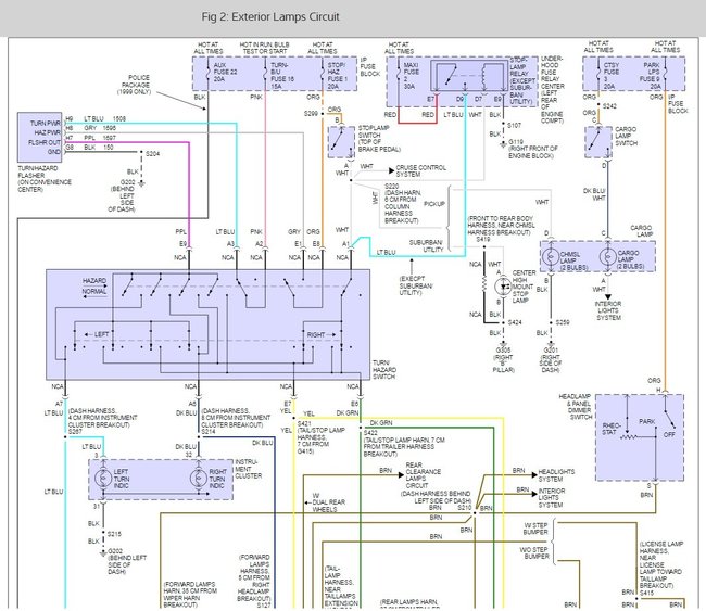

BLACKOP555
  • 10,386 POSTS
first thing ill ask does the third high rise brake light work? if not chances are the brake switch is bad or misadjusted.
if the lights on then the turn signal switch has failed and you need a new one.
Read this guide on using a test light, it will help

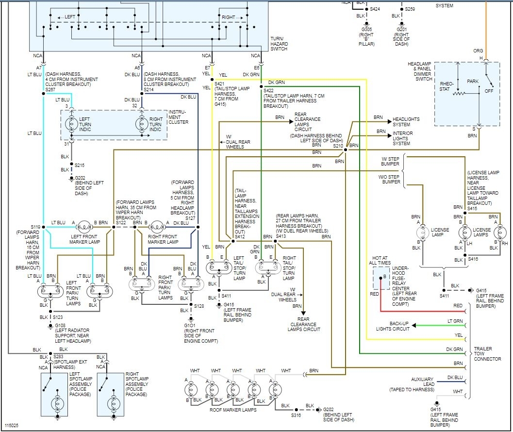

The wiring diagrams for your brake lights are attached below

  • 55,224 POSTS

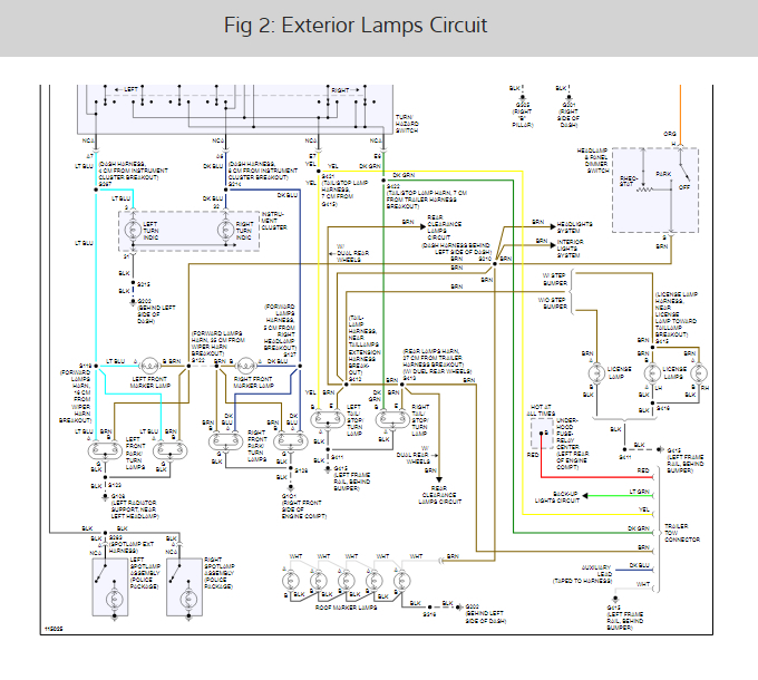

It sounds like you have a fuse out or the hazard/turn signal switch that is not working right. Here is a guide to help you see where you are loosing power:
Here are the wiring diagrams for the rear lights, please let me know if you need a larger version.

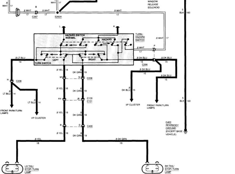

TONY WORTHAM
The right hand blinker and right hand brake light does not work I have changed the bulbs and the part that the bulbs fit into.
Jul 27, 2020 at 3:31 AM (Merged)
Good morning.
The power comes from the turn signal switch for the right rear brake and turn.
the first thing I would do is to check for power to the connector. use a test light or voltmeter to verify.
if you have no power then you need to go to the turn signal switch. check the dark green wire from the switch.

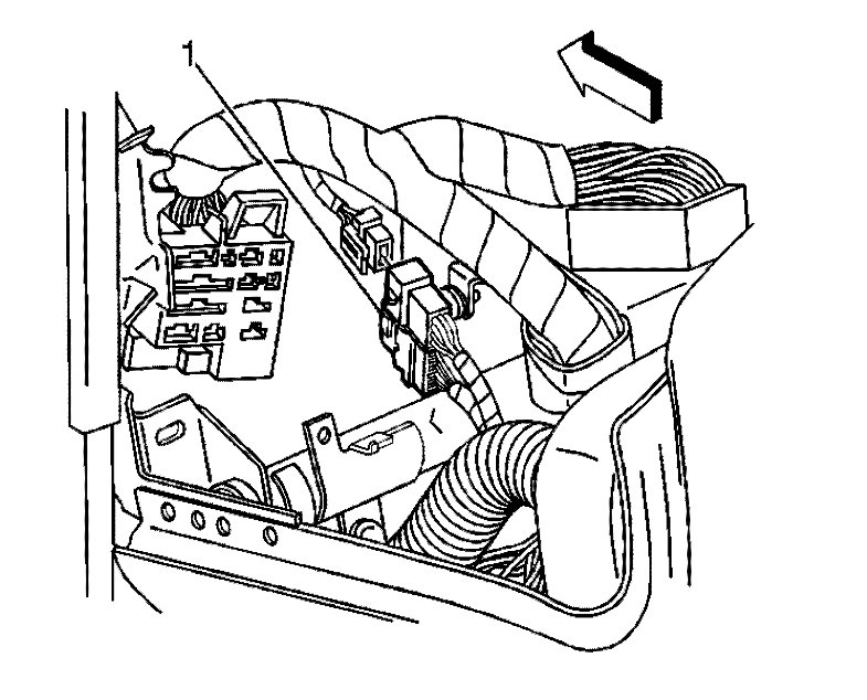

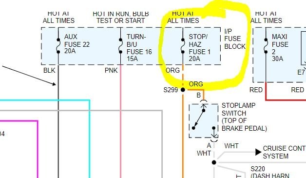

Hi all, wanted to chime in. I just had this issue on my 99 GMC Suburban, 5.7L 4x4.
I went through changing out the switch, tail light boards, bulbs, fuses, etc but did not fix the issue. Finally found a spot to test the voltage for the brake light switch. I was getting 0.7 volts when brake pedal depressed, reading the white wire (brake light control wire). Couldn't find a spot to easily read the voltage for the orange (constant 12v) wire, but could reasonably assume there was an issue with either the brake wire (white) or constant 12v (orange).
The brake light wire harness pigtail is an ~8" section that has another connection opposite the end that plugs into the brake light switch, which connects into the main wire harness for the vehicle under the dash. To access it (more easily), you have to remove the plastic knee cover on the lower dash(4 - 7mm bolts) and disconnect the panel vent (un-clips from the panel and then slides out of vent tubing), then remove the larger of the 2 metal brackets (4 - 10mm bolts). Once that plate is off, there is a large square connector that is bolted onto the console frame with one 7mm bolt. Remove that bolt and lift the connector up and off the bracket to give you more room to maneuver the pigtail out. From there you have to remove the adhesive that holds the pigtail to the frame (I used a long flathead and some pent up aggression to get it to break free), and snake the pigtail down to the front. Be careful to not damage the wires on the metal frame while doing so.
When i removed this and checked the wires, my 12v orange wire was damaged and corroded, I then replaced the pigtail with one I got from pick n pull (like 4$) and my lights worked as they should!
I have seen a bunch of posts saying check the white wire, or it gets pinched in the path up to the multi function switch, but if you have cruise control and function of your multi function (turn signals, hazards, etc) my money is on your wire harness pigtail to the brake switch itself.
When you replace the wire harness, make sure you put on a corrugated wire shield to avoid further damage to the cables.
I hope this helps someone else, as it has been a huge pain for me.
