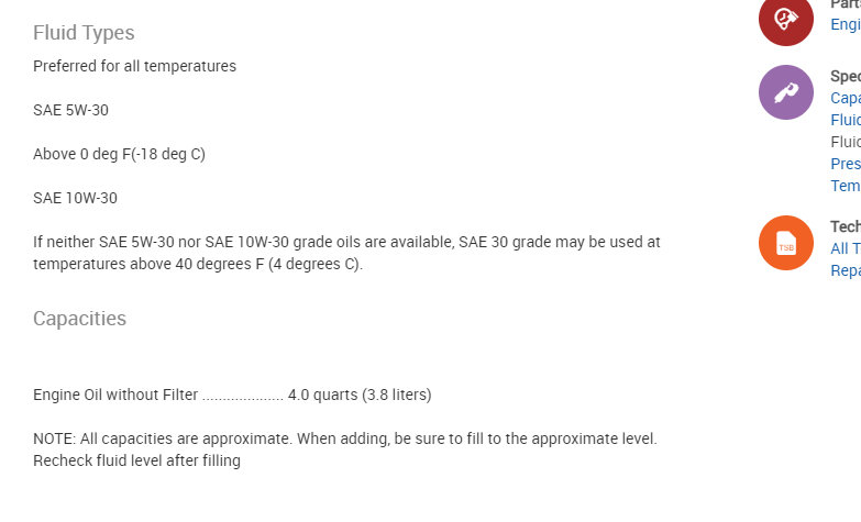

I have a GMC Sonoma 1991 4x2 4.3L, V6. I changed the engine few years ago, but "new" engine has 120000 miles already. Is working fine, I take good care of it. My question is: What kind of oil should I use in this high mileage engine? I have been using 10-40 all the time but wonder if I should change to another oil. Can I use synthetic or do you think it's not recomended in this old car? I live in Florida, hot weather. Thank you very much for your help.
Nov 22, 2009 at 3:09 AM
You don't need to do anything specific as the recommended oil will be fine.
https://www.2carpros.com/articles/how-to-change-engine-oil-and-filter
If you want to use synthetic, then that is fine. It will give a little better protection but the nice thing is it will last longer and so you can spread out the oil chances a little more.

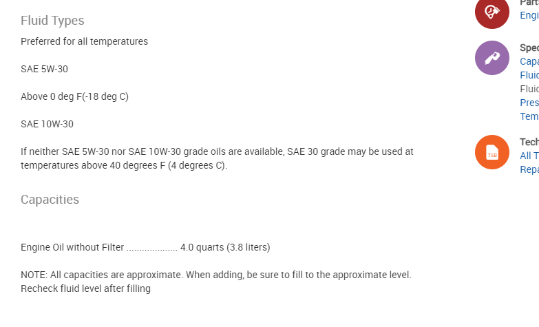

I am attaching the OEM spec below and if it were me, I would stick with this weight and if you want to use a high mileage additive then that will work as well.
