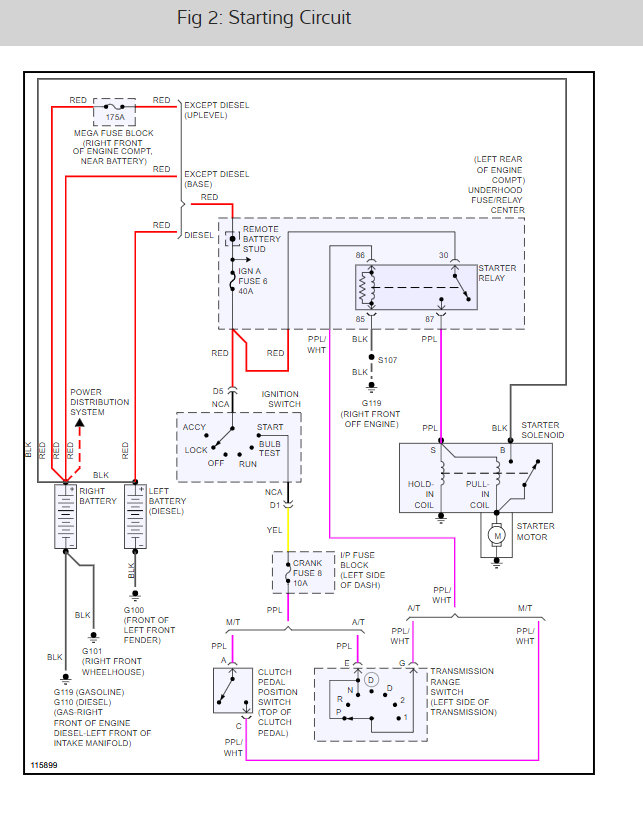

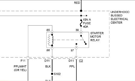

Welcome to the forum. Does the fuse blow as soon as you plug it in? Does it blow driving down the road? Voltage to load side of starter relay is hot all the time, voltage to coil side of relay comes from ignition switch, key in start position. Once the vehicle starts and the key returns to the run position, there should not be any voltage at coil side of relay.

As far as the starter run on, you can check circuits at starter relay, the coil side of relay should not be hot, with engine running only cranking. That fuse that keeps blowing serves many circuits, not just the starter relay. If you think it is a starter issue, isolate the starter circuit, see if the fuse still blows. You can pull starter relay, turn key to crank, see if fuse still blows? You can also, pull starter relay, use jumper wire, from battery B+ to terminal 87 in diagram, the starter should crank. Be sure to use inline fuse on jumper, not sure of size, try 20 amp fuse, see if it still blows. It would be nice to check amp draw on that circuit? Any testing, make sure the tranny is in park or neutral and the e-brake is set and functional.

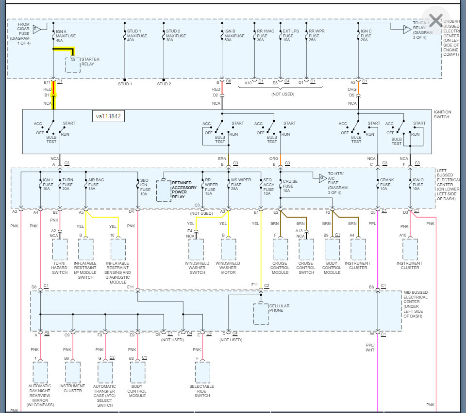

I believe the starter was the problem here is the complete wiring diagrams for the circuit so you can see how it works.
Sep 1, 2019 at 11:04 AM
This fuse runs two major components. The starter relays and in turn the starter.
Then the ignition switch. So, if you take a look at the wiring diagram below of the power flow for this circuit we need to find out if any of the other fuses like the ignition 1 or turn fuse are blowing.
If only the IGN A fuse is blowing and the starter, starter relay has been replaced and it is still blowing then the ignition switch is most likely shorted causing a direct path to ground and it blows the fuse.
Basically, we just need to remove the fuse and check for a short to ground.
If it is there, then disconnect the switch and see if it goes away or to an open circuit.
If it does, then I would replace the switch because the issue is between the fuse and additional fuses and this switch is the only thing there.
Please run through this and let me know what you find. Thanks
