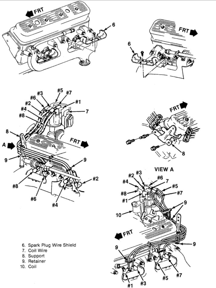

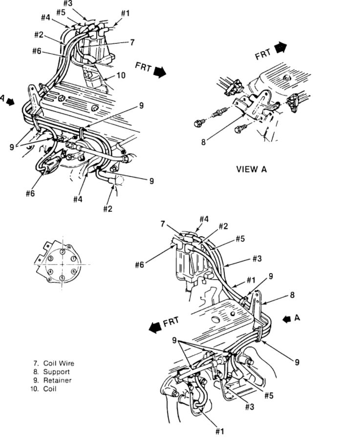

I just changed the cap, rotor, plugs and wires and can't get it to fire, i'm looking for the diagram for the firing order?

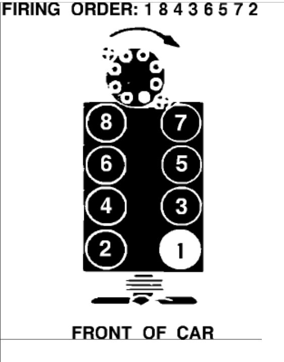

i need the firing order for my truck it has a 5.0 vortec engine

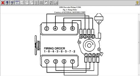

Firing order 1-8-4-3-6-5-7-2
--------------- | 2 4 6 8 1 3 5 7 | --------------- Distributor rotates clockwise .

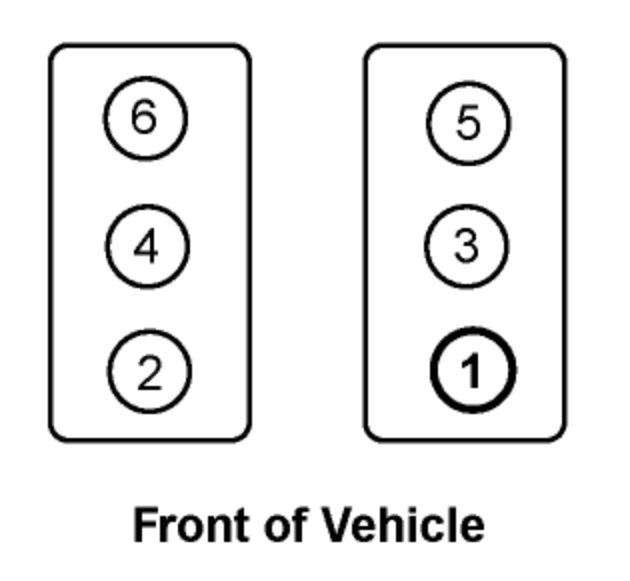

The firing order is V8 18436572 here is both the v6 and v8 engine (below).
v6 - Firing Order1-6-5-4-3-2

The firing order is 1 8 4 3 6 5 7 2 driverside head 1357 passenger 2468
get #1 cylinder up on compression stroke and see where the rotor is pointing this will be the start of your firing order goes clockwise
