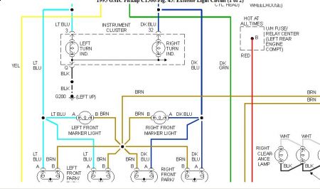

It actually contnued to do that even after I aded another ground cable ( slightly larger than the positive) in addition to the two factory grounds. I just can't for the life of me fiqure out why it all works good now. Except for the flashers that I mentioned earlier ( and that may be a bulbor flasher) I really appreciate your responses, I'm still trying to figur it out, since I dont know why it all started to work again, I cant trust it.

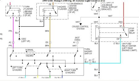

If the flashers don't work on either side, it has to be a fuse, the flasher or the switch. In that order. Do the hazzards work?
https://www.2carpros.com/forum/automotive_pictures/248092_95_Siera_lights_1.jpg
https://www.2carpros.com/forum/automotive_pictures/248092_95_Siera_lights_2_1.jpg
I split the diagram in 1/2 so it would be easier to read.

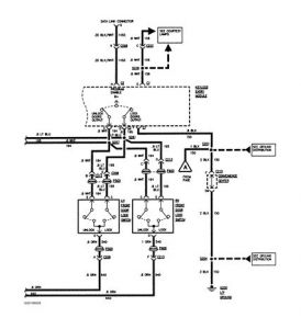

I want to thank you for all the information and all the fast responses. I do have one last question about this truck. Is there a way to find out what harness this truck should have for keyless entry. I am refering to what I am told is the acc. Harness, the one(s) that run behind the dash. For example, the turn, dimmer, washer hrness is 6314 and the ignition harness is 6311. Thanks again, Tony
Thursday, April 16th, 2009 AT 11:31 AM
JAMES W.
  • 2,394 POSTS

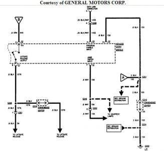

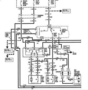

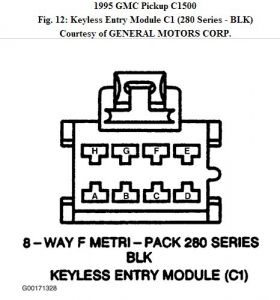

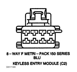

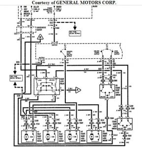

Tony, sorry to say, my system doesn't have this information on wire harness #'s. I can give you wire colors and terminal #'s, but not for the harness. You can probably get that info. from the dealer. I'm assuming your truck doesn't have an keyless system, and you want to install a factory system. I'll see what I can pull up on a factory keyless
https://www.2carpros.com/forum/automotive_pictures/248092_95_GMC_keyless_1_1.jpg
https://www.2carpros.com/forum/automotive_pictures/248092_95_GMC_keyless_2_1.jpg
https://www.2carpros.com/forum/automotive_pictures/248092_95_GMC_keyless_3_1.jpg
https://www.2carpros.com/forum/automotive_pictures/248092_95_GMC_keyless_4_1.jpg
https://www.2carpros.com/forum/automotive_pictures/248092_95_GMC_keyless_5_1.jpg
https://www.2carpros.com/forum/automotive_pictures/248092_95_GMC_keyless_6_1.jpg
. If I find anything, I'll post it here.
