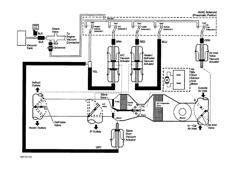

I am having a problem with my heater which has an automatic temp control and it isn't really working. It either blows really hot air or none at all. The air conditioner doesn't work now, either. Chevy garage said it is the automatic temp control auctuator or something else. He wants over $1,000.00 to fix it. I can't afford that, so has anyone else had this same problem and know for sure what is wrong? One person said it is probably the blending door. If it is one of these, how do you know where they are and what do they look like? Please help! Thanks in advance, brasshorse
Friday, February 5th, 2021 AT 10:49 AM (Merged)
DEWEYG
Blending door is behind glove box(small release top left, bend down spring loaded tab then lower glove box.) Door is on right. Plastic gear can sometimes break. Can epoxy or replace or could be vacuum line has leak. Check vacuum first by disconnecting line and turn your climate knob from cold to hot(or vise versa) if you feel vacuum on your thumb then probably your gear

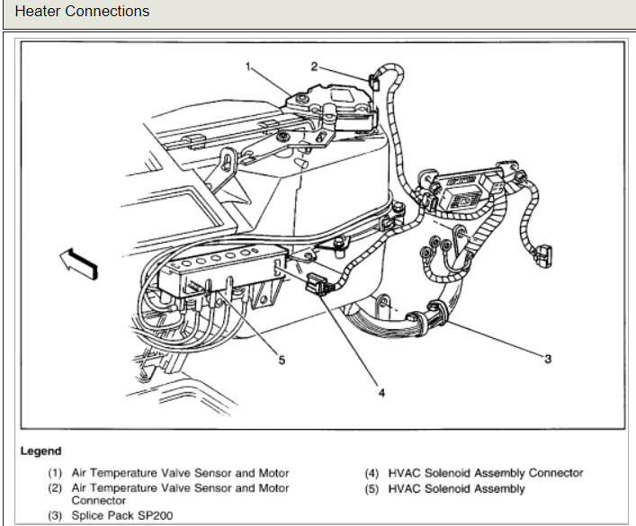

Im only getting high heat out of car vents no matter what I select on climate control selector. A/C works but its just not blowing cold air into vehicle. On heat selection, I cannot control heat either. Could it be blend-door broken or stuck in heat mode, or the blend-door motor failed, or climate control selector failed?

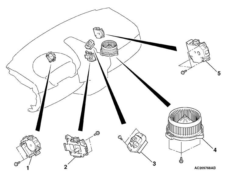

  • 75,992 POSTS
This sounds like the temperature door actuator is not working. I would remove the actuator and try moving the pivot for the door by hand here is a guide to help you see what I am talking about.
Here is the location on your car.
Cheers
