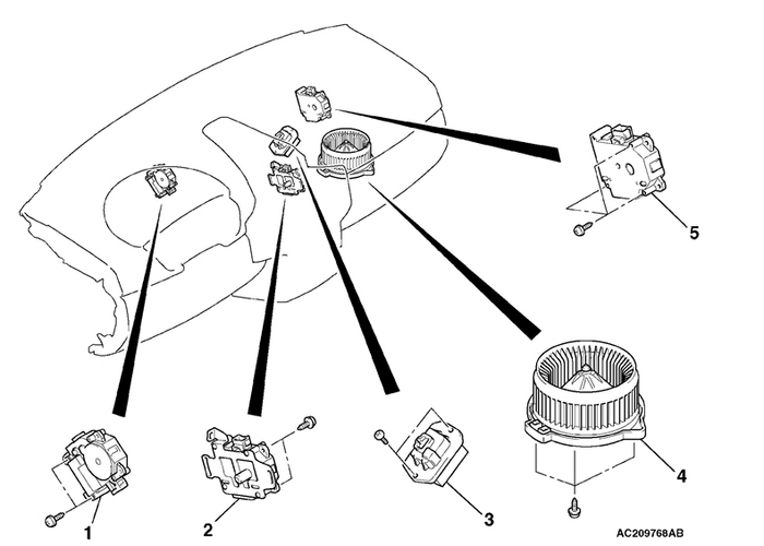

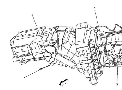

It sounds like the temperature blend door actuator is not working but to be sure this guide can help https://www.2carpros.com/articles/car-heater-not-working check the heater actuators they may be stuck it will be similar to the pictures i'm sending. they are listed as #1 & 2 they move to switch the air in theheater box. They may have vacuum hoses going to them as the picture i'm sending is electric...
https://images.2carpros.com/forum/automotive_pictures/406719_actuator_6.jpg

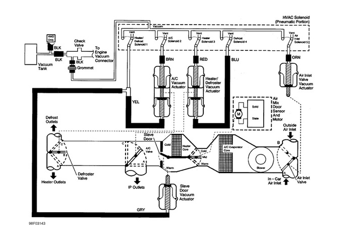

The heater produces heat and the blower works on all speeds. No heat flow is going to the floor when the control is in the floor or blend position for floor and defrost. Instead flow is defaulted to the dash vents only. The defrost only position works. I have visually inspected the control switch and vacuum tubes in the dash. They appear in good shape. Is this a common problem? What is the best (easiest if possible) way to diagnose what is going on?
Feb 5, 2021 at 2:47 AM (Merged)
HMAC300
  • 48,601 POSTS
if you feel under the dash there shold be a vacuum motor that does the moving to blend or defrost.etc, see if that is getting vacuum and if not go back to the contro l head and unplug it to see if it is. it may be leaking at the control head or the manifold wher eit picks up the vacuum on theengine.

Vacuum leak to the control head for the heater. Look for a line that goes through the firewall and follow it to the engine. Cracks or loose connections could be leaking.

my heater won't change from vent to floor to defrost. so i looked at the vacume lines and they have oil in them. Could it be that the vacuum actuator switch on the transfer case is no good, assuming that where all my vacuem connect to???
Feb 5, 2021 at 2:48 AM (Merged)
no, the vacuum connects to the motor. do you have vacuum to the control head?

blending door is behind glove box(small release top left, bend down spring loaded tab then lower glove box.) door is on right. plastic gear can sometimes break. can epoxy or replace or could be vacuum line has leak. check vacuum first by disconnecting line and turn your climate knob from cold to hot(or vise versa) if you feel vacuum on your thumb then probably your gear

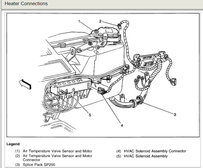

This sounds like the temperature door actuator is not working. I would remove the actuator and try moving the pivot for the door by hand here is a guide to help you see what I am talking about.
Here is the location on your car.
