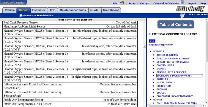

Where are the location of the four oxygen sensors?
Oct 3, 2020 at 6:25 AM (Merged)
  • 75,992 POSTS
Here is a guide to help you change out the oxygen sensor and the location of the sensors are below in the diagram.

PEARCE0947
Who many o2 sensor's are on my truck and where are they?
Thanks,
KENSIT1
There are three o2 sensor. Two in front of the catalytic converter and one past it. I believe driver side is bank 1 and passenger side is bank 2.

WHITEBLOSSOM2147
How many oxygen sensors are on my Jimmy and where are they? I have had 3 people look at it, and no one can find them..... and most people say I have 2 sensors, other say I have 3 or even 4? Help!
Oct 3, 2020 at 6:31 AM (Merged)
HANK49
I have the same Jimmy it only has one. It is by the passengers door just under floor on the exhaust pipe.

TDSTEEN
I have a 1995 GMC Jimmy with 120,000 miles, 4.3L. The check engine light indicates trouble with the oxygen sensor. Online parts dealers show sensors in front and behind the catalytic convertor.
How many sensors are there? Should the all be replaced? Can anyone tell me how to do it? Thanks, Tom
MERLIN2021
  • 17,250 POSTS
Probably 3 unless you have true duel exhaust, then it's 4, they make a special socket for the job, just don't use any grease in the connector! On a 1995 vintage you may need a tourch to remove the old one! And you might get lucky...
