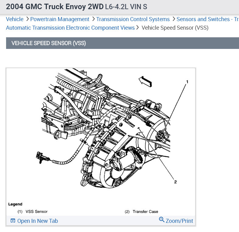

Envoy speedometer not working
CTFAMILLER
2004 Envoy speedometer on 60,000 mile vehicle
Odometer works sometimes but at other times it is all over the place - may show 100MPH
not predictable
Oct 23, 2007 at 3:31 AM
  • 75,988 POSTS
It sounds like the vehicle speed sensor has gone out here is the location. Check out the diagrams (Below). Please let us know if you need anything else to get the problem fixed.

Inspect and test the vehicle speed sensor located left rear of transfer case
https://images.2carpros.com/forum/automotive_pictures/12900_vss_18.jpg
