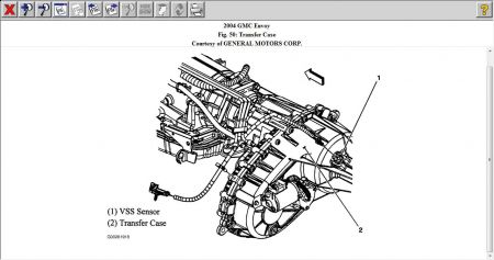

2004 Envoy speedometer on 60,000 mile vehicle
Odometer works sometimes but at other times it is all over the place - may show 100MPH
not predictable
Oct 23, 2007 at 3:31 AM
  • 75,992 POSTS
It sounds like the vehicle speed sensor has gone out here is the location. Check out the diagrams (Below). Please let us know if you need anything else to get the problem fixed.

Thanks for this post I had this problem and had to get a new sensor cost me $67.00 all fixed! I love this site

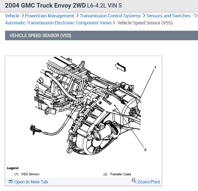

JTHURMAN89
My speedometer is not working properly. Sometimes i can be speeding and it will be on about 20 mph. Sometimes it won't go up at all, just sit on 0.
Feb 27, 2019 at 5:32 AM (Merged)
  • 75,992 POSTS
Inspect and test the vehicle speed sensor located left rear of transfer case
https://images.2carpros.com/forum/automotive_pictures/12900_vss_18.jpg
