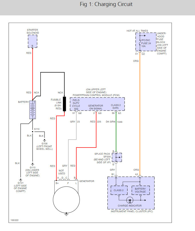

Battery was not charging and we were told we needed a new alternator too. Had both replaced. When driving and accelerating, the lights dim and the battery gauge drops, some times the "battery not charging" message appears. When we ease up on the accelerator the gauge goes back up and the lights get brighter. We had the battery and alternator both tested and were said to be good. What should we look for now? Any ideas?

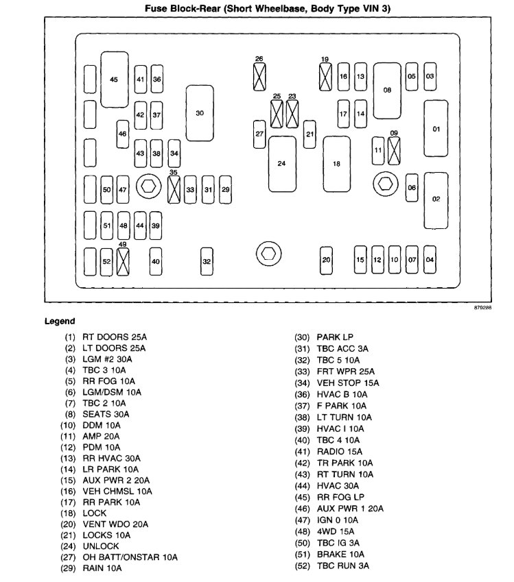

Was the charging system checked, on the vehicle? It is possible that the alternator is fine, but, could have issue with wiring circuit to or from alternator. There is a fuse #24 that needs to be checked for power here is a guide to help and the wiring diagrams so you can see how the system works.

Use a digital multimeter across battery post when problem is ongoing. Check for applicable trouble codes. Check the wiring circuits for the charging system. This guide will help
Please go over this guide and get back to us.
