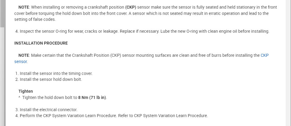

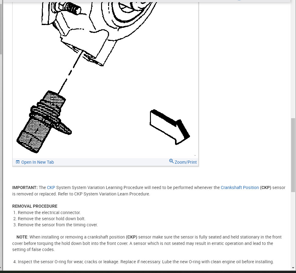

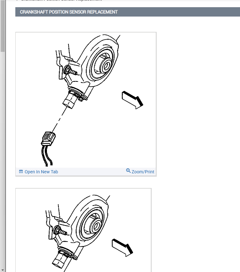

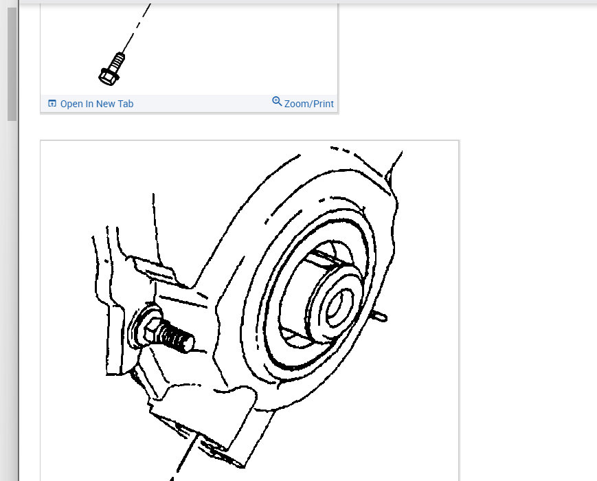

No spark is normally caused by a crank sensor issue. So, let's start with these guides and see what sounds like make sense. However, if it were me, I would replace the crank sensor and see if that gets the engine started.
I am attaching the info from the manual on how to replace this as well.
