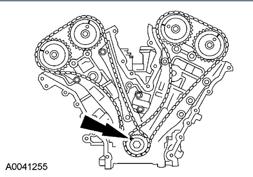

The long terms could be from either the engine running a little rich, possibly from an air filter, or the sensors are worn out.
the 705 is for the transmission range sensor not reading correctly. That would have nothing to do with the mileage issue.
Timing chains are the other thought. Have you ever had them replaced?

Oxygen sensors.
The timing chain controls valve timing. If the chains are worn, that timing will change and you will get less mileage.

no, not at all. They slack off and you cannot hear that at all.

You would need to do a compression test and compare the readings to new.
Then the cover for the chains should be removed to inspect. That is a big job and if you are going to go that far, then you might as well replace it.

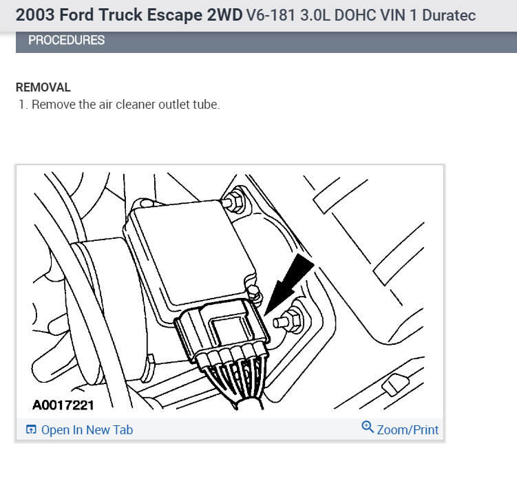

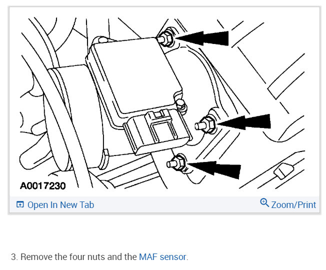

I have seen MAF cause this problem even though the numbers are kind of where they should be the sensor shows less air than what is entering the engine. I would replace it will new. here is a guide and diagrams below:
https://www.2carpros.com/articles/how-to-replace-a-mass-air-flow-sensor-maf

installed new maf sensor, also compression test was done "perfect numbers"
