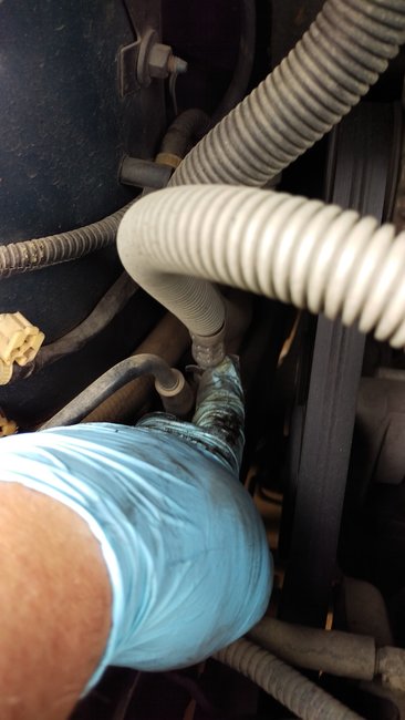

Some models did not have a test port you must tap in the fuel line itself.

I just worked on a 2000 3.3L engine today it didn't have a test port. See picture I attached where my finger is pointing. That's where you will have to tap in to do the fuel pressure test.
