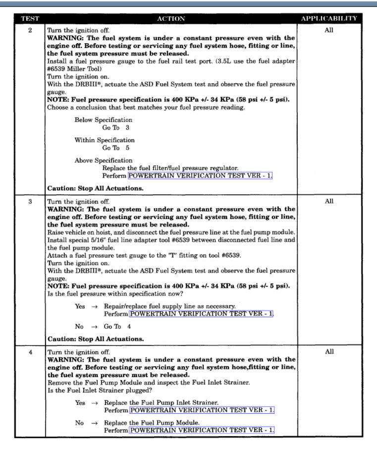

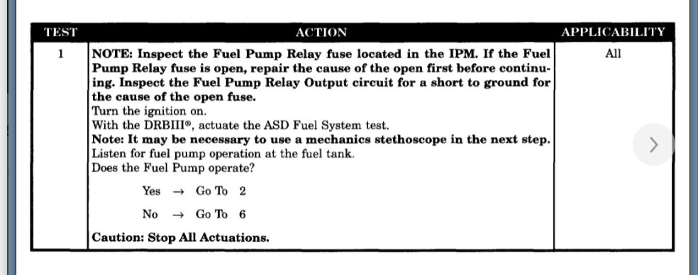

The 3.3L does not have a test port. This requires you to put a T in the line and put the gauge on the system this way.
Below you will find the process from the manual on how to do this test because it is not the easiest one due to not having the test port.
Please run through this info and let us know what questions you have. Thanks

Thank you very much for the information.
I have the original printed manual from Daimler Chrysler for the Dodge Grand Caravan 2002, 3.3 litre, V6. This manual does not breathe a word about the fuel pressure test port. None at all.
However, after I got your diagram, I put my hand behind the engine and felt a rectangular or square object near the rear intake manifold which appeared to be similar to the one shown in the diagram. Is it the protective cap for the test port? If so, is it to be removed by unscrewing it? I tried to unscrew it with my hand but I could not. Will a wrench be necessary? I do not want to break it.
Please advise. I await your response.

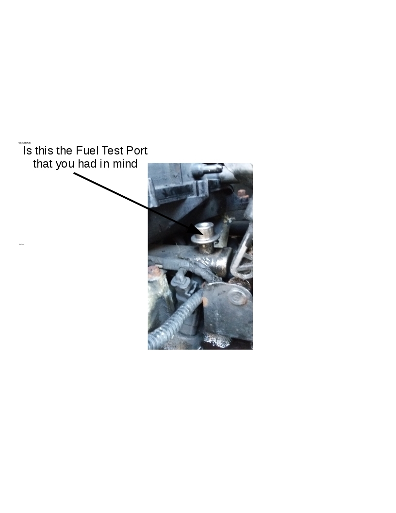

I found something that looked like the "Fuel Rail Test Port" that was shown in the last diagram that you sent me. I had to remove the power steering reservoir and it was behind it. It is rather strange that the designers of the vehicle made it so very difficult to obtain access to a simple test port! The design was as bad as the design of the fuel tank and filter where I had to remove the tank to replace the fuel filter which could have been, quite easily, kept in the engine compartment as was the case with other vehicles that I have owned.
However, the "Fuel Rail Test Port" has a peculiar cap on top of it. When I tried to unscrew this cap, it just kept on rotating and did not come off. On examination of the cap, it appeared to be secured to the port in a rather odd way which was quite unlike the usual threaded caps on Schrader valves. It had metal tabs below it which seemed to secure it to the test port.
Before I try to remove it using some other method and perhaps cause damage to the cap and the port, I would like your expert opinion on the best way to get it off.

I have checked and DOUBLE CHECKED for any object that looks like a test port on the fuel rail close to the induction coil which looks similar to the "Fuel Rail Test Port" shown on the last diagram that you sent me. There is NOTHING other than the object that I described to you in my last posting and it is located in EXACTLY the same location as the object that was shown to be the "Fuel Rail Test Port" in your diagram.
The object looks like a miniature top hat and it is attached to and covering a projection with an opening on the fuel rail. It appears to be some form of a dust cover. It is attached to the projection by about 4 tabs at the bottom of the hat. It appears possible to open the tabs and remove the hat like object. It is made of aluminium or other non-ferrous metal since a magnet does not get attracted to it. It is shiny metallic white in colour. It is smooth on the outside and has no knurling (to provide a grip) on it unlike the usual dust covers for Schrader valves.

Here is the image of what seems to be the "Fuel Pressure Test Port". You will notice that it is sitting on top of the Fuel Rail. I had to remove the Power Steering Fluid Reservoir to expose it to take a picture of it. You will notice that it is exactly as described by me in my previous message. Note that the top hat like cover is attached by clips to a projection on top of the fuel rail.
I feel that this has to be the fuel test port because there is nothing else on the vehicle that could be a fuel pressure test port.

No, I have never seen a test port look like that.

That is the fuel pressure regulator that you found which is on the fuel rail where the port should be.Follow down from where the pressure regulator is looking for the test port.

As I have mentioned in the preceding correspondence, I have the ORIGINAL manual from
Daimler Chrysler for the vehicle in question and there is no indication of any fuel pressure test port or fuel pressure regulator on the fuel rail.The object in the image that I have sent earlier is not even shown as part of the fuel rail in the manual and there is absolutely no discussion of any fuel pressure test port in the manual.
I have searched long and hard for a fuel pressure test port on the vehicle in question and have never found one. Therefore, in order to avoid going off on a wild goose chase, can you send me an image of the fuel pressure test port for the vehicle in question so that I know where to find it.

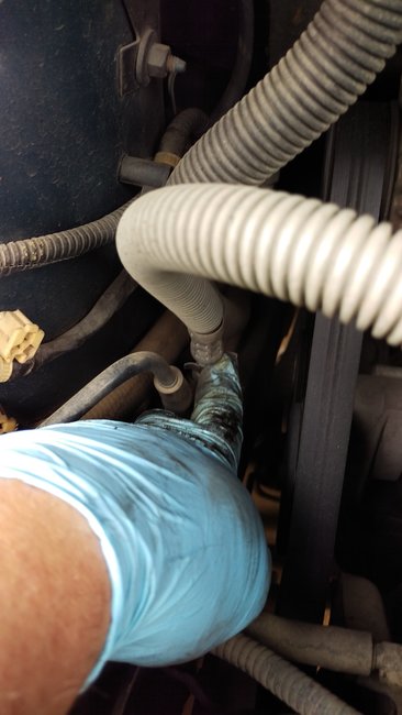

Some models did not have a test port you must tap in the fuel line itself.

I just worked on a 2000 3.3L engine today it didn't have a test port.See picture I attached where my finger is pointing.That's where you will have to tap in to do the fuel pressure test.
