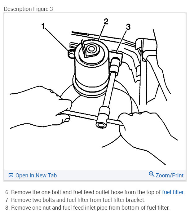

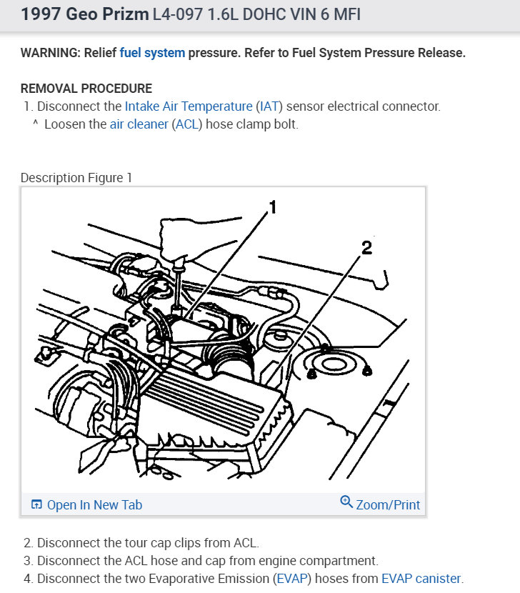

Where is the fuel filter located on this vehicle? How difficult is it to change? Are there any special tools needed?
Thanks,
Jim

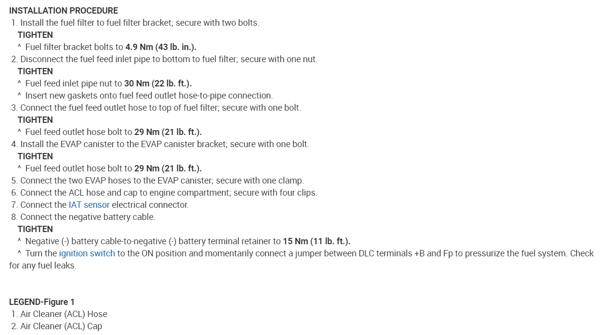

It looks like normal tools will do the job the filter is under the hood here is a guide to help you with the steps and diagrams below to show you how its done on your car.

If that was supposed to be 1995 as the year, your Fuel filter is located on the fire wall, on the drivers side. You wil have to remove the air intake hose from the intake manifold to access it. Be sure to use backup wrenches on the fuel filter when taking out the "banjo" bolts in the ends.

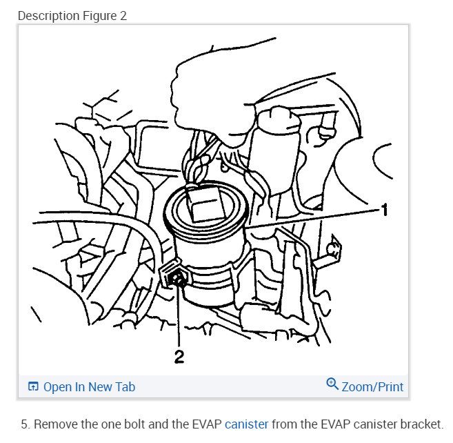

The filter is under the charcoal cannister, bolted to the firewall. Easiest access is to remove the front wheel (drivers side) and acces it from the steering rod hole.
The filter has a banjo bolt on top and a double inverted flare on the bottom. The lower fitting can be hard to get to, use a flare wrench.
There are no vacuum lines attached to the filter, yo may be looking at the cannister, which has two vacuum lines, one small and one large. You should remove the cannister for easier access to the filter

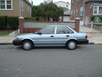

https://images.2carpros.com/forum/automotive_pictures/242209_1_3.jpg
As you can see, it's in prestine condition with only 78,000 miles on it. Everything is relaced, even the timing belt to the radiator! This should go 200,000 miles for sure with Castrol oil and a detergent such as CD-2. I have been using it since a kid and reccomend it. I changed my oil last November and added it. In April when it was drained, it looked like new oil. Good stuff and I highy reccomend it!

Follow fuel line from the connection on the fuel rail (a flexible rubber hose) to the fuel filter. Usually located on the firewall under the cannister. You can see it better by removing the drivers side stone shield and wheel.
The top connection to the filter is a banjo bolt (note position of copper washers, new filter should come with new washers) and lower is an inverted flare connection (you would need a tubing wrench).
