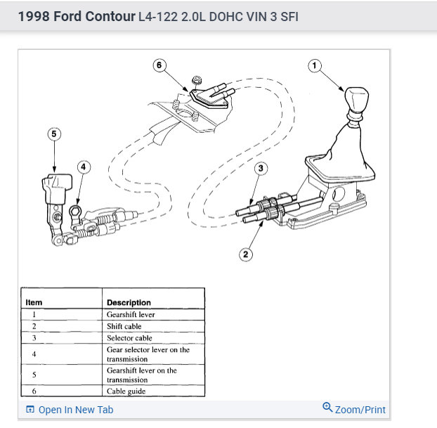

When this happens are you moving and the wheels lock or do you mean the shifter itself won't move?
If it is the shifter itself that is causing the issues, it could be a bushing or adjustment issue with the shift cables. I attached a pic below showing them.
Check to make sure where the cables connect to the transmission there is no excessive play or worn nylon bushings,
Let me know. Also, if this only happens when stopped, there could be an issue with the clutch master cylinder or slave cylinder. Let me know if the clutch pedal feels normal. Also, the clutch master cylinder gets fluid from the brake master cylinder. Make sure the brake fluid is full.
joe
See pic below.

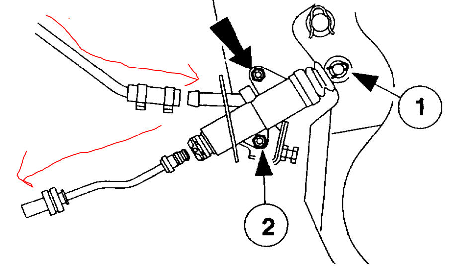

That's a hard question to answer. It really matters how bad the leak is at the slave.
There is a clutch master cylinder attached to the clutch pedal. See pic 1. If you look at the arrows, fluid comes from the brake master cylinder and then is sent to the slave.
Since the brake MC is also the fluid reservoir for the clutch MC, you really need to keep an eye on the brake fluid. Note that the transmission will need to be removed for the slave to be replaced.
On a good note, the transmission gears aren't the problem. It's the clutch that won't disengage the engine and transmission so you can shift.
