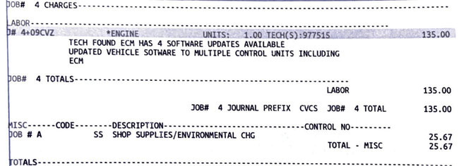

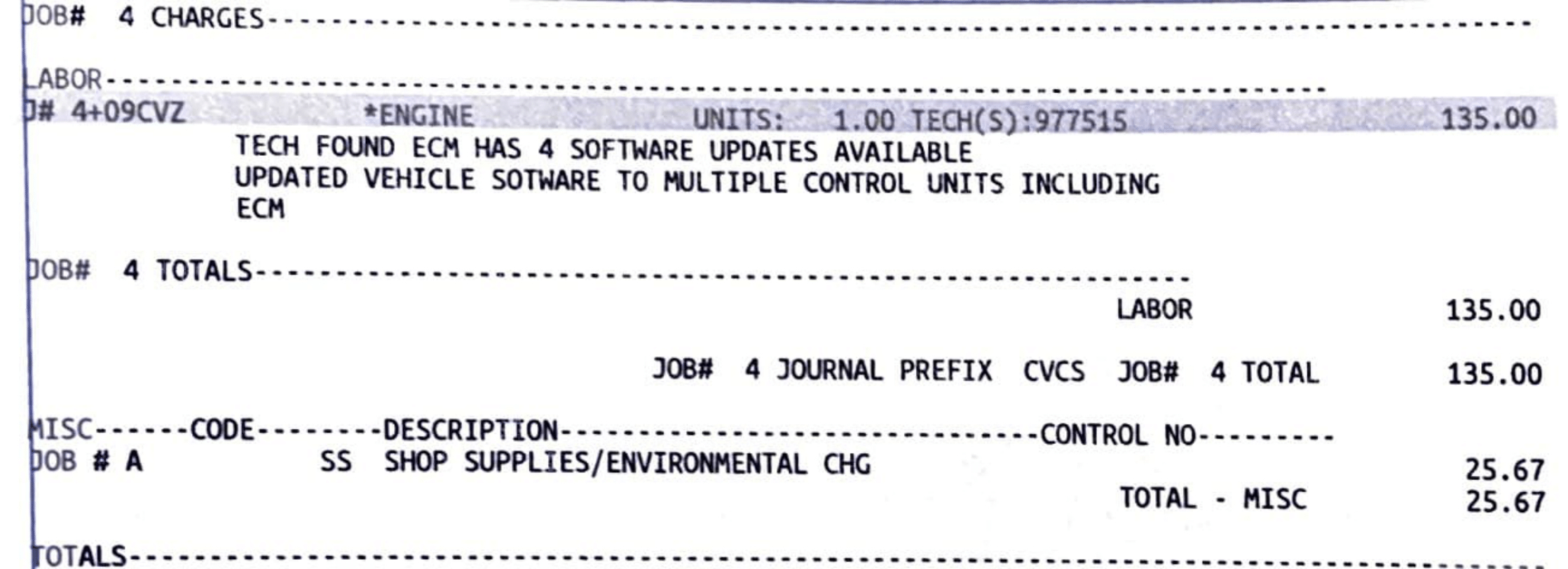

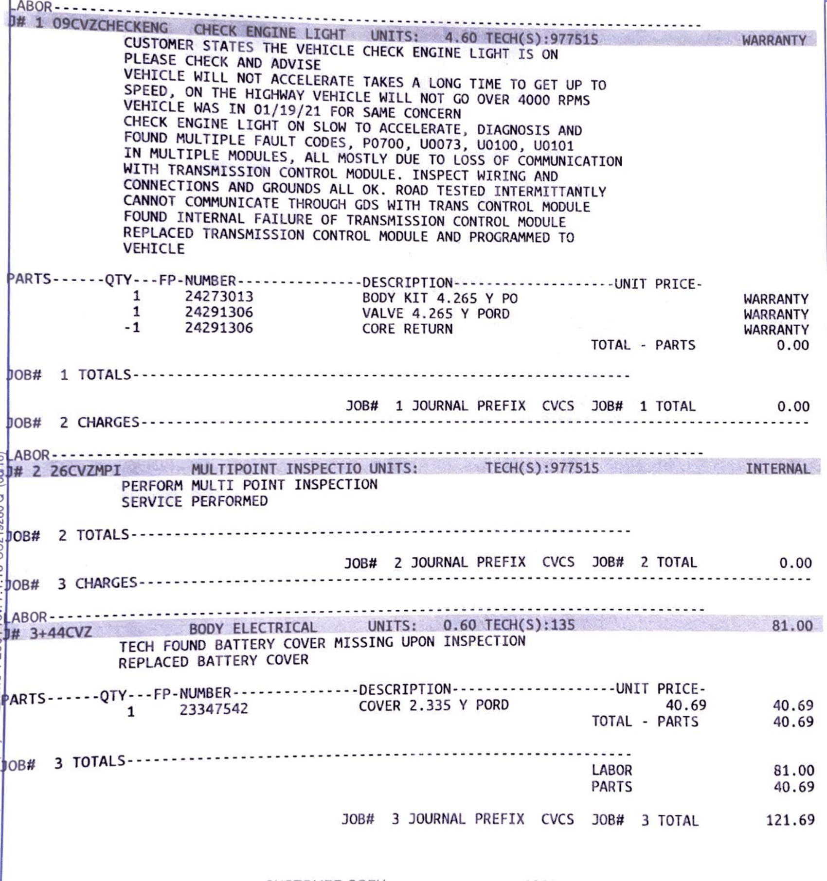

The dealer replaced the TCM and a few other parts (see attached pictures) and that cleared the issue for about a month. Then I fully broke down and was barely able to make it over a hill; I had to have it towed because it was not recognizing what gear i was in. When I tried to put it in reverse, the whole car moved back and forth three times before going into reverse, but again, it wasn’t showing I was in reverse on the dash. When this happens, the indication that I'm in drive (D) flashes on the dash and sometimes even turns off and doesn't even display what gear I'm in.

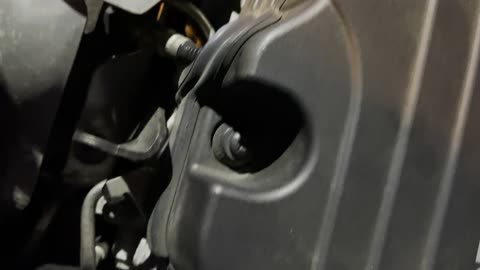

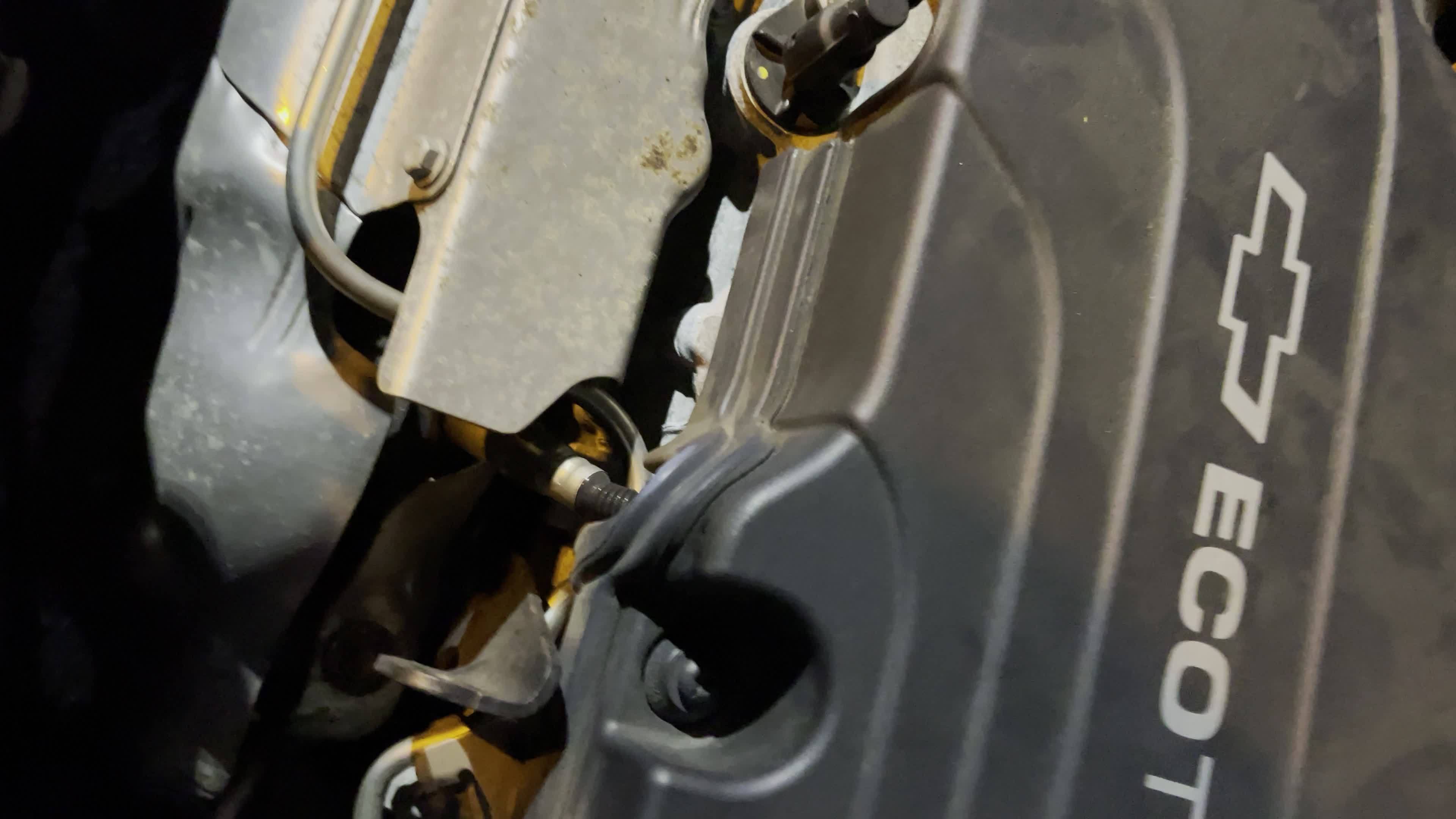

One thing I noticed, the engine gets louder as it's happening and if you pull over, there is a clicking sound (see video).

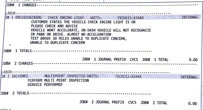

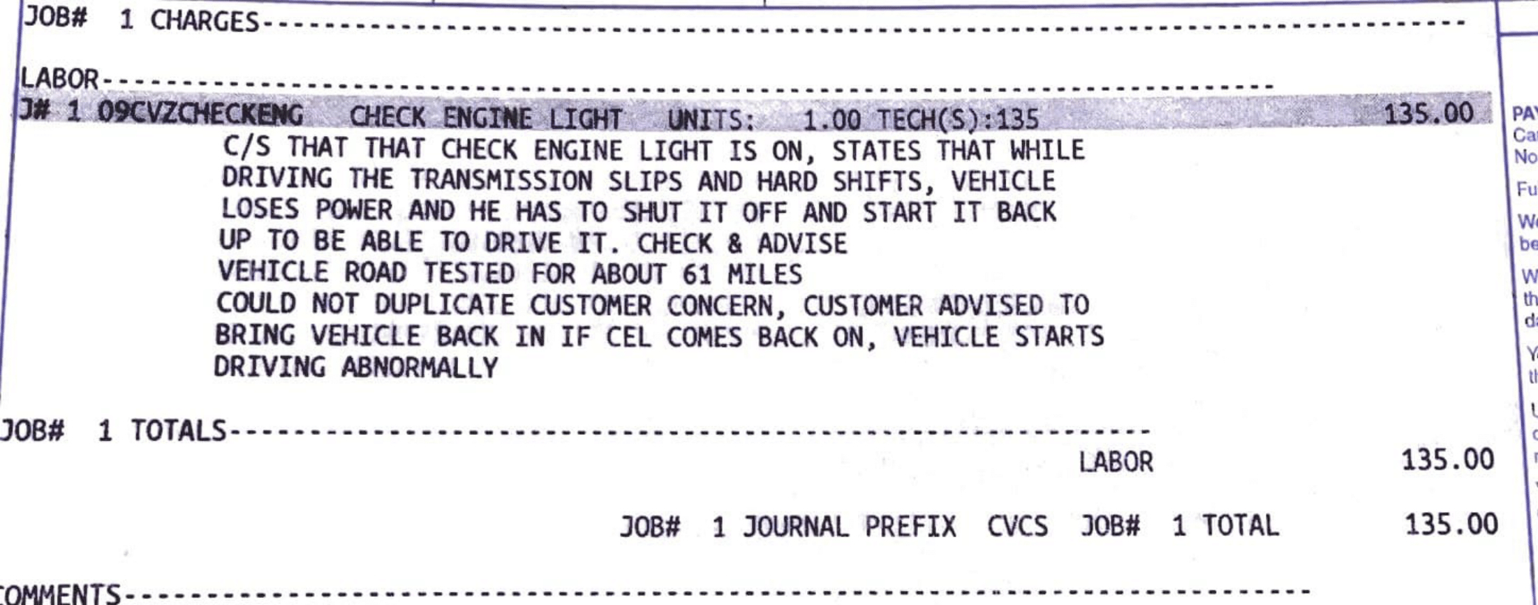

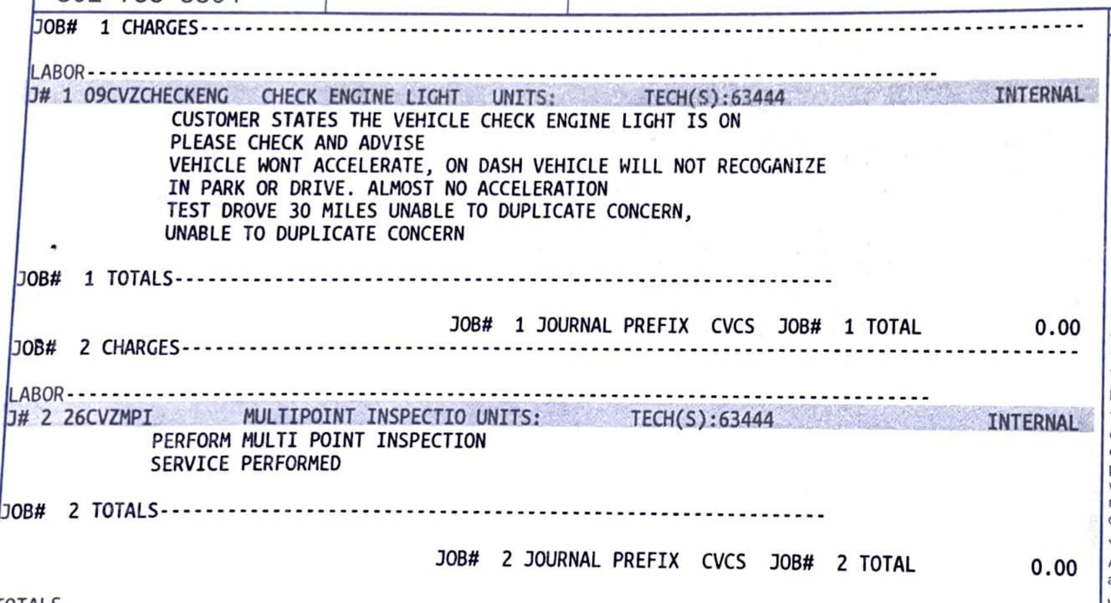

Dealer drove it 30 miles on two separate occasions and the issue was not present but check engine was on, so they cleared the codes and sent me on my way.

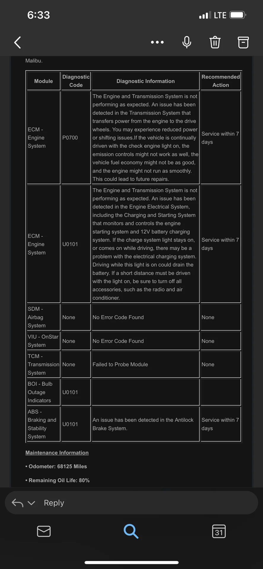

The codes are as follows:
ECM - ENGINE SYSTEM P0700
ECM - ENGINE SYSTEM U0101
BOI - BULB OUTAGE INDICATORS U0101
ABS - BRAKING AND STABILITY SYSTEM U0101

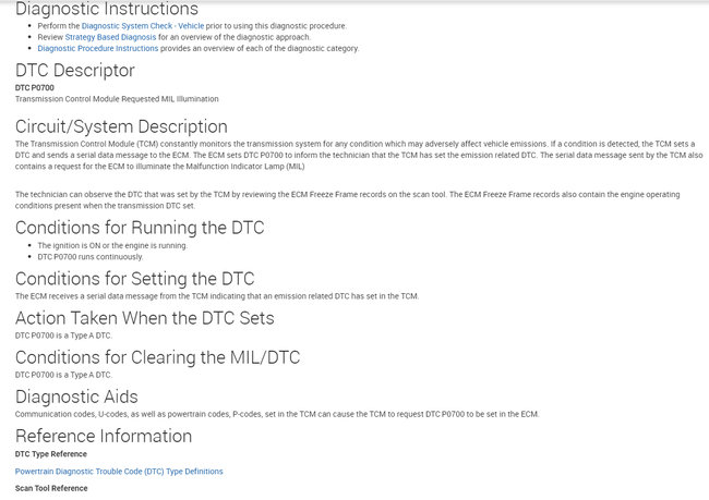

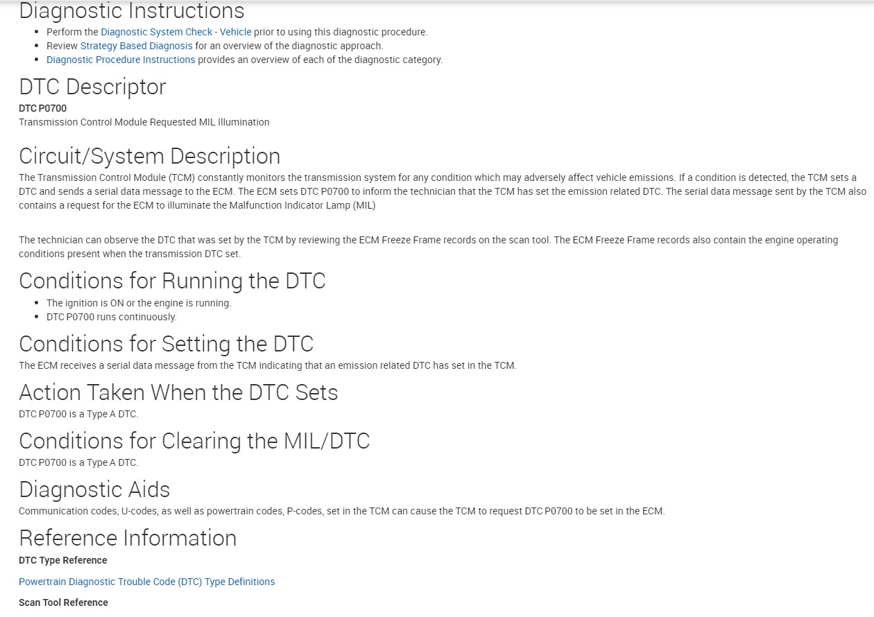

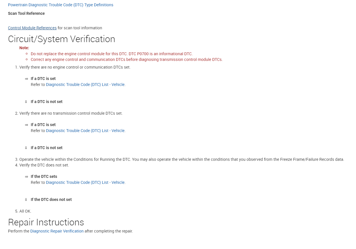

The 700 is a general code for a failure in the transmission system.
There is a code set other than that, but you need a scan tool that can access the transmission to see the actual code.
This sounds like the transmission is slipping badly internally. I attached the flow chart for the 700 codes for you to view.
