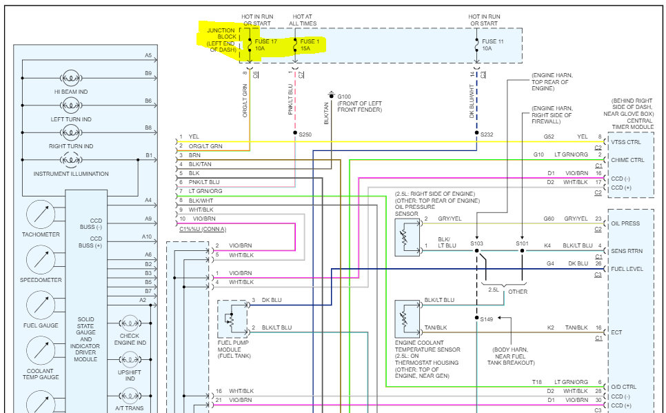

None of my dash gauges are working.
Sep 11, 2022 at 8:01 AM
  • 110,240 POSTS

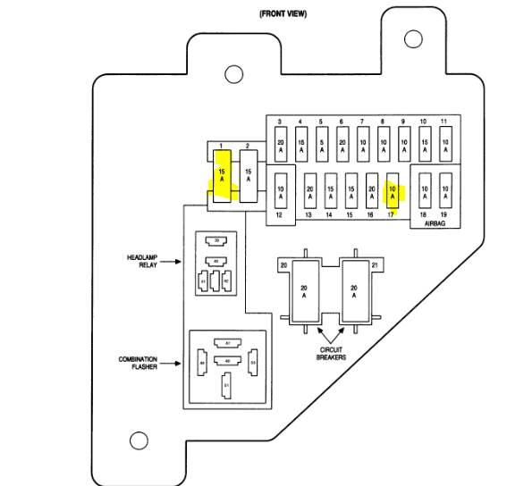

Does anything related to the instrument cluster work? For example, does the speedometer or tachometer work? Do the lights on it work? Is there anything else electrical not working?
If you look up under the dash, you will see an electrical connector to the cluster. Check to make sure it isn't loose or damaged. If it appears to be good, I need you to check two fuses located in the vehicle fuse box at the end of the dash.
Fuses 1 and 17 power the cluster. Check to see if they are both good. Additionally, confirm there is power to and from them as well.
I attached two pics below showing the wiring circuit and fuse locations. Let me know what you find or if you have other questions.
