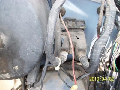

Thanks for the reply Joe. Is this the distribution box that you indicated ? I have tried opening it & my lights, etc came on twice. Does it come apart ? The fuse panel located on the other side of the firewall, has no power on the inop circuits. Returns look good. Thanks again, Roger

There is a black box that says Power Distribution Box in it. It will contain fuses and relays in it. Also, is this the connection that you moved to make things work?

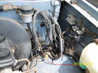

Thanks again Joe. There is no distribution box under the hood as you describe (that I could find), only the fuse panel under the dash. Note picture.. A. this is the connector that I got to work twice by moving it, but can't get it apart. apart?? B. The only relays in in proximity to the open circuit. C. Fuse links which I have checked. D. Open & checked these 3 connectors for continuity.

You must have a bad connection within that harness. Chrysler spliced wires together and they would corrode. Remove the insulation and check. That has to be what it is.

Well Joe, I have reached the point where I have got to invest in a wiring diagram & hope that it will be of some use to me, or spend the money at a local garage & let the experts fix it $$$$. At this point I have no idea what color wire I am looking for in the wiring harness..sure makes it difficult.

Update..Took the old truck into the shop & yup ! it cost $$$. The problem was inside of the large firewall connector, but the mechanic was unable to get the connector apart too. He ran a new wire from the fuse link to the fuse panel. He also said the dimmer switch was destroyed by the incident (?) Everything works....for now.
