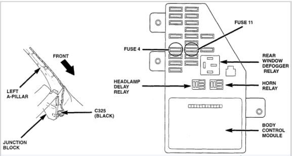

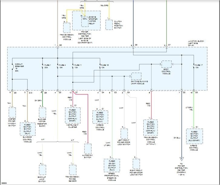

OJ ZAYAS

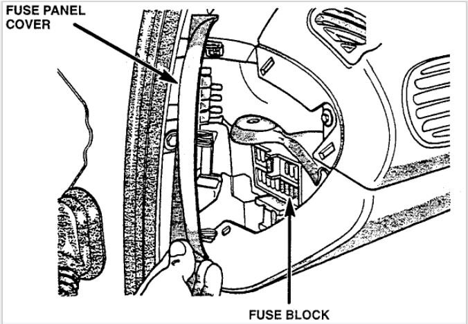

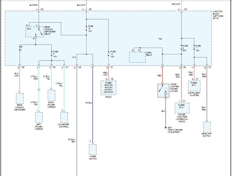

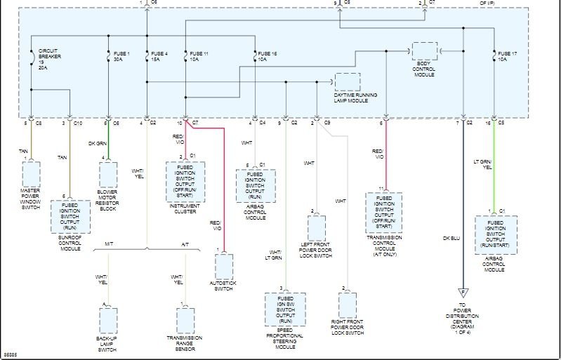

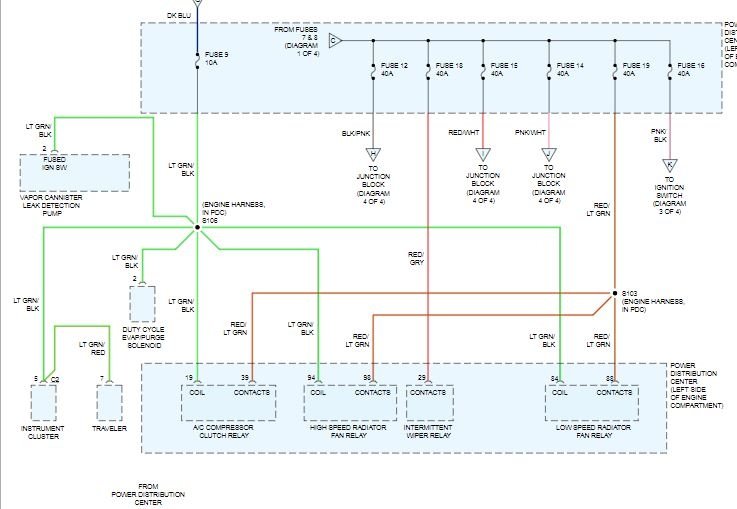

no gas, mileage, tachometer, speedometer.
Sep 14, 2020 at 10:21 AM
4DRTOM
  • 467 POSTS

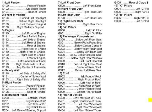

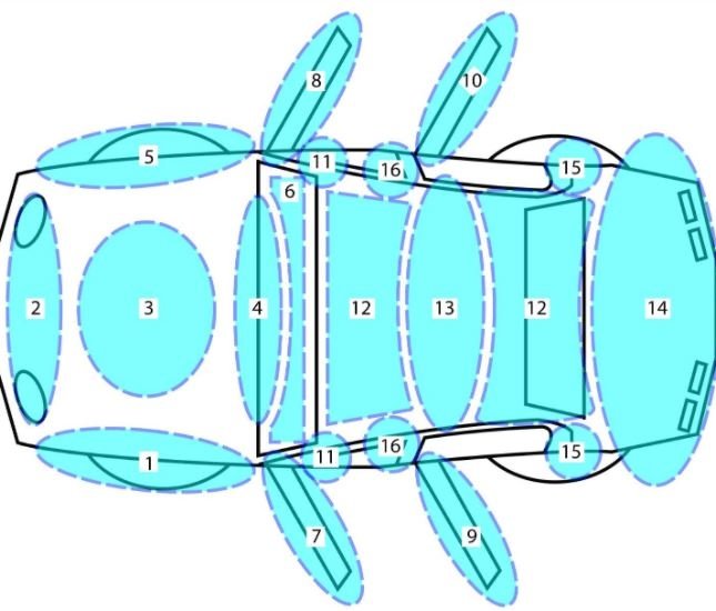

These gauges are run by a module that could be bad also a ground connection could be the issue. I attached a diagram to locate the all the grounds in the car and the fuse information for you to check out.
