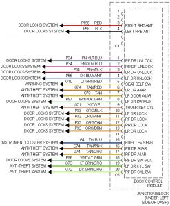

i have a 99 plymouth breeze and recently i was driving it and the dash suddenly stopped working and the dash reads 0 miles the car runs but the dash only will come on if i crank it alot and then when i shut it off it goes off again, along with the dash not working the doors wont lock or unlock as well unless the dash comes alive when it wants to, so i know its all connected some how i just dont know what it could be. please help soon!!!!!!!

Under the left side of the dash is the BCM or Body Control Module. Pull the connector off and get a good look at it for any corrosion or wire chaffing. This seems to be the only common denomenator that I see for the 2 problems.
