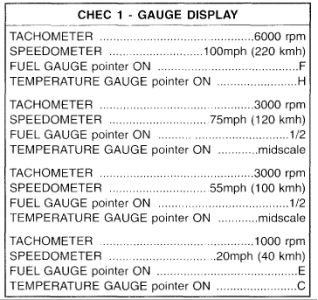

https://images.2carpros.com/forum/automotive_pictures/248015_1_10.jpg
CHECK I If all gauges fail to move, replace Cluster Printed Circuit (PC) Board. If any gauge fails to move, replace the gauge assembly If any gauge(s) is not in the proper position, replace Cluster Printed Circuit Board.

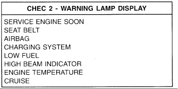

https://images.2carpros.com/forum/automotive_pictures/248015_2_7.gif
CHECK 2 If any lamp does not light, check lamp. If lamp is not OK, replace lamp. If lamp is OK, replace Cluster Printed Circuit Board.

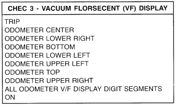

https://images.2carpros.com/forum/automotive_pictures/248015_3_8.gif
CHECK 3 If any V/F segment does not light, replace Odometer/Transmission Range Indication.

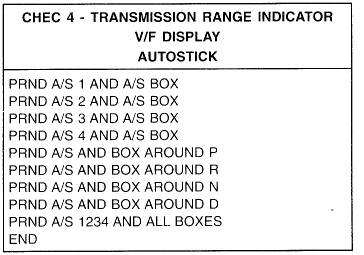

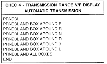

https://images.2carpros.com/forum/automotive_pictures/248015_4_4.gif
https://images.2carpros.com/forum/automotive_pictures/248015_5_3.gif
CHECK 4 If any V/F segment does not light, replace Odometer/Transmission Range Indication. Hope this helps
