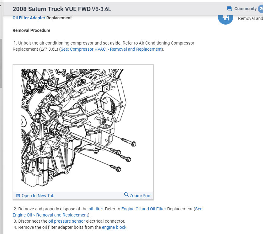

Where is the oil gasket adapter located?
2008 SATURN VUE
125 MILES • 3.6L • 6 CYL • 2WD • AUTOMATIC
OHHCINDY
The radiator oil mixes with the water deposit. I have to change the oil gasket adapter, but I am having trouble finding the location of it in my engine.
Feb 12, 2022 at 7:13 AM
AL514
  • 5,639 POSTS

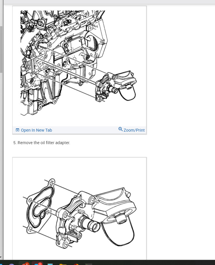

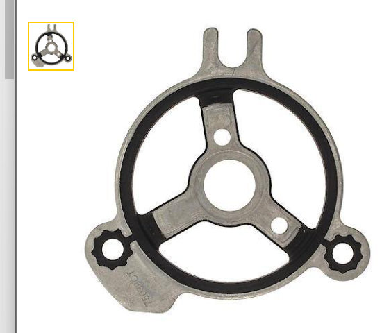

Hello, are you saying you have oil in your coolant system? There is a Transmission Cooler line that runs through the Radiator. The transmission fluid will have more of a reddish look to it.
Here is a guide that will help with finding if a head gasket is blown.

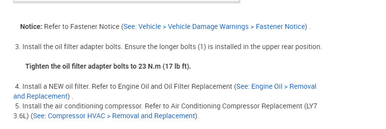

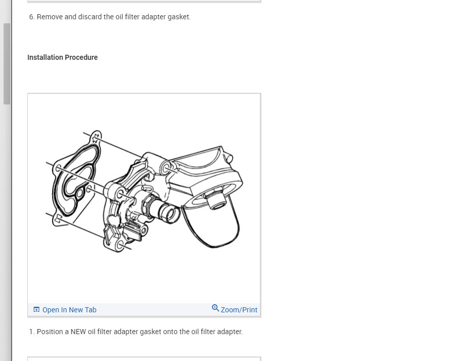

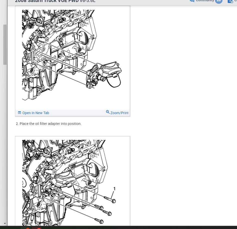

However, are you suspecting that the oil filter adaptor housing is the issue? If so, I attached the process below on how to replace it so please run through this info and let us know what questions you have.
Thanks
