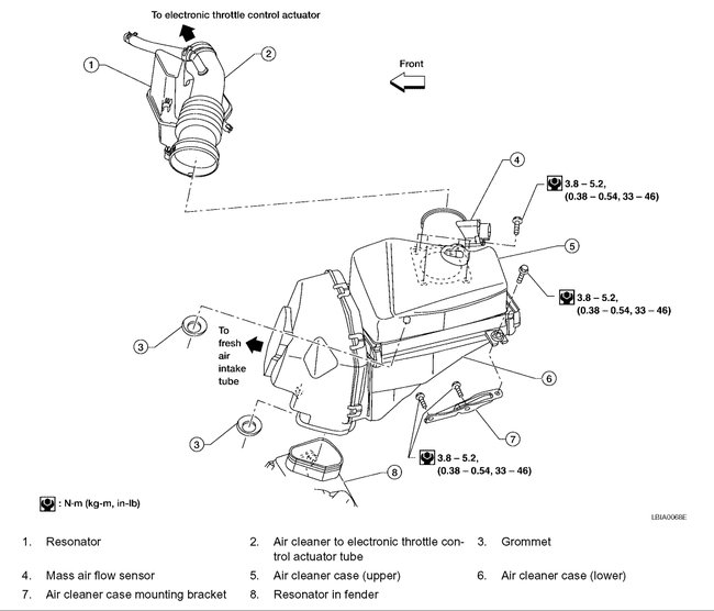

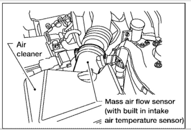

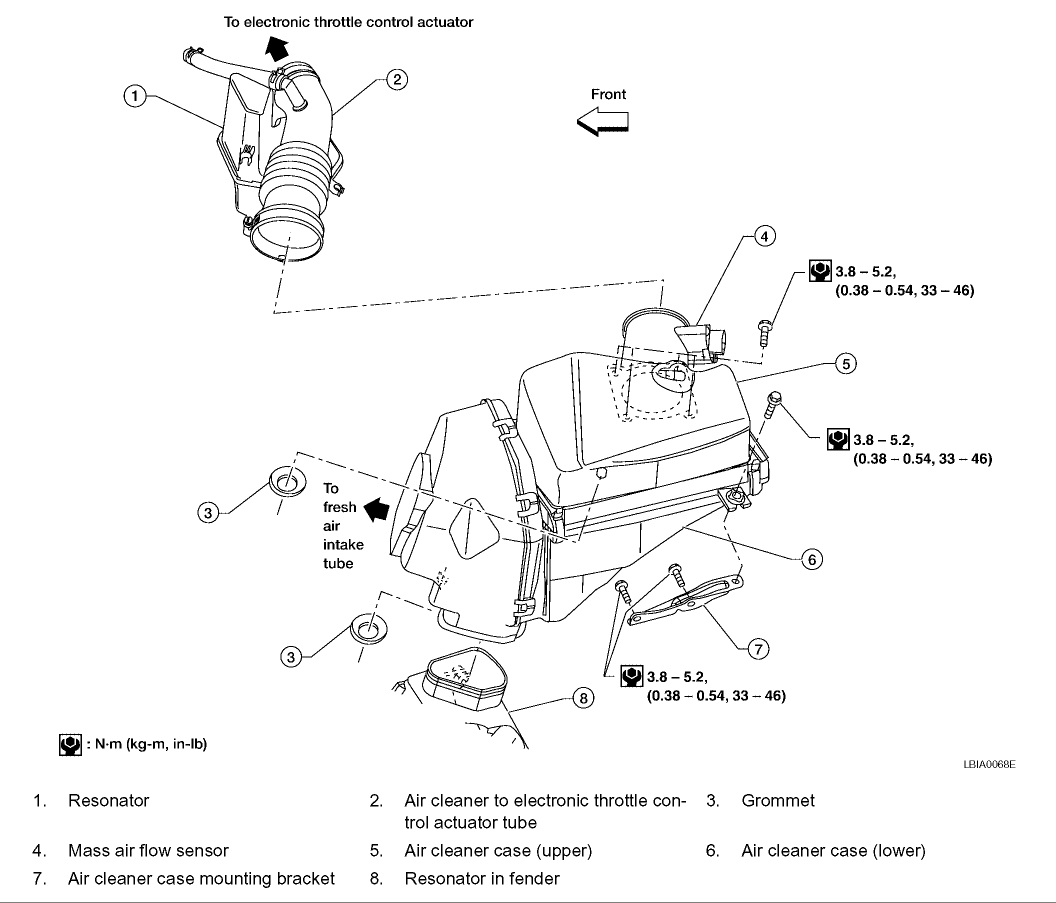

Never smell fuel, it rolls down an incline in neutral (easily). Drive is about ten miles plus, one way, freeway speed of sixty five to seventy mph and the rpm's are usually around 3,000. Manual says this model does not have a MAF sensor. But that it does have a more improved system that would have to be checked by a pro. I drive sensibly. May just have to take it for service I am trying to save money, as I am retired and do not have much of it! Car repairs and vet bills are a luxury. I did notice today that it does seem to be running a little rough. But it did pass its smog test not so long ago. Been using mid grade gas from the better stations almost all the time too.
May 7, 2018 at 11:38 AM
STEVE W.
  • 15,345 POSTS
The book may call it an air flow meter, but it is the same thing as a MAF sensor. It is bolted to the top of the air cleaner housing.
ten mile drive is barely getting the engine warmed up, it could be running in open loop for much of that time which will negatively affect gas mileage. Then it transfers to a high load/high speed mode that also dumps extra fuel into the engine. But even then seven mpg sounds really low. Was this something that just happened or has it been getting poor mileage for the entire time you owned it?
You mention it is running rough. That could easily be the result of extra fuel being injected, to see that though you need a scan tool that can read live data, specifically the fuel trims and the AF ratio sensor signal. Those would tell you what the computer is seeing with regard to fuel flow and engine load.
