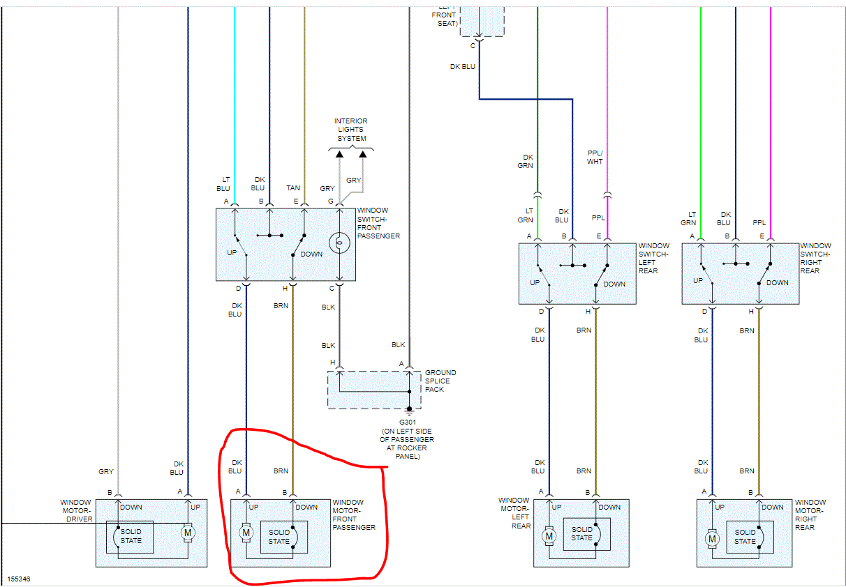

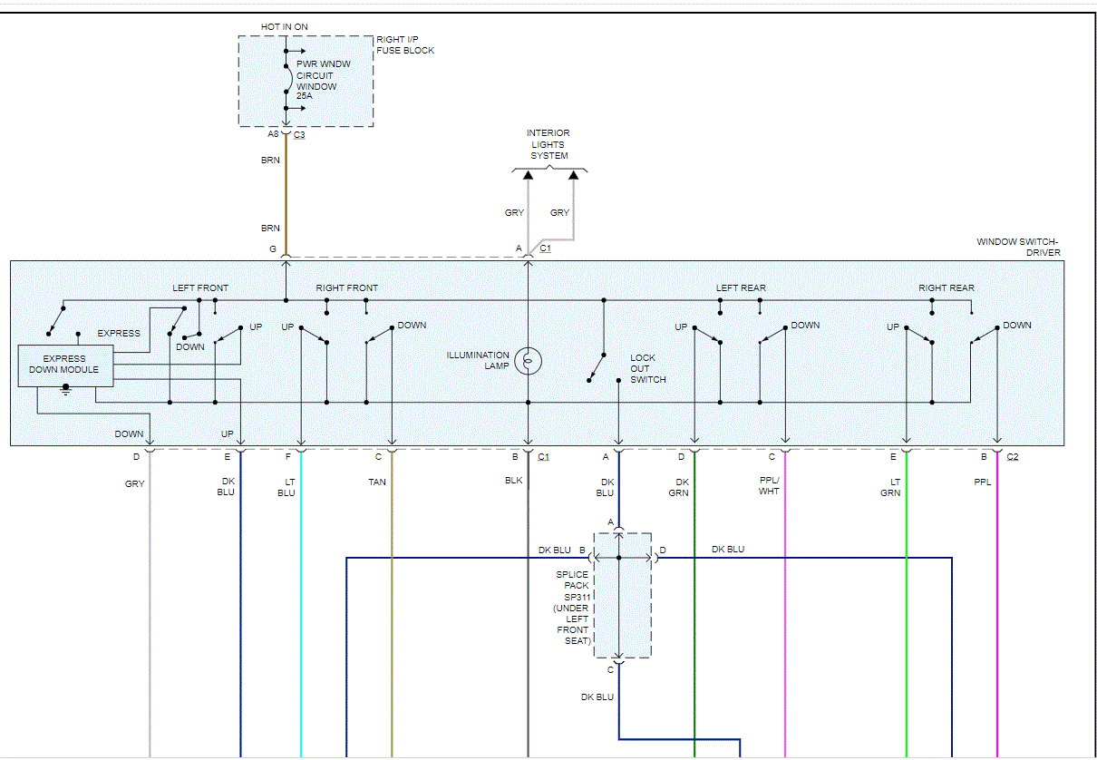

My passenger side window no longer works... Before I change the regulator and motor I want to start with fuses. does this car have more than one fuse for power windows?
Jun 10, 2021 at 2:34 AM
  • 110,239 POSTS
There is only one fuse. I'm not sure if this is a two-door or four-door vehicle. I attached the wiring schematics below for a four-door. If that is incorrect, let me know.
Although the fuse is good, it could be a wiring or switch issue. So, what I recommend is to remove the door panel and check for power at the affected window motor.
Let me know what you find. Note that there are two wires at the motor. Based on which direction you select (up or down) will determine which wire gets power.
Let me know. Also, confirm if it is a four-door or not.
