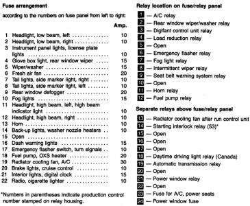

I do not have a cover for my fuse box, therefore, i do not know what fuse goes to what.

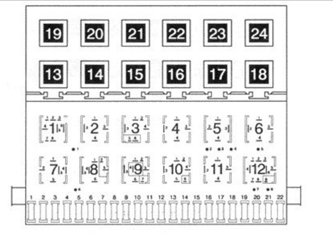

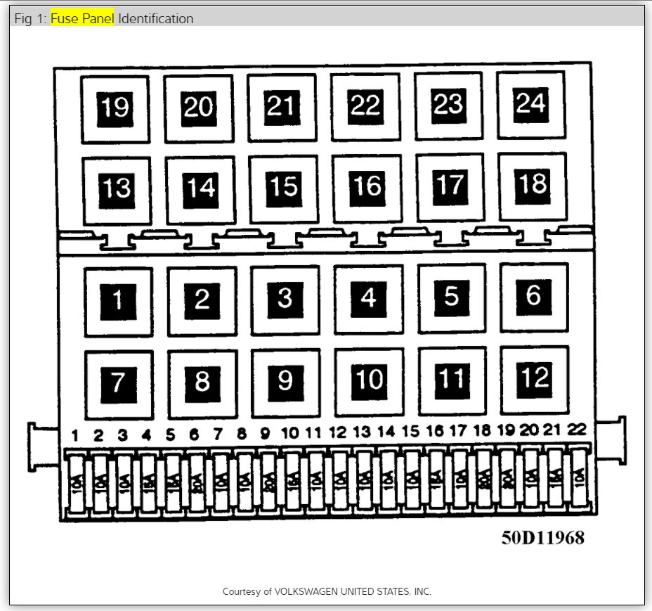

Hi OPAL ANN,

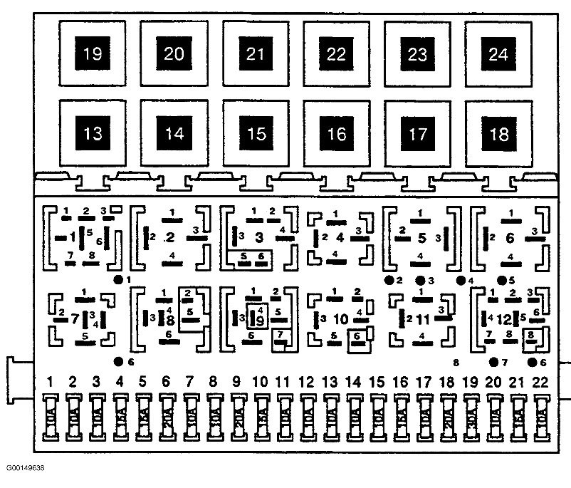

I found these diagrams for you, let me know if you need anything else. The number indicate which relay and use for each circuit.
Best, Ken

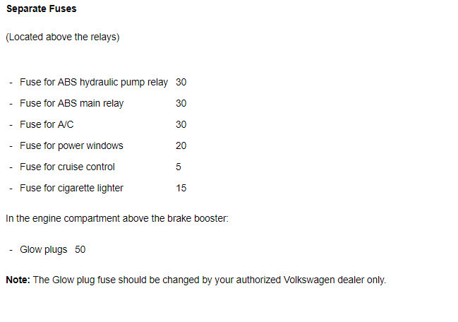

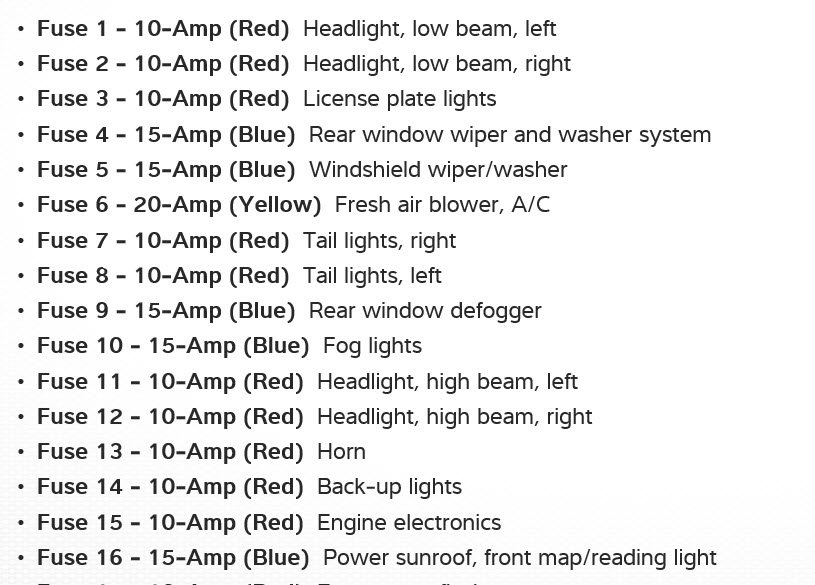

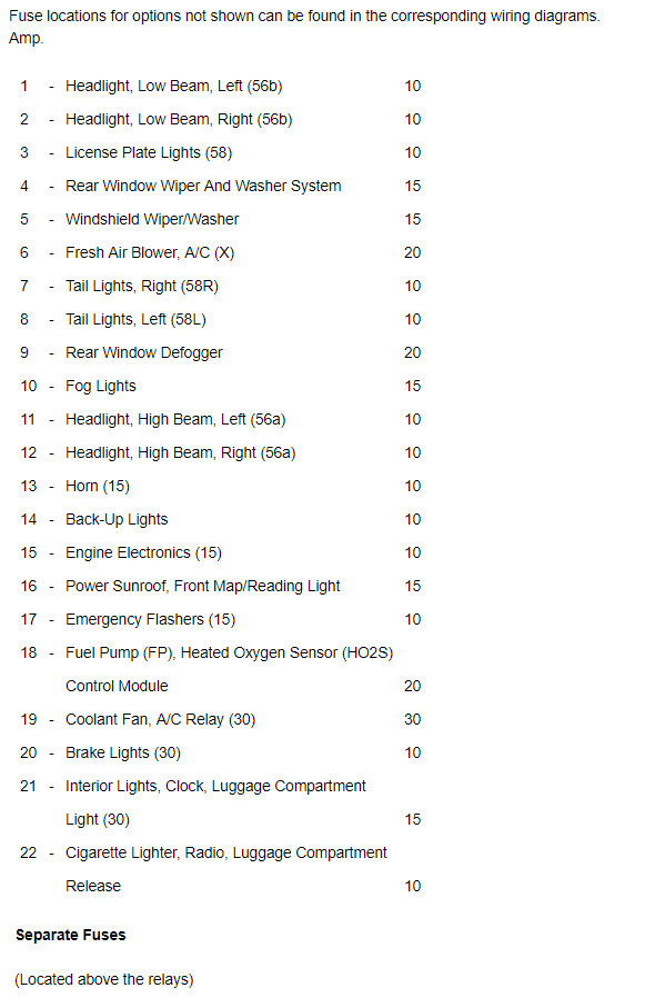

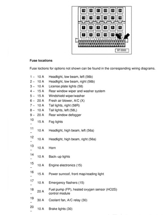

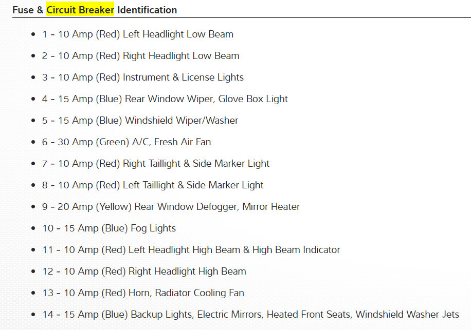

Hello Denise, I have attached the information on the fuses. Also, if you need more info please indicate your engine by liter 1.8L, 1.9L, or 2.0. Also, is the model a GL, GLS, GLX, GT or TDI? As for the alarm I would prefer to have the above information first to make sure I had the correct vehicle to review. If I may ask, what is the reason you want to disconnect the alarm system? Is it not working correctly? something we may be able to assist with fixing? There is more larger diagrams (below).
https://images.2carpros.com/forum/automotive_pictures/248015_1_103.jpg
Fuse locations for options not shown can be found in the corresponding wiring diagrams. Amp. 1 - Headlight, Low Beam, Left (56b) 10 2 - Headlight, Low Beam, Right (56b) 10 3 - License Plate Lights (58) 10 4 - Rear Window Wiper And Washer System 15 5 - Windshield Wiper/Washer 15 6 - Fresh Air Blower, A/C (X) 20 7 - Tail Lights, Right (58R) 10 8 - Tail Lights, Left (58L) 10 9 - Rear Window Defogger 20 10 - Fog Lights 15 11 - Headlight, High Beam, Left (56a) 10 12 - Headlight, High Beam, Right (56a) 10 13 - Horn (15) 10 14 - Back-Up Lights 10 15 - Engine Electronics (15) 10 16 - Power Sunroof, Front Map/Reading Light 15 17 - Emergency Flashers (15) 10 18 - Fuel Pump (FP), Heated Oxygen Sensor (HO2S) Control Module 20 19 - Coolant Fan, A/C Relay (30) 30 20 - Brake Lights (30) 10 21 - Interior Lights, Clock, Luggage Compartment Light (30) 15 22 - Cigarette Lighter, Radio, Luggage Compartment Release 10 Separate Fuses (Located above the relays) - Fuse for ABS hydraulic pump relay 30 - Fuse for ABS main relay 30 - Fuse for A/C 30 - Fuse for power windows 20 - Fuse for cruise control 5 - Fuse for cigarette lighter 15 In the engine compartment above the brake booster: - Glow plugs 50. Note: The Glow plug fuse should be changed by your authorized Volkswagen dealer only. Please let us know if you need anything else to get the problem fixed. Cheers

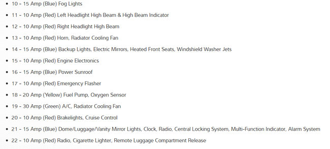

DAWQUILTS

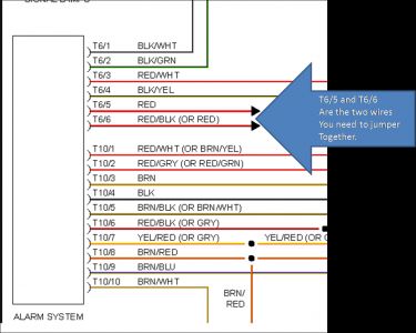

the alarm is totally annoying it goes off intermittently, and sometimes after i have gotten in the car, put on my seat belt, turned the key. the only way to turn it off is to get out of the car, close the drivers door, turn the key (in the outside of the drivers door) counter-clockwise. i live in the "student ghetto" and the alarm annoys everyone living around me, as well. i use a "club" to keep the car from being stolen. i do not want the alarm functioning! if you can help, i would sure appreciate it. thanks
Jul 14, 2020 at 5:16 AM (Merged)
IMPALASS
  • 3,112 POSTS
Well I totally understand that it is annoying.
If the alarm system could be fixed for little to nothing would that be okay or you just want it disconnected period?
Has it always done this or just started and if so how long?
While I am checking to see if it can be disconnected without changing the function of the car/computer etc.
If you would though could you check the fuses at spot 21 and 22. I do not know if you have an ohm meter that would be the best way. But if one or both are missing or if they are bad, please let me know as this will cause the alarm to act up.
Next, if one or both are missing please install a 15amp in 21 and a 10amp in 22. If they are there and you do not have an ohm meter to check them with, I would still rather you replace them.
Once you have installed or replaced, then cycle the key in the drivers door to reset the alarm system.
This may fix your problem. In the mean time, I will look through the wiring diagrams to see what can be done.
Also, if you would, please go to Auto Zone (AZ) or O'Rielly's (or) and for free they can pull the codes to the car. Most important: Once they check your codes, if they find something and you do not get it fixed and need to get back with us, please make sure you tell us exactly what the code was, number and all. Example, if the code was E0568 O2 Sensor bad. Then make sure you give us all of that. The alarm system may have thrown a code which will help us out too. While there for free also they can bring their tester out and check your battery, alternator and starter. It is getting winter so might as well make sure those are working just fine.
Let me know and we will try to get this fixed or shut off as soon as possible.

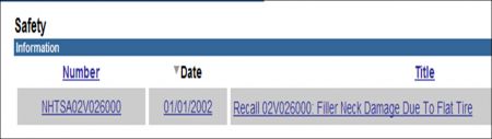

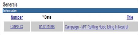

Oh Denise, Forgot one thing! Looks like you may have some recalls on your vehicle. The dealer may fix these for free. Please contact the dealer service department, give them the VIN number of your car and have them check on these to see if they apply to you.
https://images.2carpros.com/forum/automotive_pictures/248015_Picture1_27.jpg
https://images.2carpros.com/forum/automotive_pictures/248015_Picture2_25.jpg

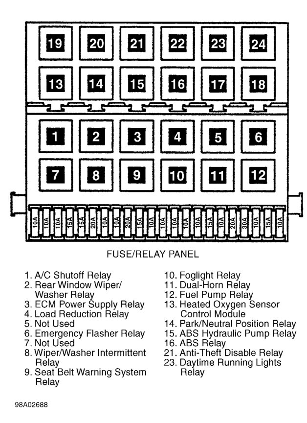

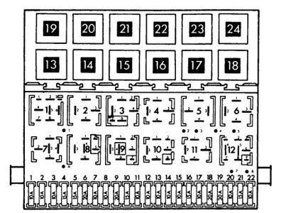

HMAC300
  • 48,601 POSTS
see pics

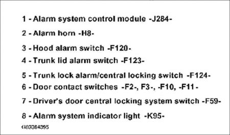

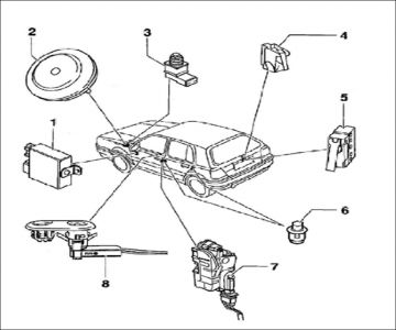

IMPALASS
  • 3,112 POSTS
Hello, No problem on the delay. I hope you had a nice time out of town. Okay, lets get down to business and see what we can do here before anyone goes crazy. I have attached several pictures that you are going to refer to. We are trying to get to the Alarm System Control Module J284. It is supposed to be located on the drivers side, behind a bracket on the left A-pillar. I have attached the manuals directions to get to it. Remove driver's side instrument panel trim. Disconnect 6-pin and 10-pin connectors from alarm system control module -J284-, located behind bracket on left A-pillar. It will have two connectors on a 6 pin connector and a 10 pin connector. It may be silver, black or even white in color. Unplug both of them. Review the wire colors on the chart to assist. Now look at the 6 pin connector. The 6 pin connector has two large gauge red or red/black wires. Refer to the wiring diagram. You need to jumper the wires together and then I would tape it so it does not come loose. If it does you may not be able to start the car. Once you do this, this should bypass the alarm's starter kill function, and disable the alarm. Try to start the car. Please note the key-less functions will no longer work as well. Let me know if this works.
https://images.2carpros.com/forum/automotive_pictures/248015_Alarm_1_1.jpg
https://images.2carpros.com/forum/automotive_pictures/248015_Alarm_2_1.jpg
https://images.2carpros.com/forum/automotive_pictures/248015_Alarm_4_1.jpg
https://images.2carpros.com/forum/automotive_pictures/248015_Alarm_5_1.gif
https://images.2carpros.com/forum/automotive_pictures/248015_Alarm_6_1.jpg

locate the alarm module should be 2 plugs only, first thing first, put your key in the ignition turn electronic on, not engine. keep that key like that, unplug the battery, then you unplug the 2 plug off the alarm module. Now plug the battery, while with the key turned on (ON)(AC), is gonna bypass the alarm when you do the next time unplug the battery on accident and not knowing when you put it back on it scared the living crabs out your pants ;P, lol the alarm goes off like crazy? this is it your last step, you then plug those 2 plugs back into the alarm module and BOOM no alarm coming on. That's my way of bypassing since i don't have an alarm button control for it, but am gonna hook up the alarm to the ignition or just put a switch to notch it off when it goes off i just press it'll be off in less of a sec, lol. If you want to disable it your gonna have to say goodbye to the horns also. Unless you cut the alarms horns wire, then it'll still be trigger and you might have a fuel pump lock due to anti-theft still triggered.

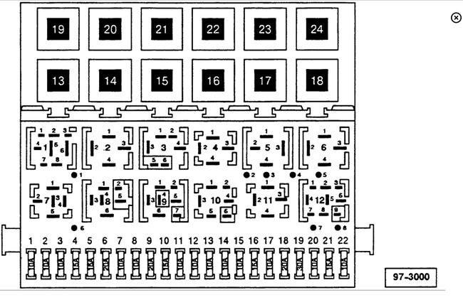

Sir-I hope this is what you are looking for-see below: Fuse Location
https://images.2carpros.com/forum/automotive_pictures/12900_f_7.jpg
Fuse locations for options not shown can be found in the corresponding wiring diagrams. Amp. 1 - Headlight, Low Beam, Left (56b) 10 2 - Headlight, Low Beam, Right (56b) 10 3 - License Plate Lights (58) 10 4 - Rear Window Wiper And Washer System 15 5 - Windshield Wiper/Washer 15 6 - Fresh Air Blower, A/C (X) 20 7 - Tail Lights, Right (58R) 10 8 - Tail Lights, Left (58L) 10 9 - Rear Window Defogger 20 10 - Fog Lights 15 11 - Headlight, High Beam, Left (56a) 10 12 - Headlight, High Beam, Right (56a) 10 13 - Horn (15) 10 14 - Back-Up Lights 10 15 - Engine Electronics (15) 10 16 - Power Sunroof, Front Map/Reading Light 15 17 - Emergency Flashers (15) 10 18 - Fuel Pump (FP), Heated Oxygen Sensor (HO2S) Control Module 20 19 - Coolant Fan, A/C Relay (30) 30 20 - Brake Lights (30) 10 21 - Interior Lights, Clock, Luggage Compartment Light (30) 15 22 - Cigarette Lighter, Radio, Luggage Compartment Release 10 Separate Fuses (Located above the relays) - Fuse for ABS hydraulic pump relay 30 - Fuse for ABS main relay 30 - Fuse for A/C 30 - Fuse for power windows 20 - Fuse for cruise control 5 - Fuse for cigarette lighter 15 In the engine compartment above the brake booster: - Glow plugs 50 Note: The Glow plug fuse should be changed by your authorized Volkswagen dealer only.

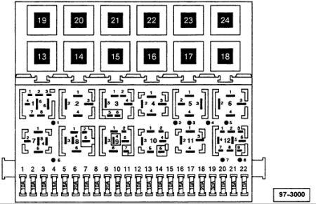

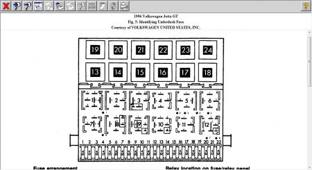

1996 Volkswagen Jetta
need relay diagram in fuse box.removed relay with # 53 on it and forgot where it went !!! car will not turn over now
  • 75,992 POSTS

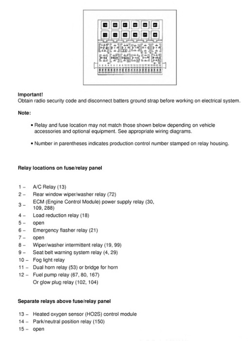

Hi rrobertt, Welcome to 2carpros and TY for the donation The starter interlock relay mark no.53 goes to no14 slot-see below
https://images.2carpros.com/forum/automotive_pictures/12900_jetta_1.jpg

I need a picture diagram for the Relay Box that will show me exactly what fuse goes where. I am trying to fix someone else's mistakes and they removed all fuses and I can not get them to match up correctly. Thanks!
  • 55,421 POSTS
Here is a guide to help you check the fuses once you find them by using the diagrams below.

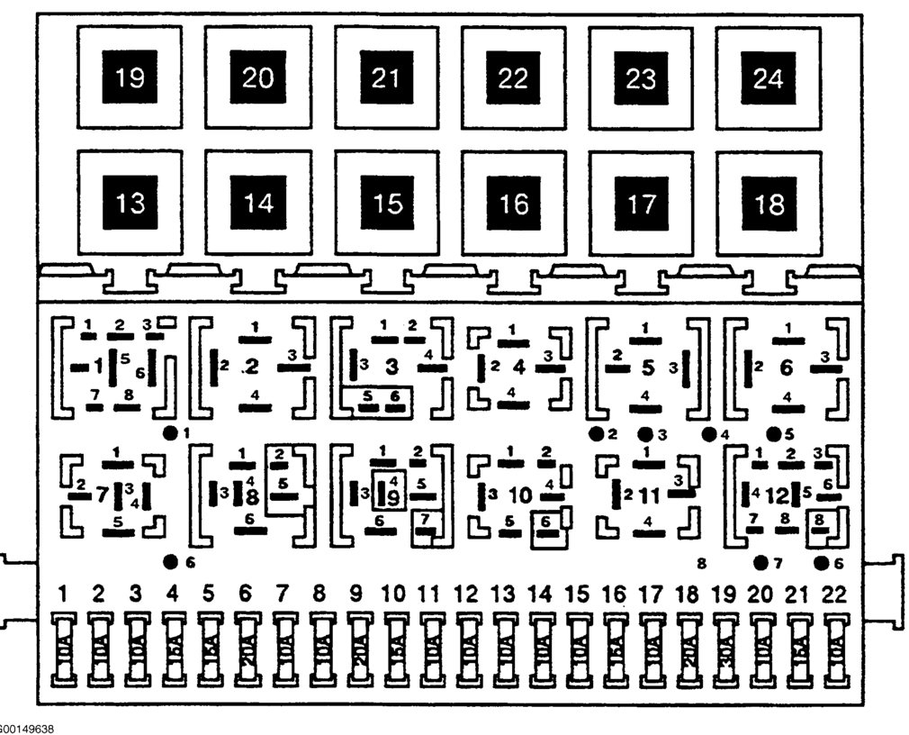

I've looked and i don't have a cover. i am missing #8 relay fuse. Also the parking lights do not work and my blinker lights only work if i turn on my high beams.
Jul 14, 2020 at 5:19 AM (Merged)

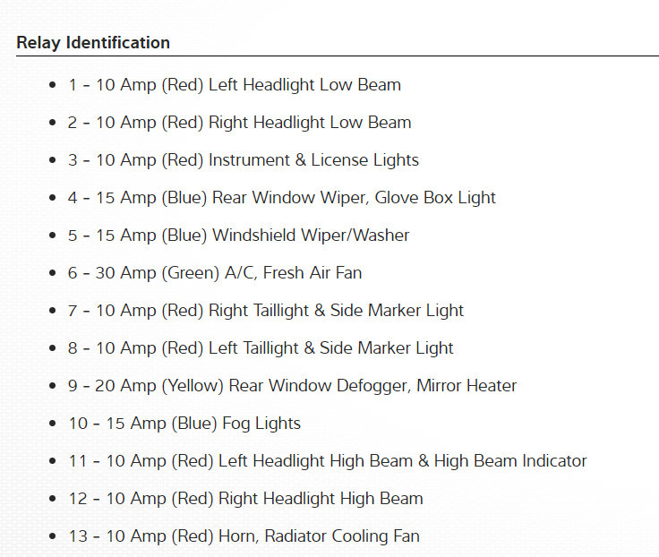

EXOVCDS
  • 1,883 POSTS
Fuse #8 (left to right 1 to 22) is for left tail light & side marker.
It's supposed to be a 10amp fuse.
I'll see if I can find a complete list/diagram to post.

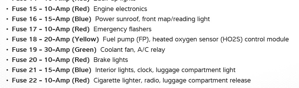

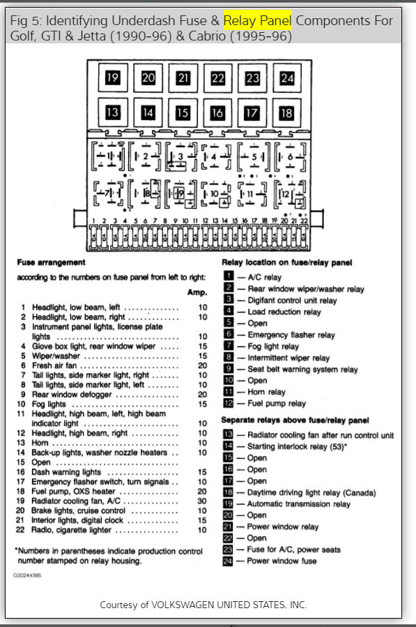

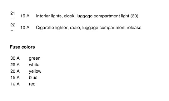

EXOVCDS
  • 1,883 POSTS
Fuse/relay info below...
