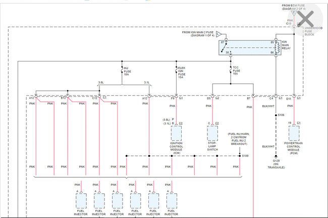

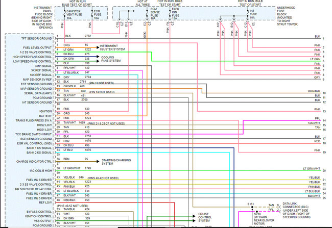

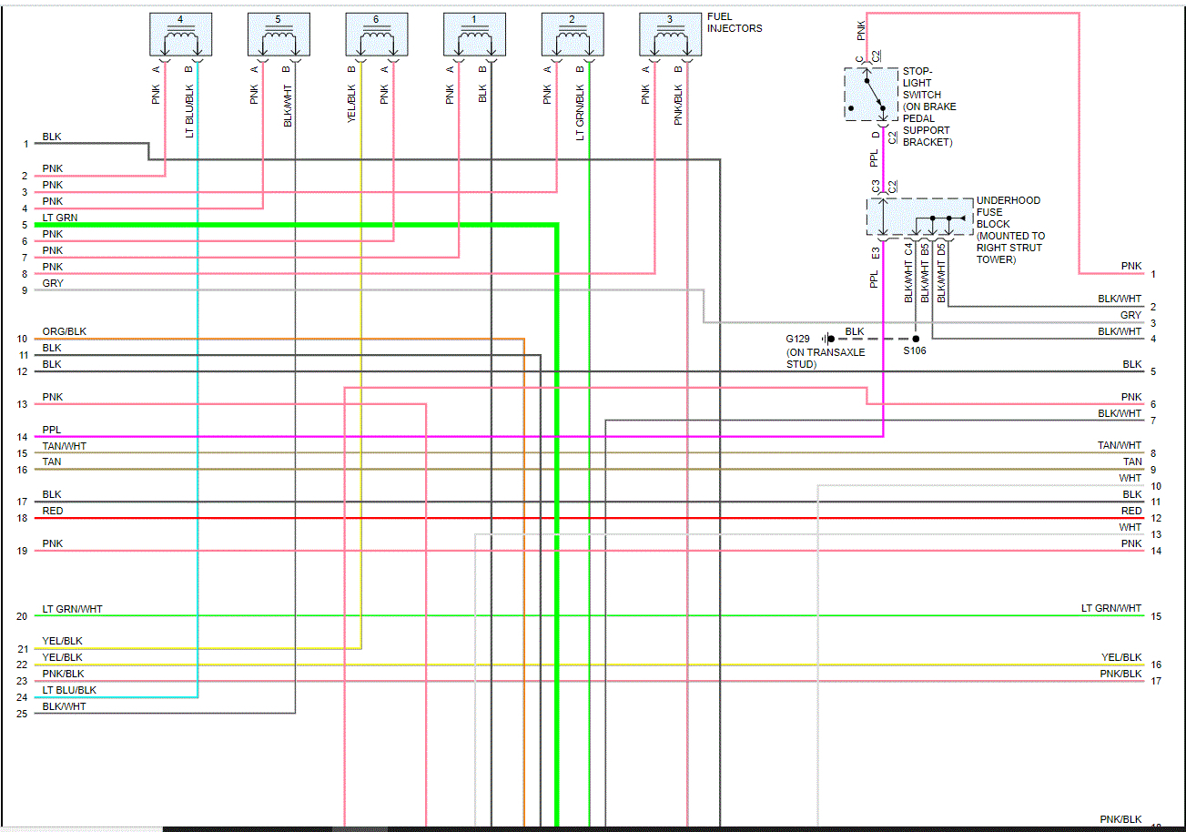

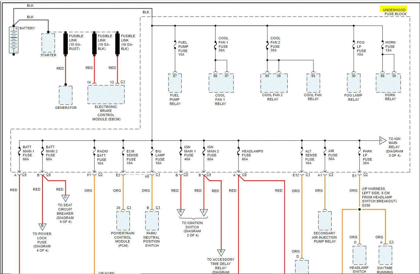

A rat ate wiring to PCM. I need to know the pinout on the fuse box for wires to the PCM control module.

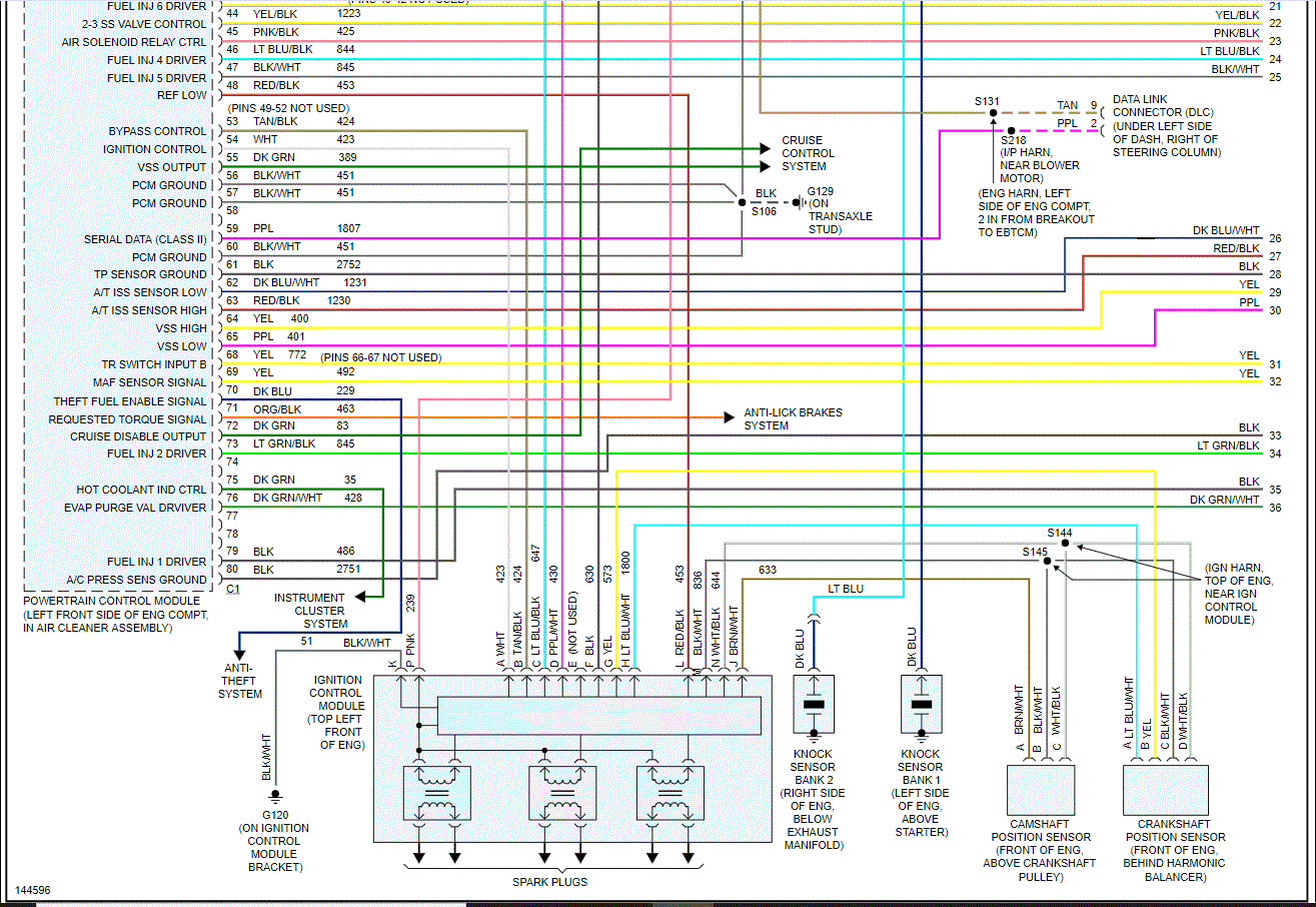

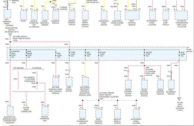

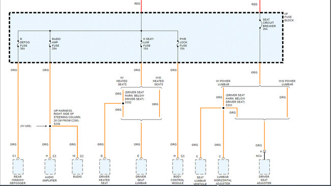

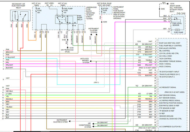

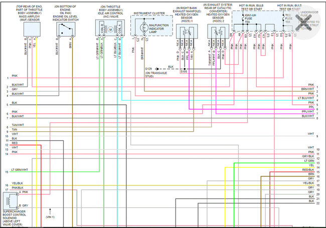

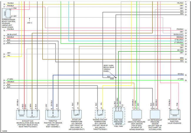

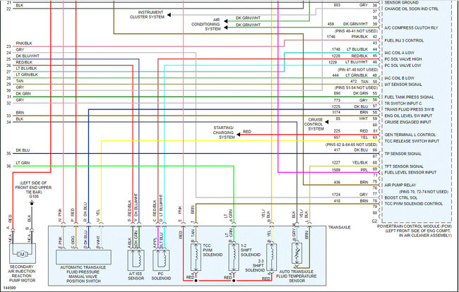

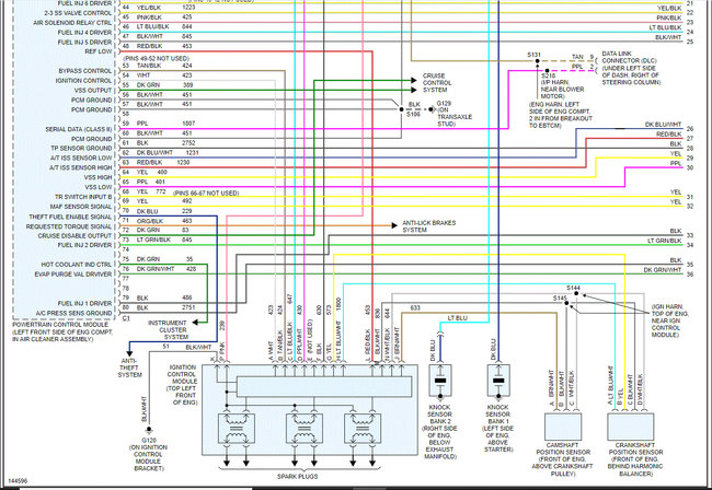

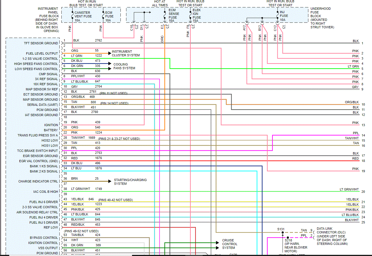

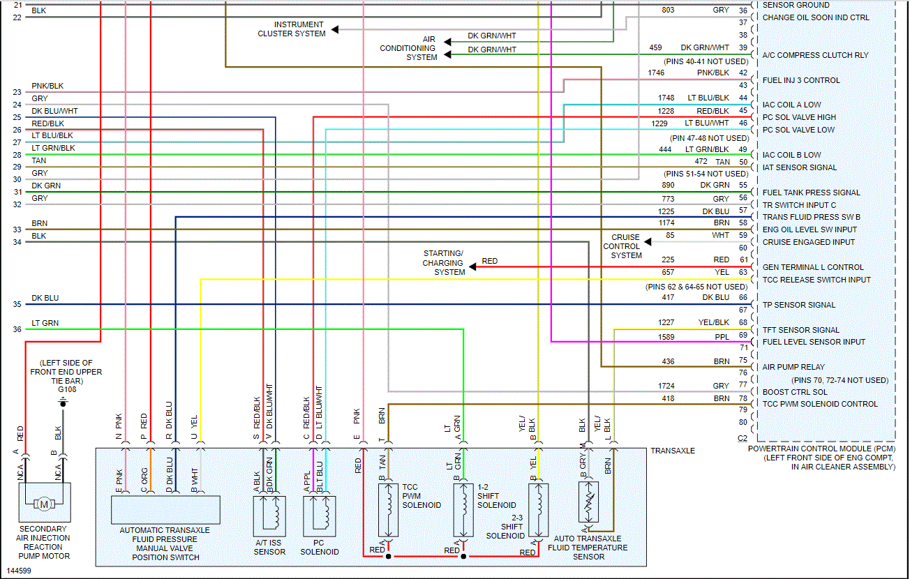

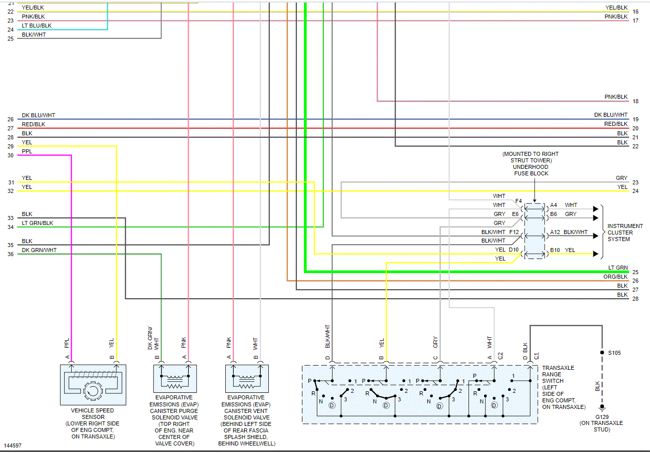

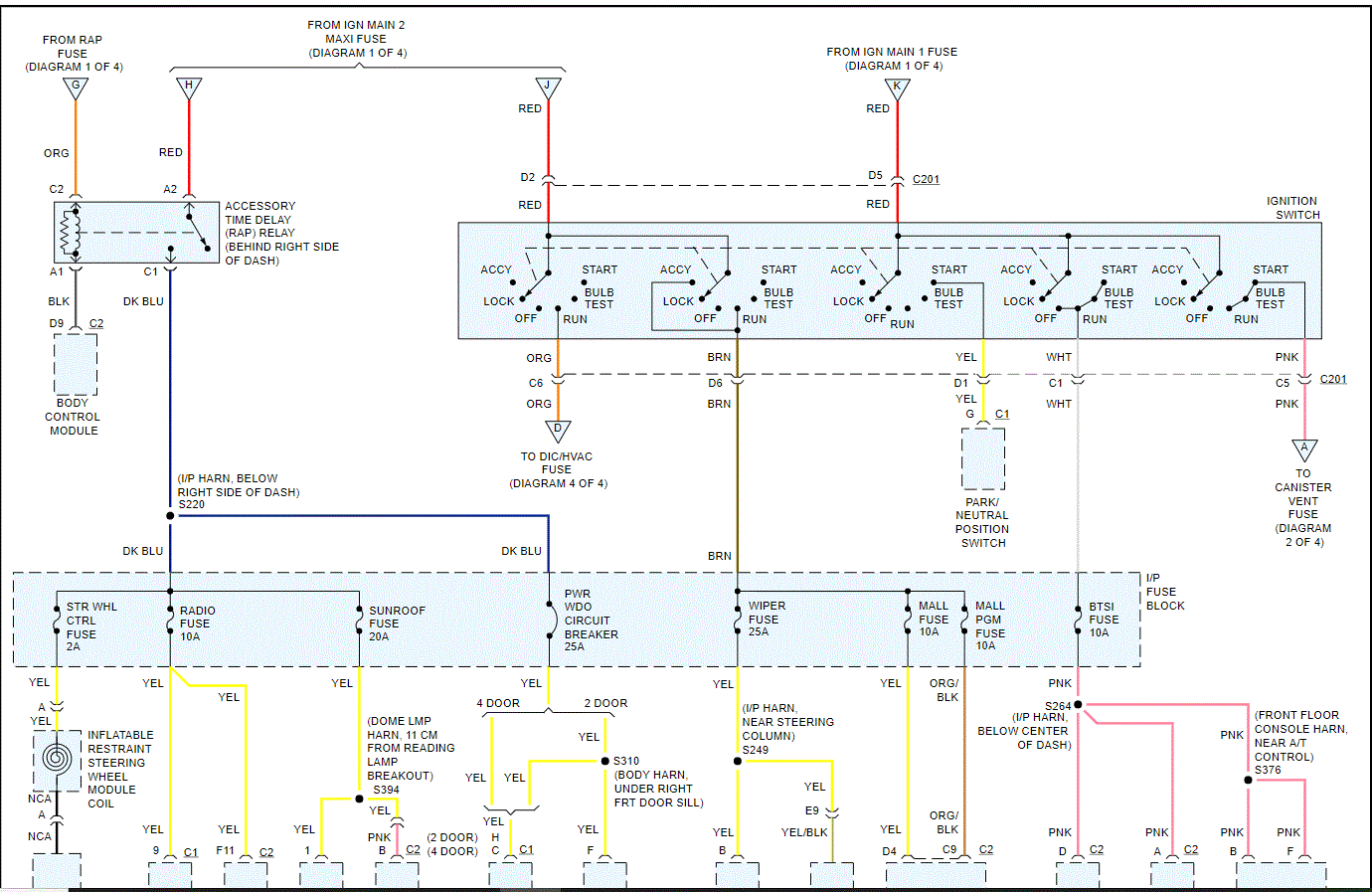

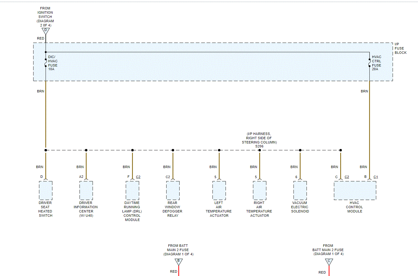

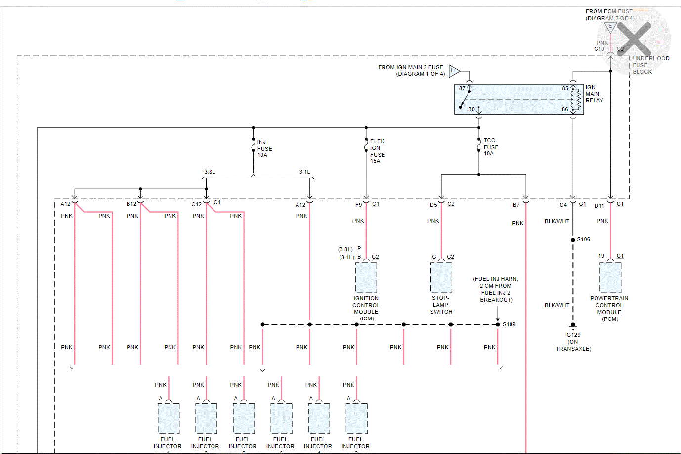

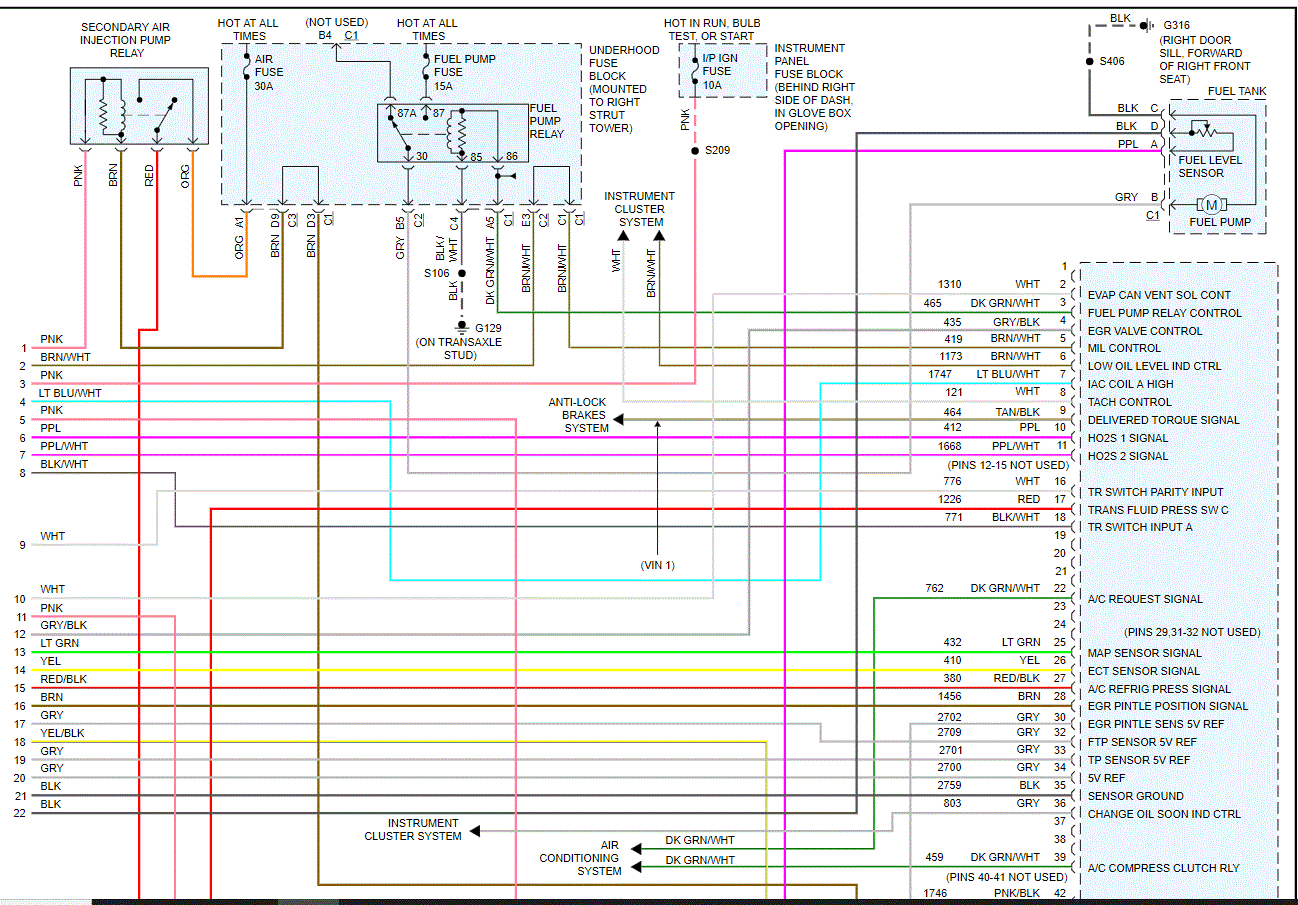

If you look at the pics below, I included the entire powertrain management wiring schematic. I had to cut the pics in half to make them readable for you. However, I did overlap them so you can follow them easier.
Here is a link you may find helpful while doing the repairs:
See pics below

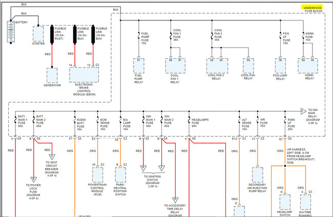

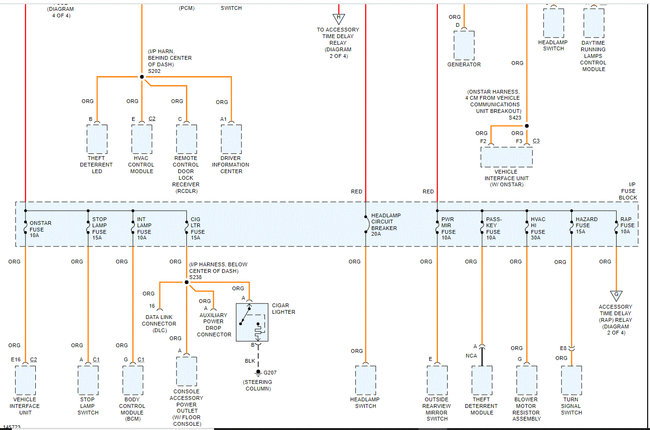

I need the pinout for Under hood fuse block.

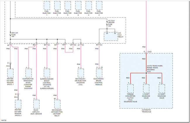

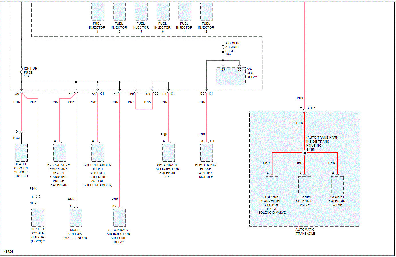

The best I'm going to be able to do is a power distribution schematic. I cut the pics in half to make them readable. I did overlap them so you can follow. What you have to do is pay attention to where the power supply leads. The first pic shows a portion of the fuse box but if you continue following, it jumps to other areas in the box. It also includes the IP fuse box.
I hope this helps. Let me know.
