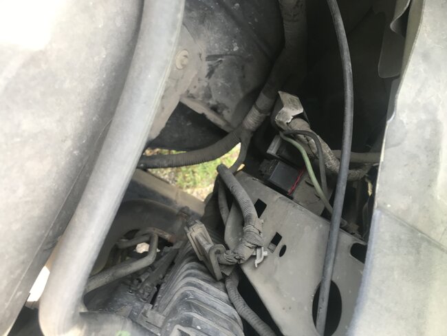

This one is a doozy…
40,000on new engine.
Drove to work in the morning fine. Started vehicle in the hot afternoon and the overdrive light was blinking, vehicle went into limp mode and ran rough. No recent repairs were done or anything out of the ordinary.
Found out that fuse 32 kept blowing. I was told to unplug everything related to fuse 32 and see if the fuse would still blow. Then plug everything back in one by one and checking if fuse blew.
I haven’t started unplugging anything yet. Wanted to get your input.
Fuse 32 starts with the catalyst monitor sensors in the photo.

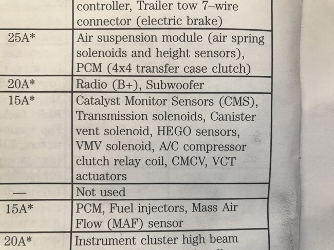

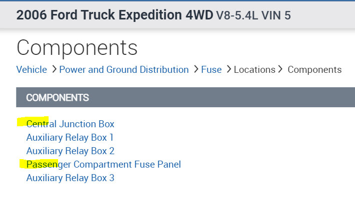

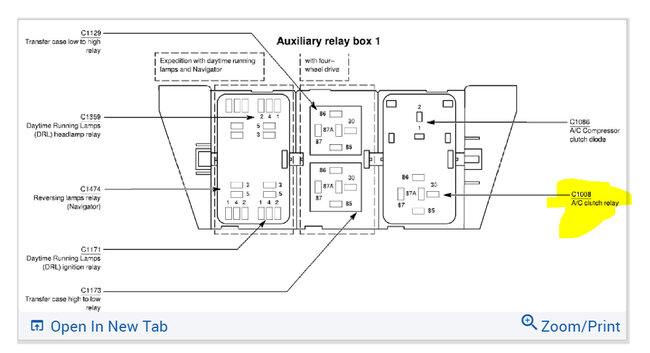

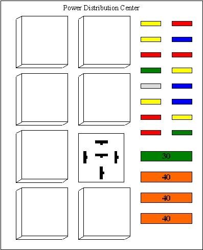

Wow, that fuse powers a million things. (Pic 1 below). Does it blow as soon as you install the new fuse or does the key need to be turned on? Also, since it was hot, chances are the AC was on. Do me a favor. Remove the compressor relay and see if the fuse still fails.

Thanks for getting back to me Joe. The vehicle needs to start for it to blow. It won’t blow with just key in the ON position. Also, where is the relay you’re referring to on the vehicle? I don’t have anything that looks like that diagram. It’s a 2006 expedition and there’s only one fuse box that’s below the glove box .

We can skip the relay since it doesn't fail until the key is in the start position. Just to confirm, the fuse fails when the key is turned to the start position, correct?
If the fuse fails after you release the key, we need to start disconnecting one thing at a time that the fuse powers. If it fails as soon as it is in the start position, it will likely be related to the starter circuit.

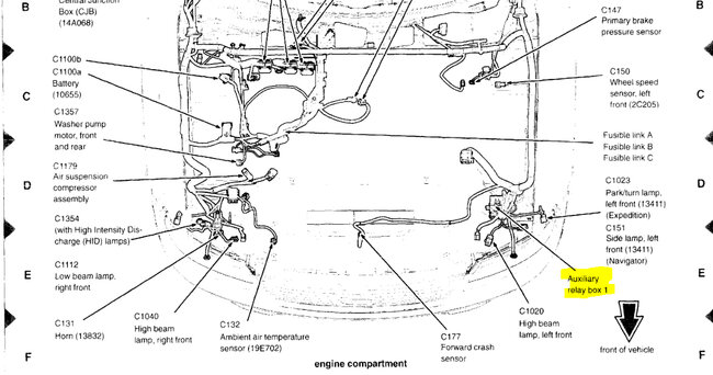

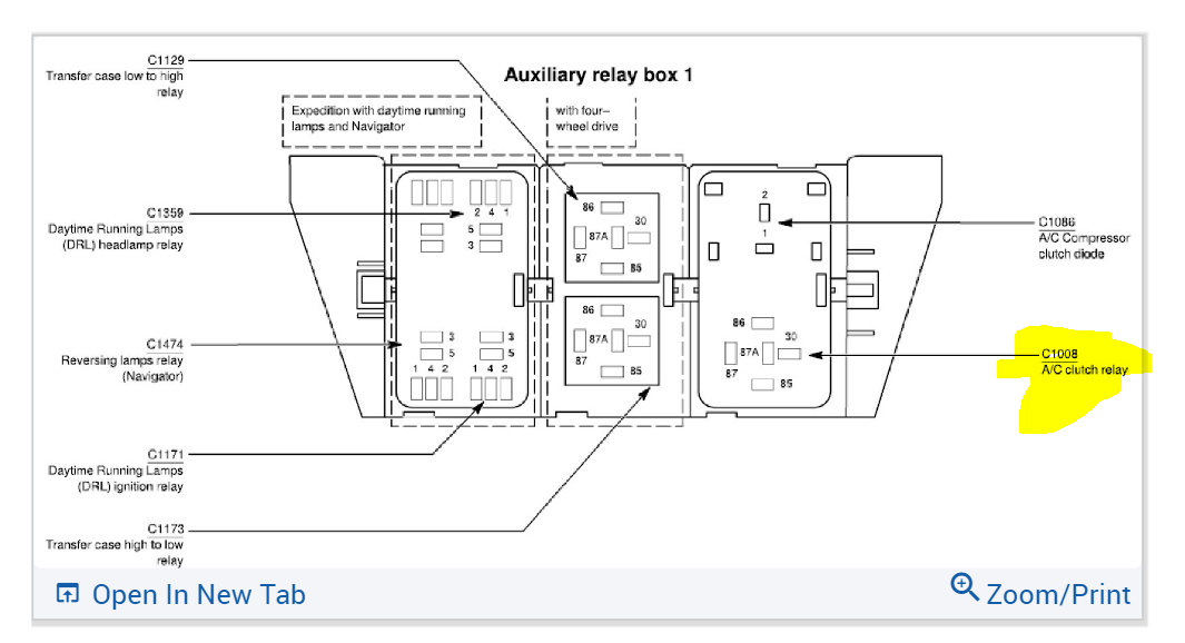

As far as the auxiliary junction box, see pic below for the location. It's on the driver's side front.
Let me know. Sorry for more questions, but I'm trying to narrow things down.

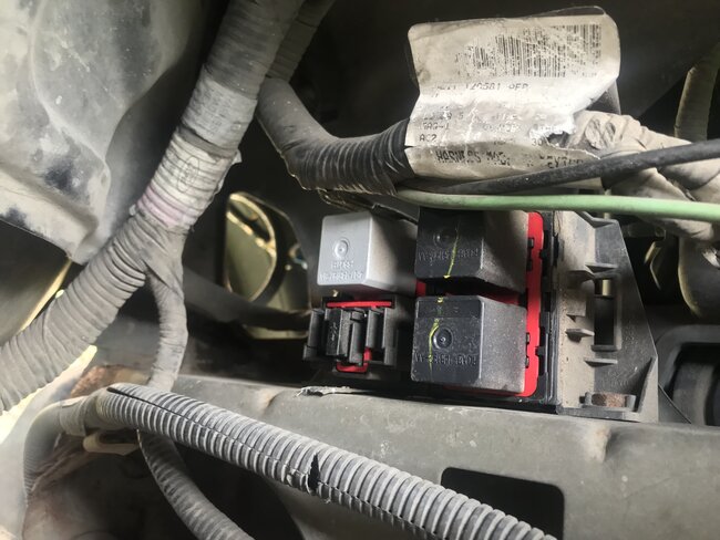

I double checked and found that the fuse does blow when key is in the on position and not start/run position.
Also, i took pics of what i thought was the box you were referring to, but it did not look like the original picture you sent, so I wasn’t sure where the ac relay was. And there were no markings on the cover to indicate either.
As far as unplugging everything one by one, can you send me the diagrams of where everything is? I know where the oxygen sensors are but some of the other things i don’t know.

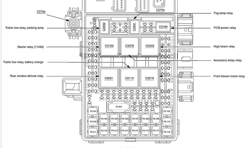

Is the ac clutch relay the grey relay in the photo i sent?
Jun 4, 2023 at 6:36 AM
  • 110,240 POSTS
It appears to be the relay. Isn't it interesting how they hide things? Ugh!!!
Do me a favor. Remove the relays in the CJB and see if it still fails. The relays are what actuate several things related to the fuse.

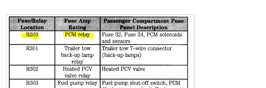

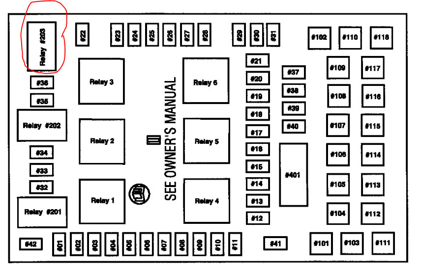

I have a question. My manual is showing two fuse boxes. One is the central junction box and the other is identified as passenger compartment fuse panel.
If you look at pic 2 below, that is the passenger compartment fuse box. If you have that, remove the relay that I circled first. Pic 3 is what I'm finding.
See pic below.

I removed all relays in the CJB and fuse still failed. I removed relay #203 you circled from passenger fuse box and fuse did not blow. I believe r203 supplies power to f32 correct? So, it wouldn’t matter if I removed r203, right?

Actually, the fuse supplies power to the relay. Switch that relay with a different one having the same part number. See if that makes a difference. See pic 1 below.

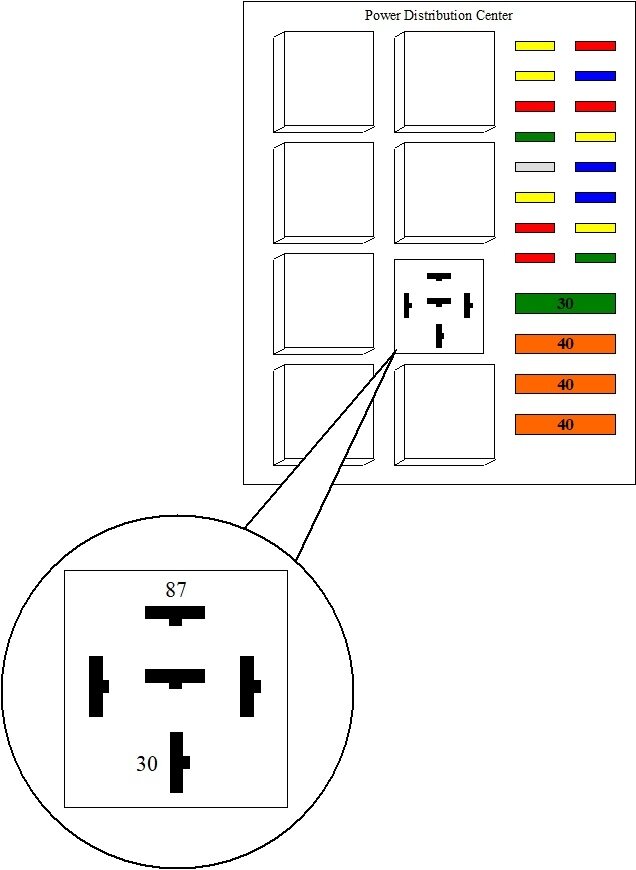

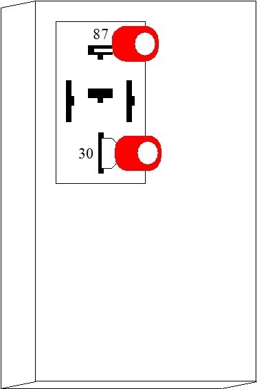

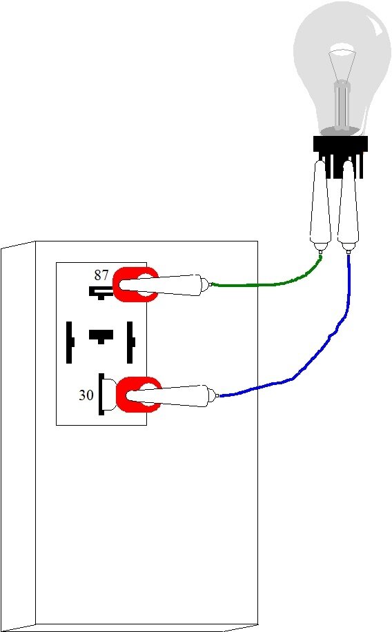

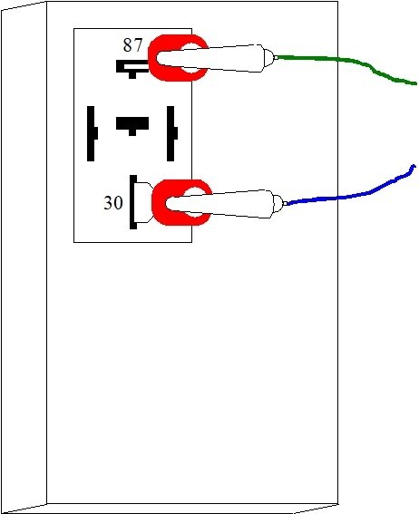

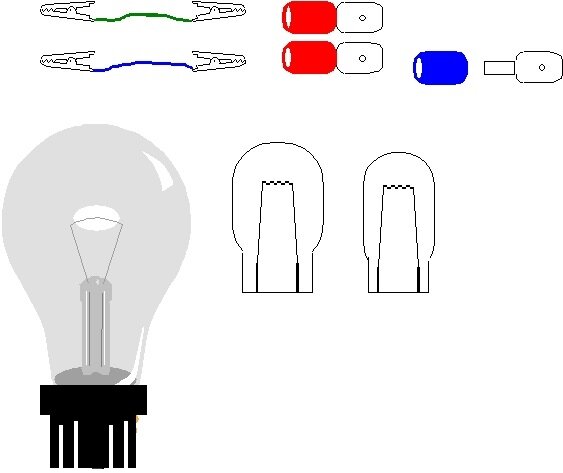

Hi guys. I've been vibrating in my seat waiting to learn the solution, but I see you've been wasting a lot of fuses. Please allow me to add my trick that will solve that. Use a light bulb in place of that fuse. All that will happen is when the short is present and the circuit is powered up, the bulb will be full, normal brightness. It will get hot so be careful where it's laid, and it will limit current to a safe value. My drawings show using a common 3157 brake light bulb. That will allow up to one amp to flow. Once the short is removed, the bulb will get dim or go out and the circuit will resume trying to work. If the bulb limits current too much, you can use a head lamp bulb instead. That will allow up to five or six amps to flow.
While this works great for fuses, I'm posting the procedure for bypassing a relay instead. I see a lot of mention of that. By bypassing the relay instead of the fuse, you usually can power the circuit without needing to turn on the ignition switch or do anything needed for that relay to turn on. I made these drawings over-simplified, but that's easier than trying to describe what to do. You do have to install a good fuse.
Joe can elaborate on where to find the items I listed, and which relay terminals to use if yours look different than those in the drawings. You can do this just as easily at the fuse socket too if you prefer. I hope this will help you guys figure this out.

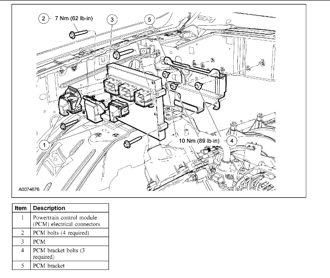

I’ve got all the 02 sensors unplugged, but i need help locating everything else.
Jun 10, 2023 at 10:18 PM
  • 110,240 POSTS
I attached a pic of the PCM below. Before you disconnect the module, disconnect the battery negative cable. Also, disconnect the battery before reconnecting the module.
