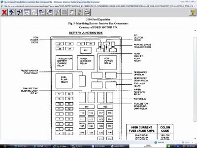

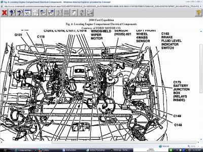

My rear compartment 12 volt adapter plug-in (cigarette lighter type) blew out when a fualty power converter adapter was plugged in. I can not find which fuse to replace. My owners manual does not show me the location in the fuse block area under the passenger side dash board. Can you help me locate it?
Feb 15, 2008 at 2:30 AM
MERLIN2021
  • 17,250 POSTS
It's the #1 fuse in the battery junction box near the master cylinder.
