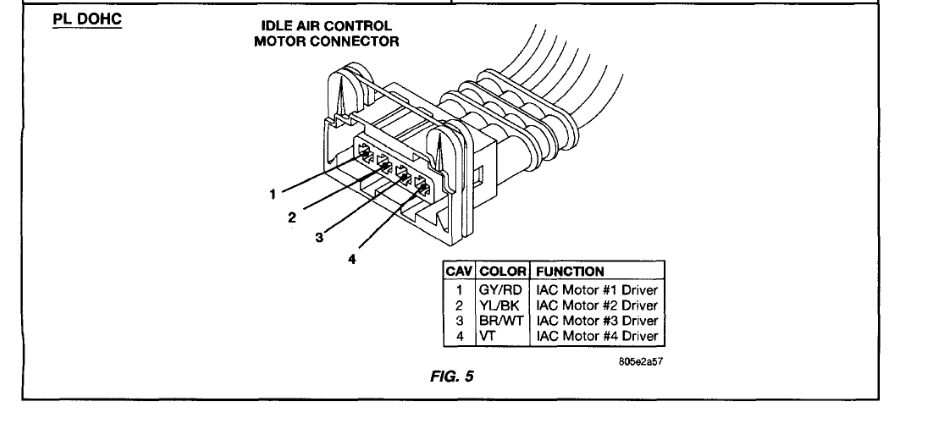

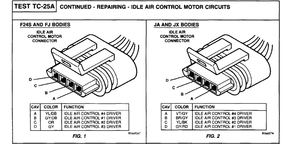

Car listed above SE model. Having trouble keeping it running. Have replaced the fuel pump relay, pump and filter. Turn key to accessories can hear the pump, car starts for 5 seconds or so then shuts off. Turn key off, back to acc then to start and it will run again but always shuts off. Any ideas?
Wednesday, July 24th, 2019 AT 6:34 AM
21 Replies
SCGRANTURISMO
  • 4,897 POSTS

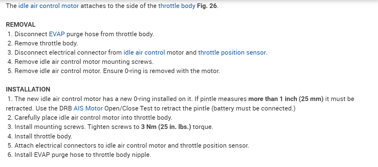

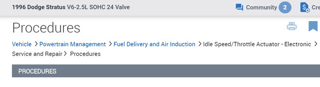

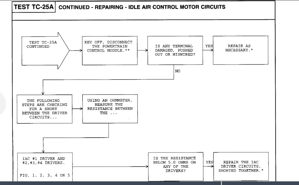

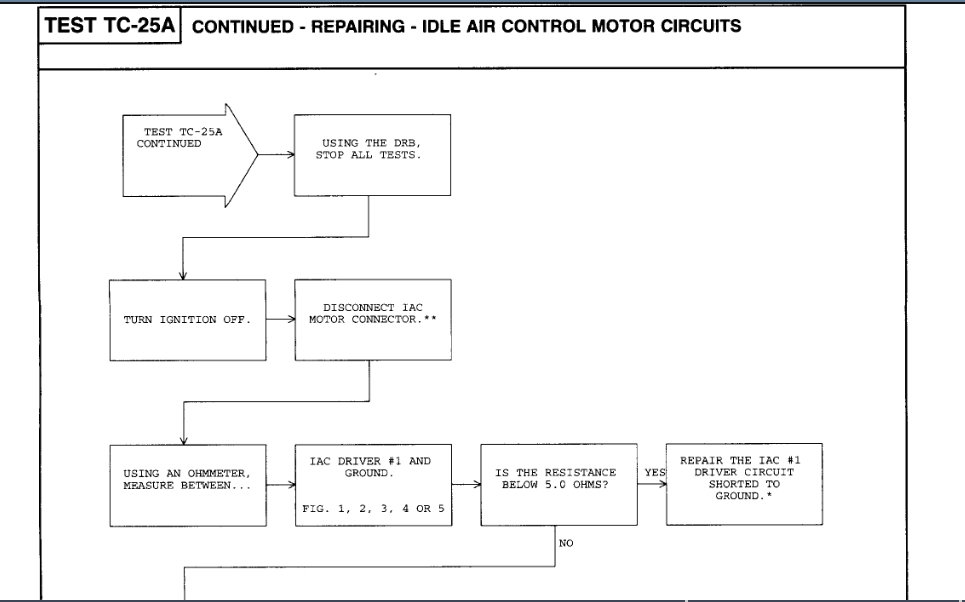

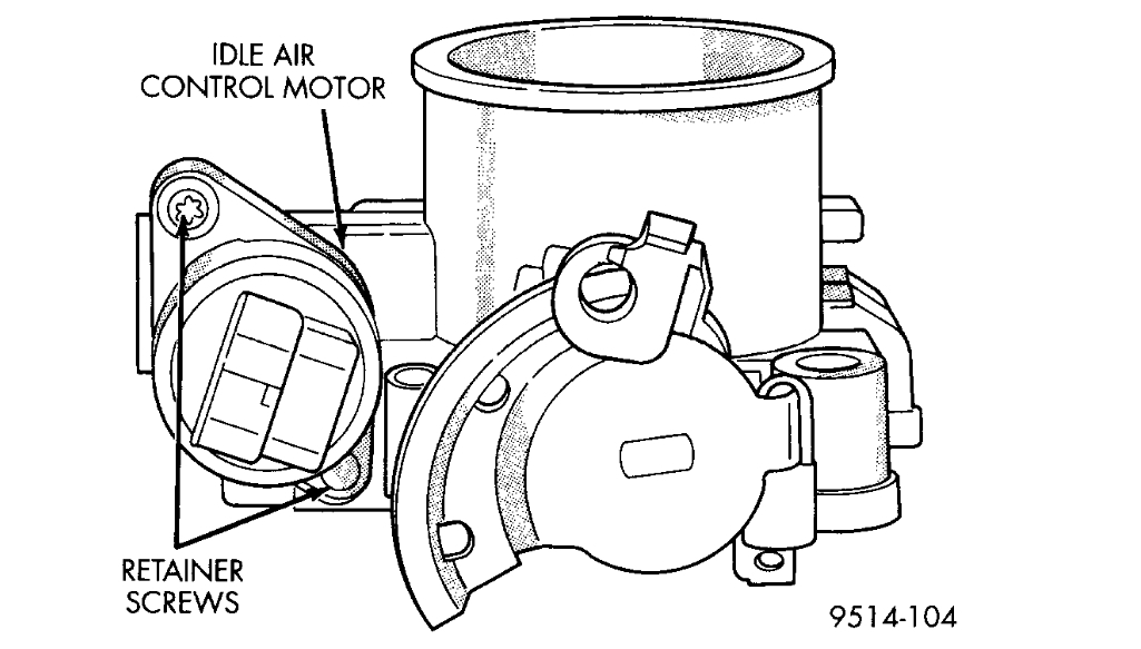

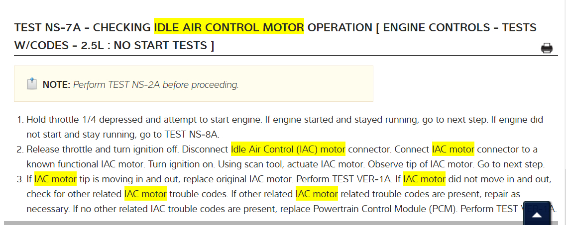

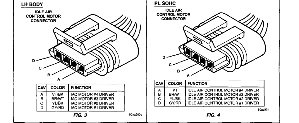

This could be a problem with your vehicle's Idle Air Control valve motor (IAC). This valve is what allows the air to go around the closed throttle plate when the vehicle is it at idle. In the diagrams down below I have included factory diagnostic troubleshooting guide for testing your vehicle's IAC as well as instructions for the removal and installation of the IAC. Please go through these guides and get back to us with what you are able to find out.

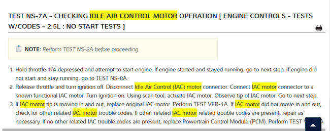

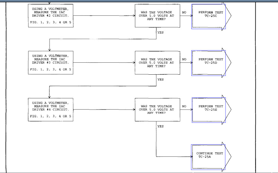

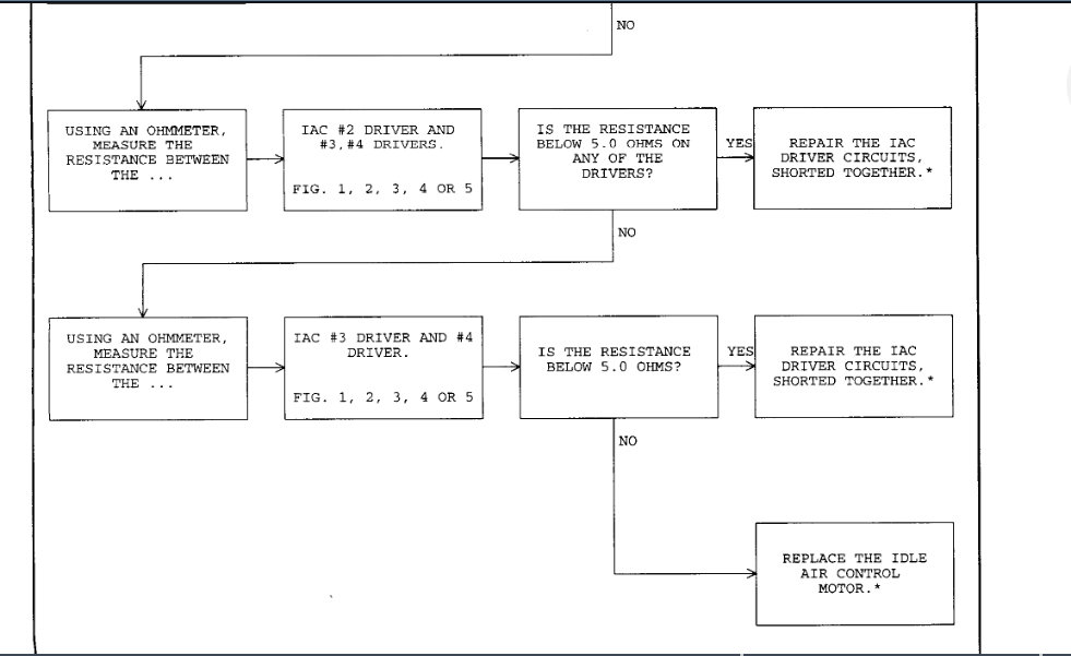

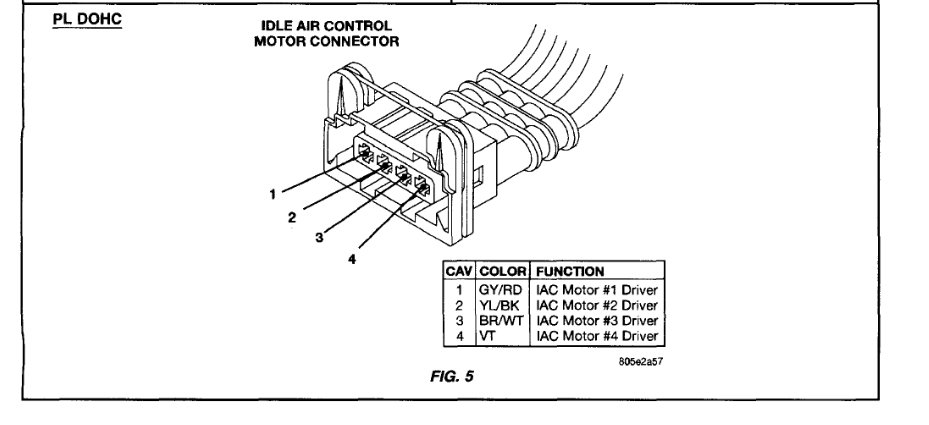

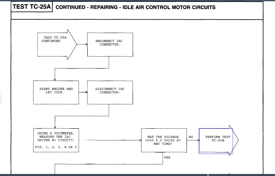

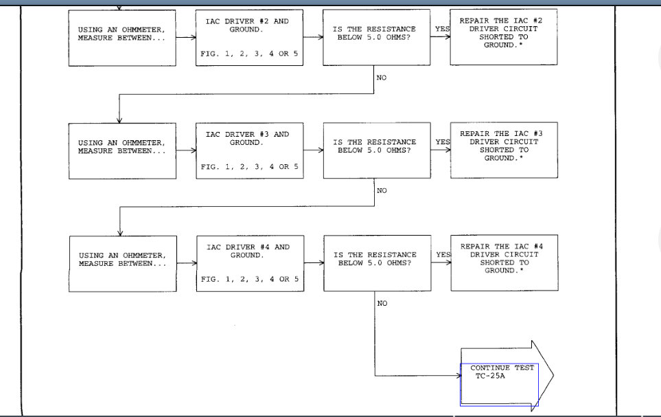

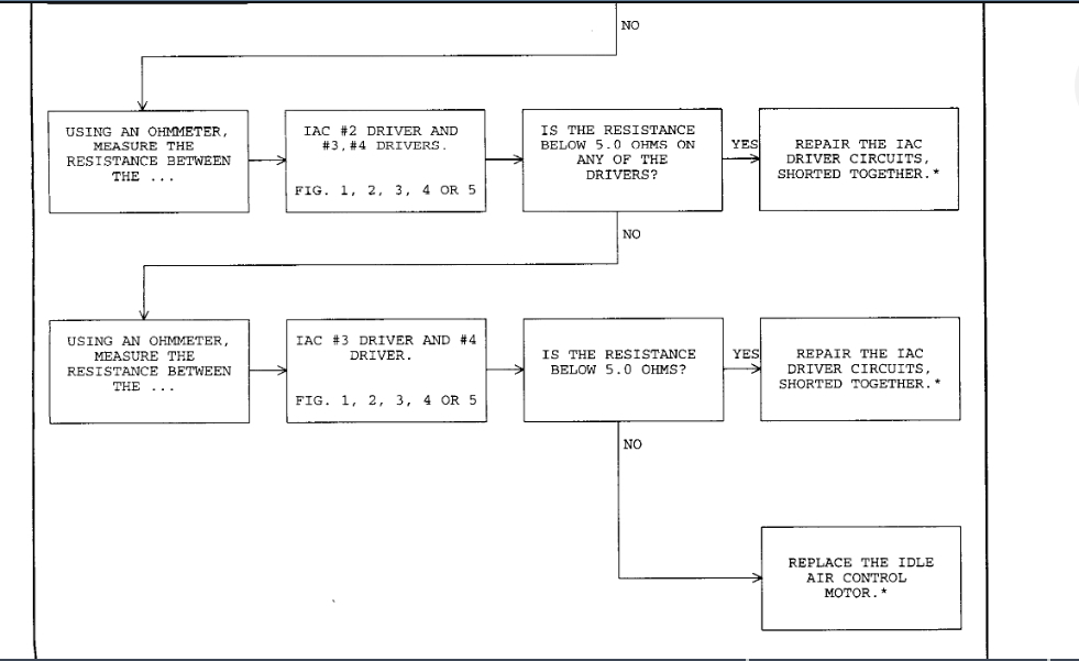

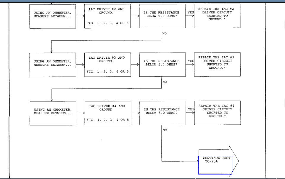

I also do not show Direct Trouble Code(DTC) P1768 in the list of DTC's for your vehicle in either of the reference guides that we use. The actual DTC is for a problem with the Lock Up Solenoid of an Automatic Transmission. In the diagrams down below I have included a more extensive diagnostic troubleshooting flowchart to test your vehicle's Idle Air Control valve(IAC). You will need to use a multimeter to do these tests, so I have included a link below, if you are unfamiliar with how to use one.
Please go through these flowcharts and get back to us with what you are able to find out.
Thanks,
Alex
2CarPros

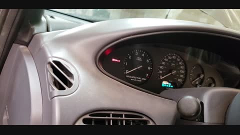

Still having trouble with my 1996 dodge stratus. I have replaced the following :
Fuel pump relay
Fuel pump
Fuel filter
IAC
I am trying to attach a video of what it's doing. I appreciate any help.

I have added fuel and still have the same results. I will try and upload a video again today. Any other ideas of what may be wrong with my stratus?
The list of replaced items continues to grow :
Fuel pump relay
Fuel pump
Fuel filter
IAC
it will fire... Run for a couple seconds and then shuts down.

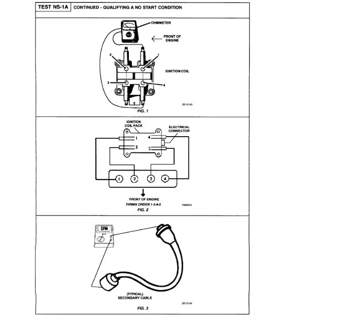

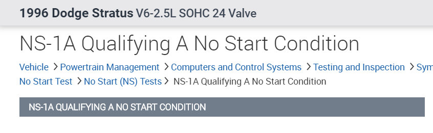

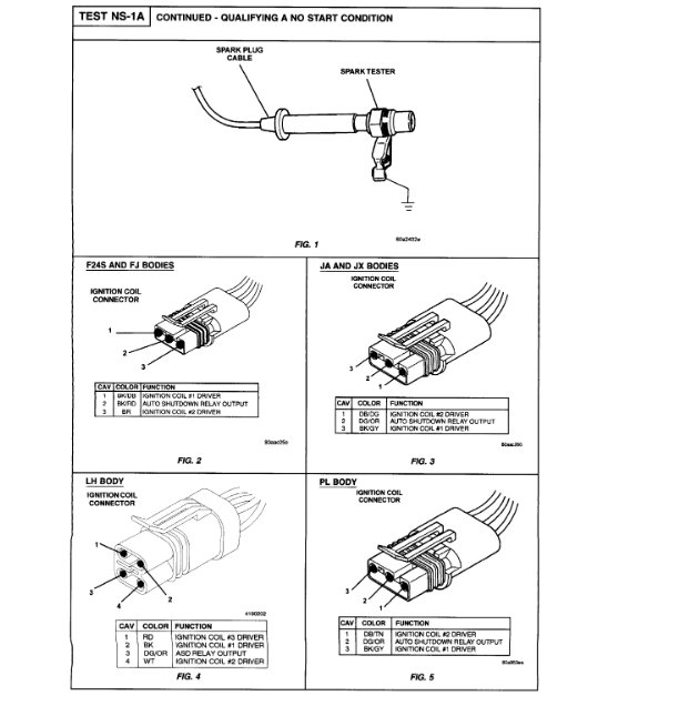

SCGRANTURISMO
  • 4,897 POSTS

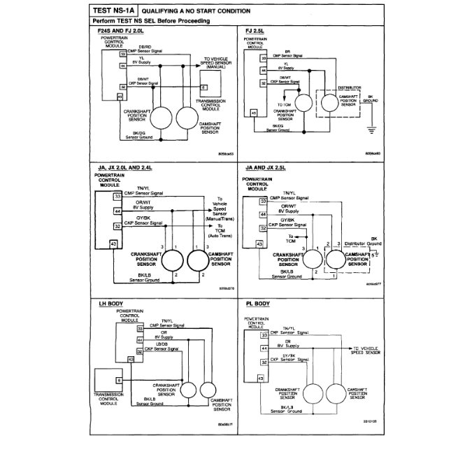

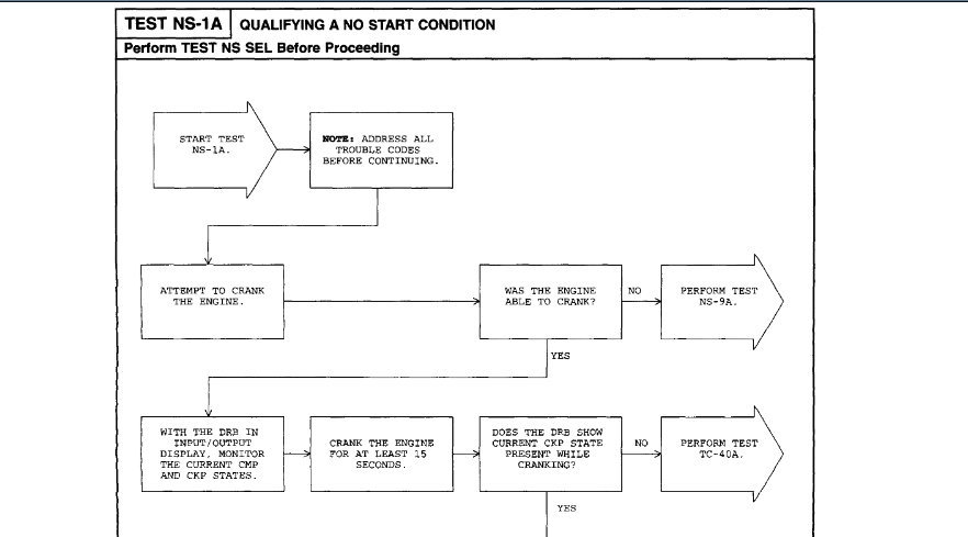

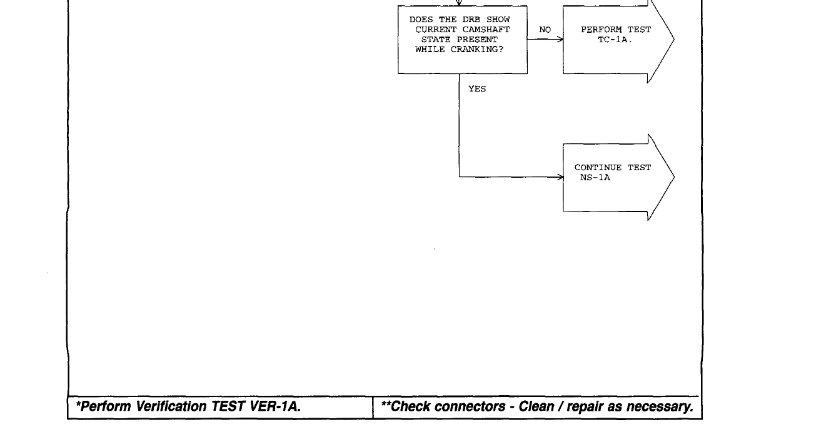

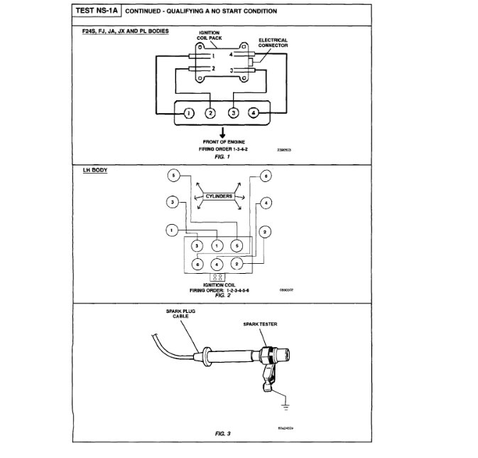

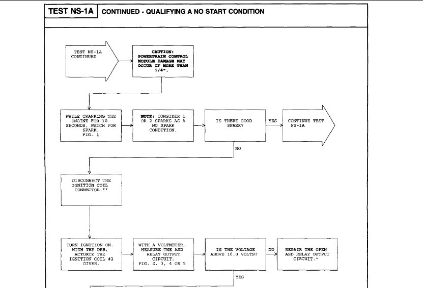

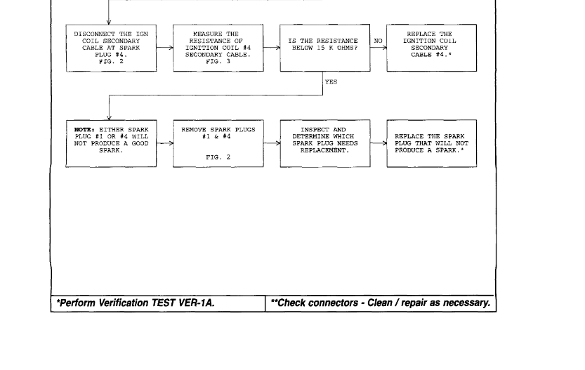

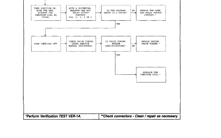

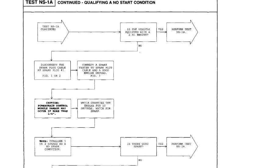

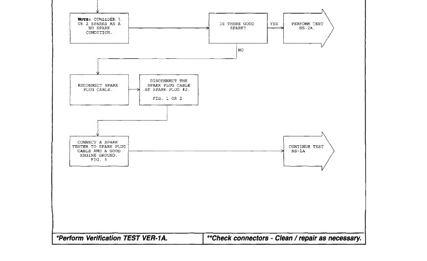

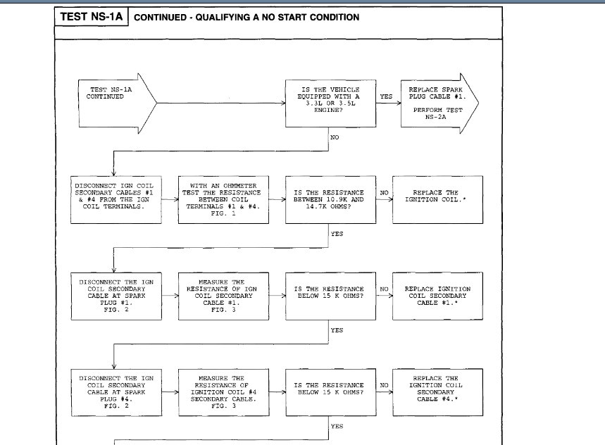

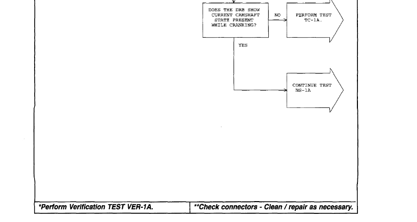

Okay, We will get this tracked down one way or another. So here is the first 17 no start diagnostic troubleshooting flowchart tests that Dodge gives it's factory trained techs to track down the specific cause of a no start condition. Please go through the guide and get back to us with what you are able to find out. We will go from there. Please be patient, work with us, and we will get this figured out.
Thanks,
Alex
2CarPros
Wednesday, July 31st, 2019 AT 12:01 PM
DOCFIXIT
  • 18,828 POSTS

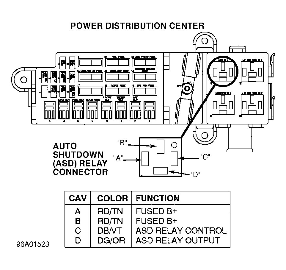

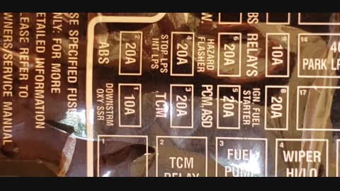

Hey if I may. Have you considered auto shut down relay?
Wednesday, July 31st, 2019 AT 3:08 PM
JLITKE
  • 11 POSTS
Doc; I didn't even know it had a Auto shutdown relay. I will find it and have it tested.
Wednesday, July 31st, 2019 AT 3:24 PM
DOCFIXIT
  • 18,828 POSTS
Yes, they have a history of causing trouble. In power distribution center should be labeled or owners manual (excuse me while I laugh)

ASD on a fuse. Runs like a champ, thank you all for your help.
Thursday, August 1st, 2019 AT 6:26 PM
DOCFIXIT
  • 18,828 POSTS
So you pulled fuse and replaced it runs? Then relay must have intermittent fail?
Friday, August 2nd, 2019 AT 8:47 AM
JLITKE
  • 11 POSTS

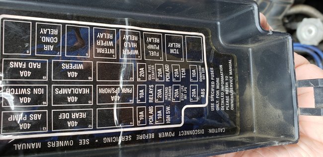

I have looked at the schematic for the relay and I cannot find a ASD relay anywhere, just ASD on a fuse. I will send a photo of the under hood box and maybe you will see something I don't.
Thank you,
Jeff
Friday, August 2nd, 2019 AT 9:08 AM
JLITKE
  • 11 POSTS
Thank you
Jeff
Friday, August 2nd, 2019 AT 7:09 PM
JLITKE
  • 11 POSTS
Any ideas of where the ASD relay may be other than underhood? I just find ASD attached to a fuse.
Sunday, August 4th, 2019 AT 8:25 AM

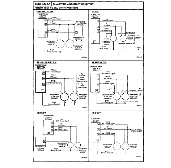

DOCFIXIT
  • 18,828 POSTS
See diagram
Sunday, August 4th, 2019 AT 12:49 PM
JLITKE
  • 11 POSTS
Doc, I had no idea there were relays in that. I changed out the ASD relay just encase the original was weak. Thank you for all your help in getting my commuter back on the road.
