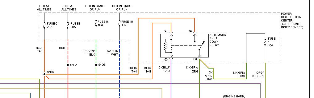

HMAC300
  • 48,601 POSTS
Automatic shutdown relay see pic and look for corrosion on this as well
