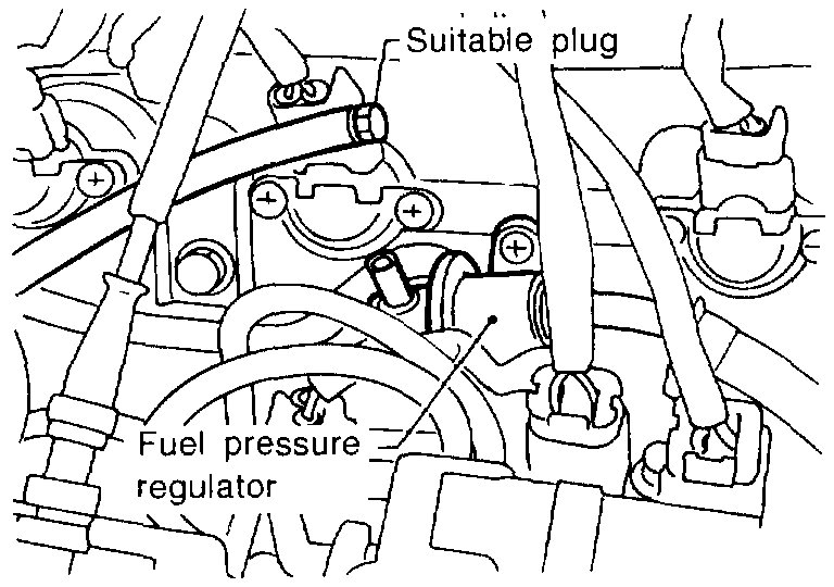

Bad injector stuck open gas pours into cylinder non stop. The other three seem okay. Now my question is, how do I tell if the fuel regulator is okay? Is there anyway to tell a simple test or do you need special diagnostics tools? I am already in the red fixing this truck and do not have much more to spend on it. Thanks to everyone who has come to help. Everyone has been great. This site is by far the best for DIY mechanics. Thanks again. JC
Nov 16, 2018 at 7:44 PM
  • 110,194 POSTS
Welcome back, JC
The regulator on your truck is vacuum operated. To check it, you need to do a fuel pressure test and basically disconnect the regulator to see if things change. I will tell you that often times when they fail, it will draw fuel into the vacuum hose, so pay attention when you remove it.

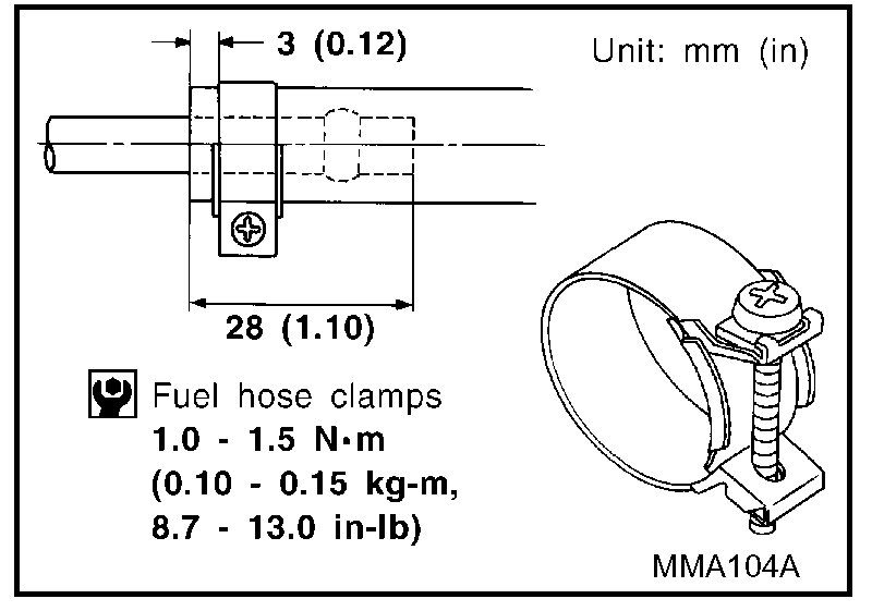

FUEL PRESSURE CHECK
PROCEDURE
(pic 1)
a. When reconnecting fuel line, always use new clamps.
b. Make sure that clamp screw does not contact adjacent parts.
c. Use a torque driver to tighten clamps.

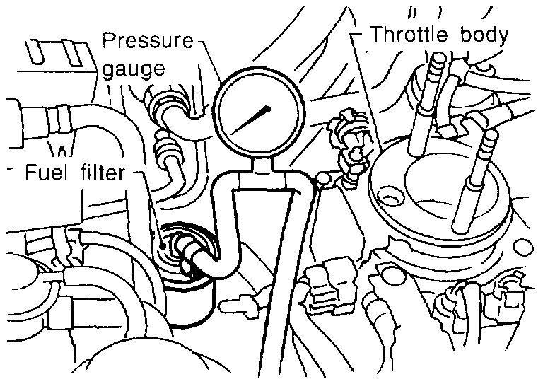

d. Use Pressure Gauge to check fuel pressure.
1. Release fuel pressure to zero.
2. Disconnect fuel hose between fuel filter and fuel tube (engine side).
(pic 2)
3. Install pressure gauge between fuel filter and fuel tube.
4. Start engine and check for fuel leakage.
(pic 3)
5. Read the indication of fuel pressure gauge.
At idling: Approximately 235 kPa (2.4 kg/sq. cm, 34 psi)
A few seconds after ignition switch is turned OFF to ON:
Approximately 294 kPa (3.0 kg/sq. cm, 43 psi)

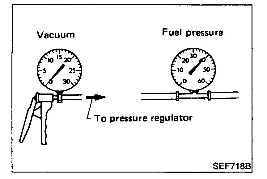

6. Stop engine and disconnect fuel pressure regulator vacuum hose from intake manifold.
(pic 4)
7. Plug intake manifold with a rubber cap.
8. Connect variable vacuum source to fuel pressure regulator.
9. Start engine and read indication of fuel pressure gauge as vacuum is changed.
Fuel pressure should decrease as vacuum increases. If results are unsatisfactory, replace fuel pressure regulator.

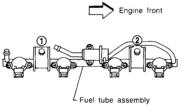

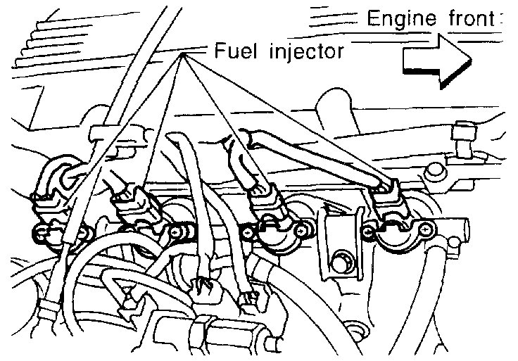

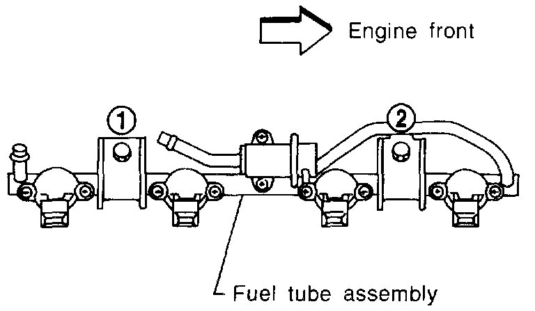

If you find the regulator is good and the injector needs replaced, here are the directions. The remaining pictures correlate with these directions.
INJECTOR REMOVAL AND INSTALLATION
PROCEDURE
2. Remove injector tube assembly with injectors from intake manifold.
(pic 5)

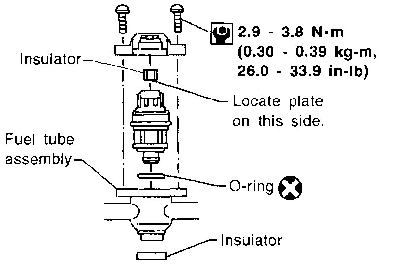

3. Remove injectors from injector tube assembly.
- Push injector tail piece.
- Do not pull on the connector.
(pic 6)
4. Install injector to fuel tube assembly.
a. Clean exterior of injector tail piece.
b. Use new O-rings.
Always replace O-rings with new ones.
Lubricate O-rings with a smear of engine oil.
5. Install injectors with fuel tube assembly to intake manifold.
Tighten in numerical order shown in the figure.
a. First, tighten all bolts to 9.3 to 10.8 N.m (0.95 to 1.1 kg-m, 6.9 to 8.0 ft-lb).
b. Then, tighten all bolts to 21 to 26 N.m (2.1 to 2.7 kg-m, 15 to 20 ft-lb).
(pic 7)
6. Install fuel hoses to fuel tube assembly.
7. Reinstall any parts removed in reverse order of removal.
CAUTION: After properly connecting injectors to fuel tube assembly, check connections for fuel leakage.

Chances are you damaged the o-ring or it did not seat properly. I would take it apart and check. I would not replace all the injectors, but replacing the o-rings is cheap. Also, I always lubricate the o-rings with petroleum jelly before I put it together. That way it has less chance of damage.
I attached a picture of the injector and o-ring.
Let me know if this takes care of it. Keep in mind, the smallest nick in the o-ring can cause a leak because of the pressure they are exposed to. Additionally, make sure everything is tightened as per the prior post.

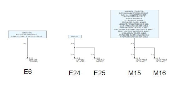

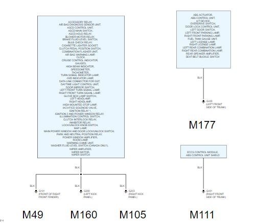

Hi Joe, I got a question it may sound stupid what I am going to ask but while working on getting the engine back into the truck and all the wires and hoses put back in their correct places I forgot to reattach the ground strap engine to frame/body. Would this make the injectors go nuts? To let you know what I am doing I am pulling the fuel rail out of the intake and turning the key to on position. This the spraying from the injector. Now after attached the battery ground. And engine ground. I turned on the key and much to my surprise no spraying injector is this crazy or am I on to something? When cranking the engine it idles great but at about 2,000 RPM holding the gas pedal steady the engine surges up and down like it has a fuel problem. So it is like were the injectors problem solved or not. And I smell raw gas. But no gas is coming out of the exhaust manifold like it was when the injector was stuck. So if you can figure this out I would sure like to hear your opinion. Thanks Joe. JC
Nov 27, 2018 at 7:15 PM
  • 110,194 POSTS
Welcome back, JC:
Electric is really interesting. It will always find the easiest way out. Thus, if you remove the primary ground, it will try to find the next easy ground. As a result, all kinds of things happen. Lights can come on when they should not, gauges can function when they should not, and I am sure injectors can get power when they should not.
Now, you should not smell raw fuel. Any fuel leak is dangerous. Recheck the injectors to make sure the o-rings are not leaking. It is really easy to nick one when installing.
As far as the idle, it too can be related to ground issues.
I attached two pictures/schematics of the grounding locations. Electrical components are listed and their ground location is also indicated. Thought this would help.
Let me know if you have other questions. Make sure to locate where the raw fuel smell is coming from. Also, check the o-rings on the injectors for leaks. By the way, no question is stupid. This was a very logical question.

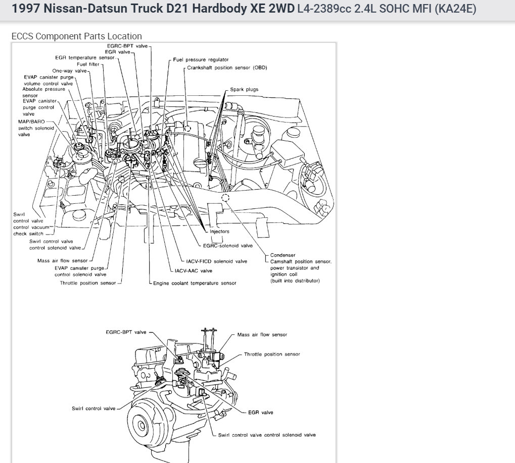

Hello Joe, You may be on to something. It did not cross my mind to check the gas filter going to fuel rail. Though I do know it has gas flow after the filter because of the injectors issue I was having gas was coming through plenty. I personally think it is vacuum related. There is still one hose that has not been installed it got thrown away and possibly may make a difference. Though it is not a vacuum line I do not think it has vacuum. But not sure. It has a vent hose runs from bottom of intake to timing chain cover. A little metal box with one inch nipple. Needs replacement. But brand new plugs after running five minutes are black with soot this makes me think to much gas. This is why I am smelling gas when I shut it off. It is exhaust fumes. Joe please help me figure this one out. You been a big help it has come a long way since you guys started helping me. Great team you guys are. Thanks, JC
Nov 28, 2018 at 4:18 PM
  • 110,194 POSTS

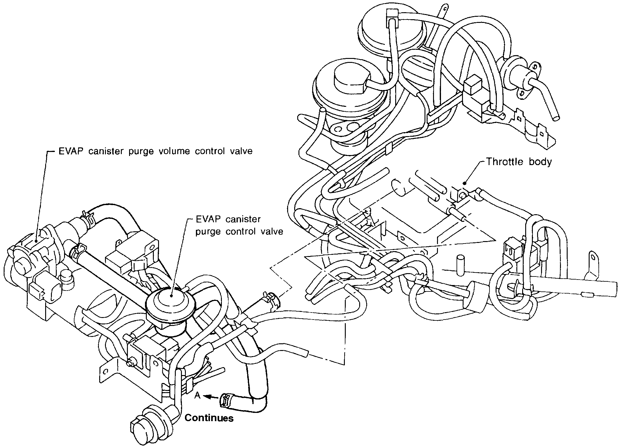

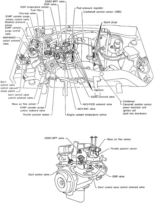

We need to figure out what hose is missing and what its purpose was.
I have attached a vacuum hose schematic for you to look at. Let me know if you can identify which hose is missing. Next, is a picture of a bad manifold absolute pressure sensor which is aprox where you said. See if that is what is missing the hose.
Nov 28, 2018 at 6:52 PM
JCLEMO
  • 161 POSTS
Okay, I will get on it tomorrow. I will try and send you some photos also. I put all vacuum hoses back where I thought they went to. The only one that has not been replaced is what I believe to be a crankcase vent hose intake to timing chain cover no hose. I will follow your photos and directions and let you know what happens. I am sure it is a hose. Thanks, JC
Nov 28, 2018 at 7:10 PM
JCLEMO
  • 161 POSTS
Hello Joe, I am checking the vacuum sensor the three hoses are connected. I do not think those were ever moved. But I noticed the ends of the hoses when I checked for cracks seemed to be a little wet with something.

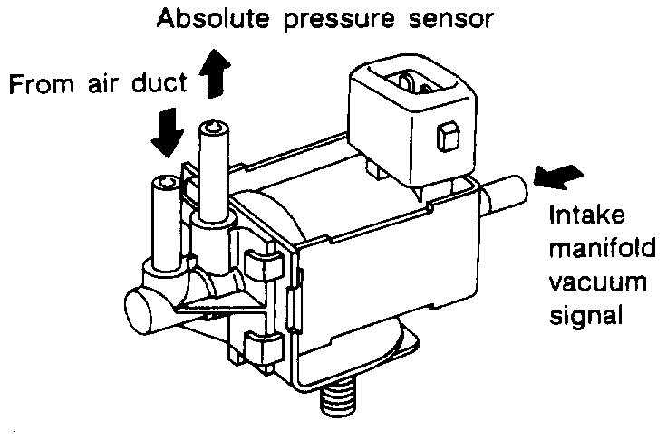

Let me know what you find. I am interesting in knowing. I have have a feeling there is an issue with the camshaft position sensor, which is built into the distributor along with other components. However, without a code, I cannot be sure.
Nov 29, 2018 at 5:20 PM

Yep, I would try a MAP and MAF sensors one at a time because if they are off it may not set a code. Check out the diagrams (below). Please let us know what you find.
