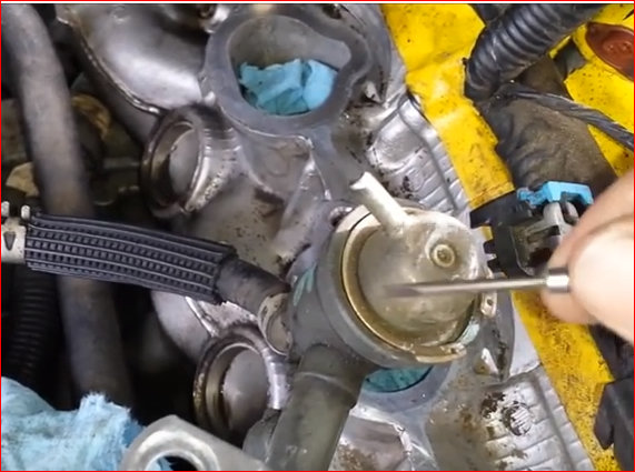

How do I fix a crack in the fuel regulator? I have the new part I just do not know how to take out the old one to put the new one in. Can Anyone help with this?

Do you have a picture of your new fuel pressure regulator? I have attached a photo and I am curious if it is the same style as in my picture. This type of regulator is located on drivers side near the firewall. If you have access to snap-ring pliers you just remove the snap-ring and lift out. Otherwise you can use a small flat-blade screwdriver to remove the snap-ring. Hope this helps and feel free to ask questions if needed. Thanks for using 2CarPros.
