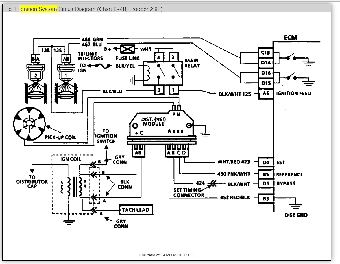

had a fire burnt the injectors connectors
1990 ISUZU TROOPER
190,000 MILES
WAYNE TOLBERT
i have new injector connectors and i need to know how to wire the new connectors. it is throttle body six cylinder. i have three blue wires one green from harness.
Sep 30, 2016 at 12:12 PM
  • 55,433 POSTS
Hi Wayne,
Fire bad! lol here is the wiring diagram you needed.
