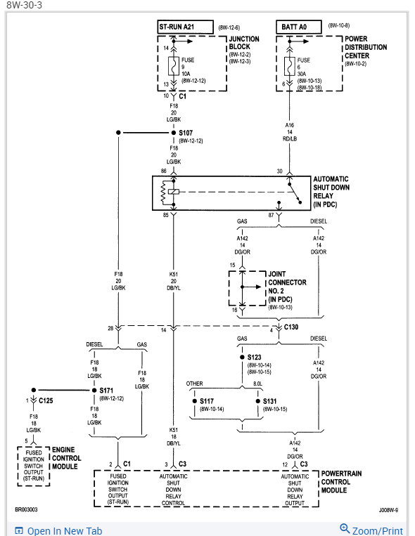

Truck starts first time every time intermittently the vehicle will shutdown. there is no power to the fuel pump when it has sat and cooled off truck fires back up and runs fine until next shutdown. I have replaced the fuel pump and relay. I believe there is something shutting off power at the ASD, but I don’t know what is coming into the relay. as a side note I have shot gas into the intake during the shutdown period and it will start up. any ideas? thanks

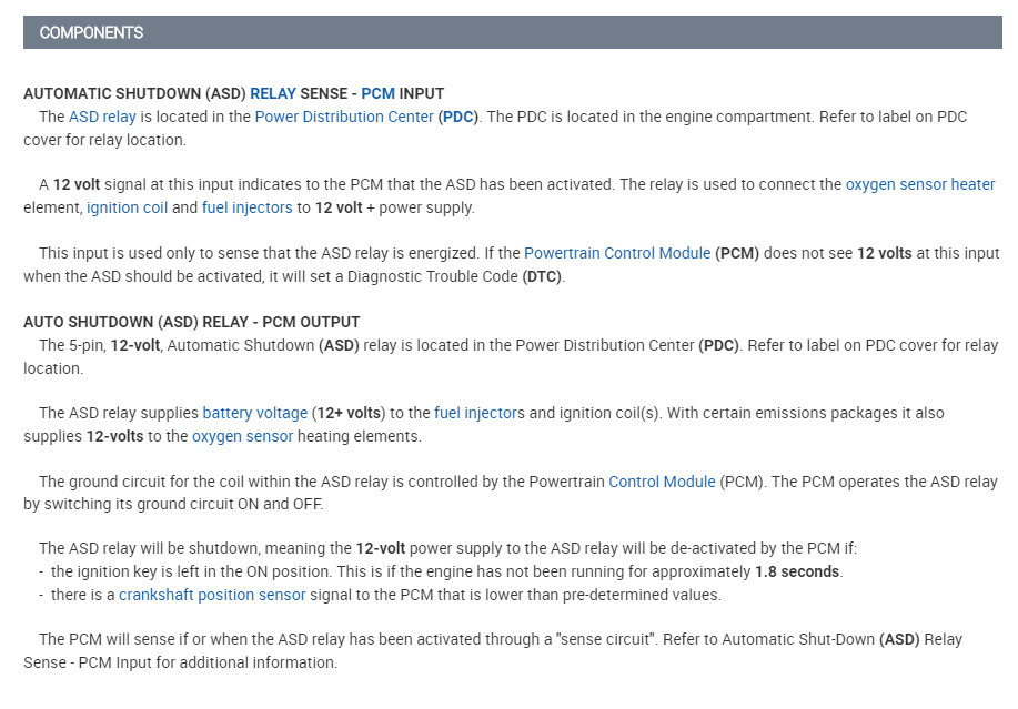

If the vehicle starts when this happening by just adding a fuel source then it is not the ASD. The ASD not only controls the injectors but it controls the ignition coils as well. Also, if the ASD shuts down the engine, it will set a code so we can confirm this by checking codes.
If this is just low pressure or no fuel, then I will guess you don't have any codes. However, let's go ahead and check for any codes just to be sure.
If there are no codes, then we need to hook up a fuel pressure gauge and find out what the pressure is when this is happening.

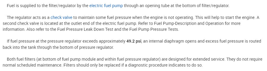

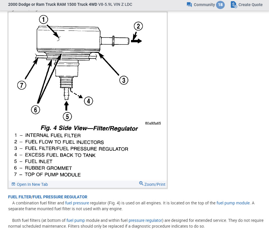

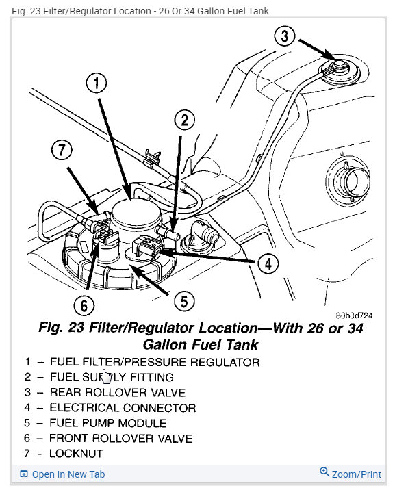

When you replaced the fuel pump, did that come with a regulator as well? I am thinking you have an issue with the regulator is it was not part of the pump. It sits on top of the pump and can be serviced separate.
Let me know if there are codes and if you put a new regulator on with the pump. Then get a PSI at the rail when this is happening, and I am sure we can figure this out. Thanks

I replaced the pump as a package that came with new regulator. no codes show up and I checked the PSI it is in the fifty’s. I am currently replacing the crank position sensor. I have a neighbor who races cars and does his own work. that this is a long shot but could be the problem. thanks for the help. I will get the part and install tomorrow.

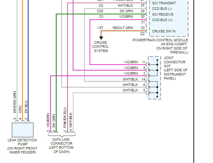

Okay, the guy that races brought his OBD ll over and hooked it up and discovered that there is no communication between it and the vehicle (I have a very cheap reader that is apparently not working). also I was incorrect in my analysis that only the fuel pump lost power during a shutdown there is also no spark to the plugs, we used the method you described when the vehicle cools down the spark returns is there any way to analyze the PCM for a fault.
Jun 25, 2019 at 12:36 PM
Unfortunately, I think the PCM holds the key to figuring out what the issue is because I suspect there is a code or at the very least we can see why the PCM is shutting down the ASD.
There may be an issue in the PDC as well. What I would suggest is to start with measuring voltage from the PDC to the ASD relay. If there is no voltage when this is happening then the PDC is the problem.
As for not communicating with the scan tool, you will need to follow the second wiring diagram and see what connection is open. The only way you don't have communication is if the DLC and PCM are not connected by the 4 wires shown. I suspect you have an issue with the joint connector shown.
