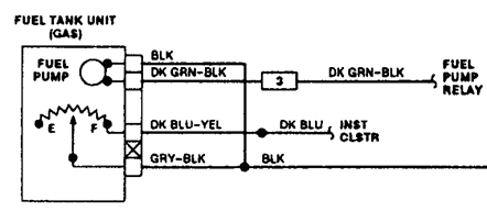

The gas guage does not work. I cut out an inspection hole out of the truck bed so I coule easily access the fuel pump. There are wires in the plug in ,on the top of the pump housing that screws on to the top of the tank. I need to know witch of the wires is the ground. I think if I reground the ground wire , the gas guage might work again,but I have to get the right wire color

Hello and thanks for donating! The ground wire will be the black colored wire from the fuel tank unit. If the wiring does not fix the problem then the unit is most likely faulty and will need replaced..
https://images.2carpros.com/forum/automotive_pictures/261618_Noname_1859.jpg
