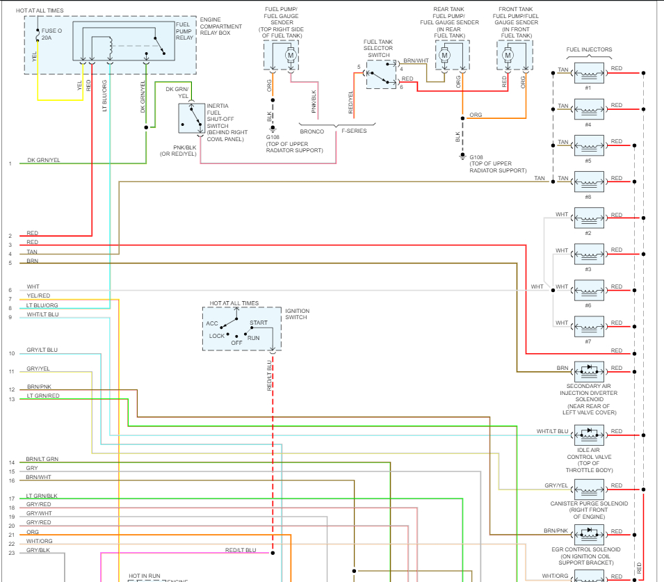

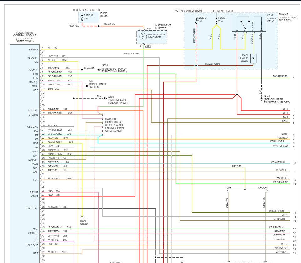

Hello, the fuel pump relay is not clicking in. I have right at 12 volts coming from fuel pump fuse but I'm only getting 3.5 volts from the PCM. The PCM is new. I can jump the relay and the fuel pump will run but still no start. I checked voltage at the injectors and I'm only getting 3.5 volts. Also, the PCM relay does click in, both relays are new.

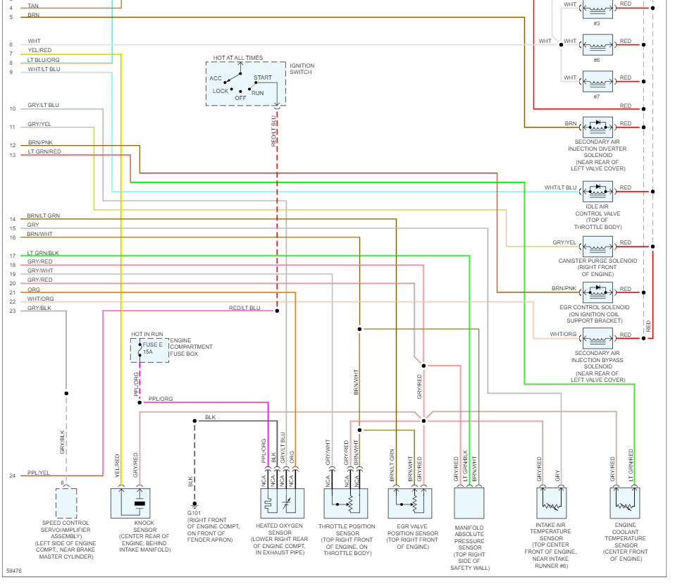

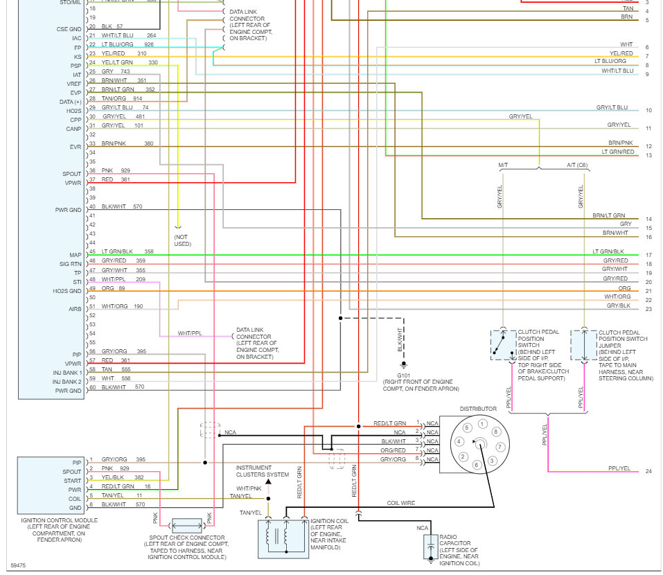

Did you install a new PCM power relay? Here are the wiring diagrams for the PCM and a guide to help check for power and grounds. I would start by unplugging the injectors because you may have one that is shorted which will cause the PCM to dump voltage.
