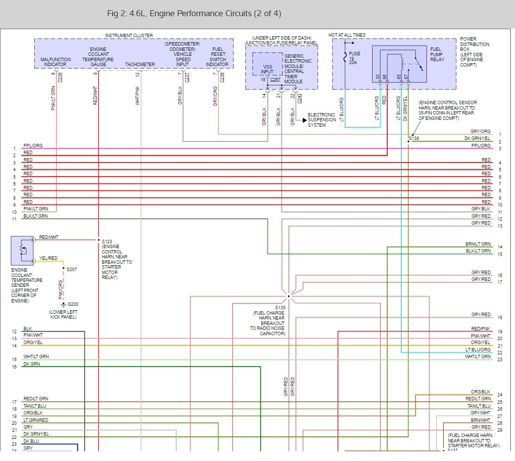

I have a truck that will not start. I wired the fuel pump directly to the fuse box to infuse that only comes on when the ignition is on. It will start and run for a few minutes then seems like it is flooding itself and shuts off. The yellow wire on the fuel pump relay has come out. Is there a way I can directly wire the fuel pump to the relay itself instead of the fuse box and if so will that work?

Hey CHRISTOPHER,
You should rewire the fuel pump the way it is suppose to run, here is a wiring diagram which will help you fix the problem.
Please let me know who it goes so I can continue helping you.
Does the truck have dual tanks?
Best, Ken
