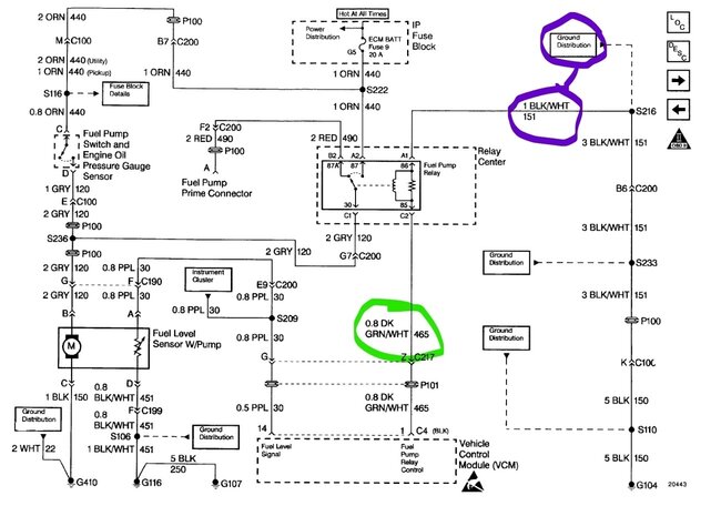

Fuel pump relay?

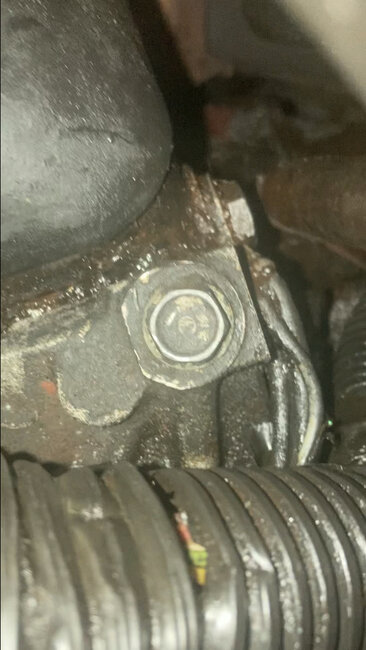

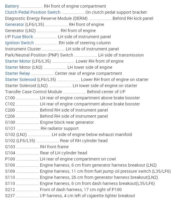

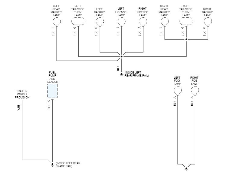

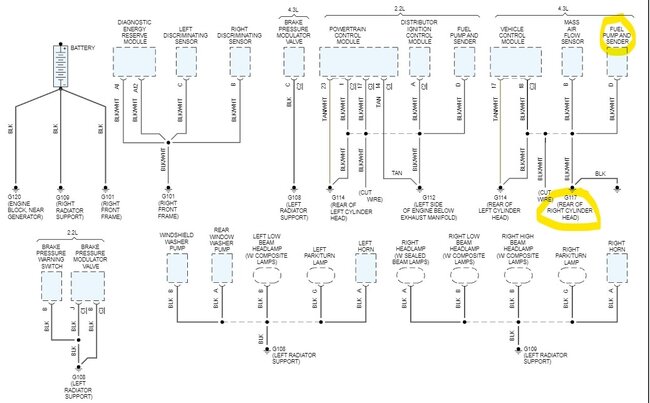

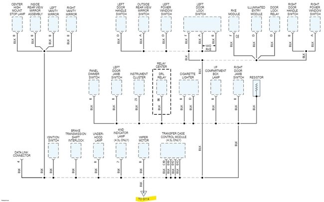

Same location on the opposite head. These are the engine compartment grounds. The list are the grounds and splices for ground wires. They are all interconnected in many ways. A common one is the ground strap that runs from the right head the body, I replace those with a universal ground cable even if they look good. Because of the way they are put together a bad ground can cause a lot of weird problems.
Thank you man.
Apr 28, 2023 at 8:32 AM
Sorry about the delay, I was frustrated a few days and had gout a few days, I needed to clear my mind anyway. My question is, since the wire going from fuse box to relay center is orange it must have power always, since I’m not getting the priming signal to the relay (I believe I’m not) can I test the green with white stripe wire with a voltmeter for the two second prime. I know it has continuity from the PCM to relay center.
Thank you
Thank you
May 7, 2023 at 11:22 PM
Sure. That wire at pin 85 should have power from the PCM for the prime signal.
May 7, 2023 at 11:49 PM
So, it will get that 2-3 second signal. Will it be 12v or say 5v like the TPS?
Thank you
Thank you
May 8, 2023 at 12:09 AM
it should have a 2 second 12 volt signal.

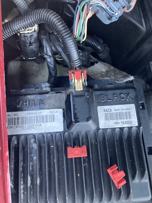

For the injectors just use a test light connected in place of the injector. It should flash if they are getting power. If you have a way to check the timing those engines have a bad habit of eating the crank sensor mounted on the front of the engine, they fail but don't set any codes.
May 27, 2023 at 10:18 AM

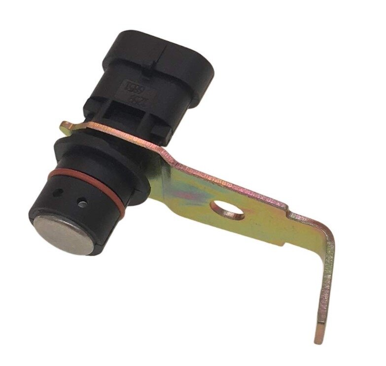

Thanks Steve, I replaced the crank sensor and have the same results with the new one as the old one, so I put the old one back in. I got a code p1361 which says ignition control module, I'm fixing to put a new one on in a minute, but I am getting spark so I’m not sure if this has anything to do with timing, but I’ll find out shortly. From day one I’ve gotten a throttle position sensor code, it’s been cleared many times along with other random codes I created along the way to make sure my reader was working, I’ve put in a new one and the old one back in a couple times and this code refuses to go away, any thoughts?

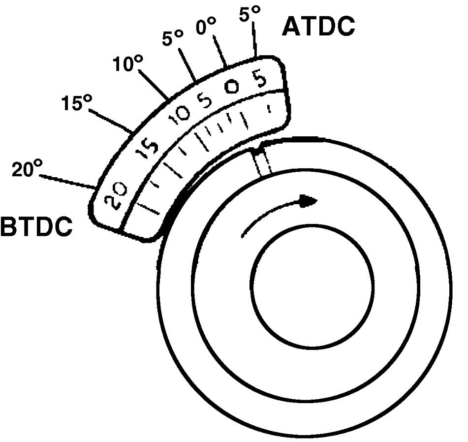

Pretty much nothing built after 94-95 has adjustable timing. The ECM does it all. From everything so far, I'm going to say it's an ignition issue. Get an old-style timing light and use it to check the timing on number one. See what it shows. Might not be a bad idea to move it to different cylinders just to be sure that the distributor is turning.

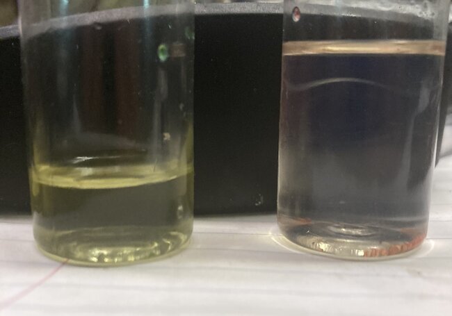

I can appreciate that for sure, but I have between 1/4 and 1/2 tank. I took some gas out to see if any water was present but it doesn’t appear to be, I even split the sample and added water just to compare and it doesn’t appear to be compromised, I’ll send a pick of the fuel that came out of the truck compared to fresh from the gas station when I’m done here. I don’t have any experience or explanation for my plugs being so wet with gas, I’m figuring that is why it won’t fire. I used an inline spark tester and it showed all 4 plug wires I tested (out of 6 of course) and I even watched the spark arc to a bolt with a screwdriver in the wire and it looks pretty good. What should I be looking at in the morning?

One on left came out of my truck.
May 29, 2023 at 1:41 PM
Toss some on a paper towel and see how it lights up with a match. Almost looks like diesel but you would know by the smell.
May 29, 2023 at 2:02 PM
Funny how you think things look normal until you have something to compare it to!!!
Definitely gasoline, I’m looking forward to the fire it up and see if it burns test in the morning. Thanks again for all your time and input.
May 29, 2023 at 4:19 PM
Both fuels ignited the same on a paper towel so I can cross off bad gas. Why won’t it ignite in the cylinder? I left the driver's side plugs out overnight hoping it would dry out, I didn’t do passenger side because the mosquitoes said they’d get it and I should go in, but I don’t think they did, well I can compare one side to the other here shortly. I have spark on the wires, I’ve cleaned all the plugs (that were new already) once and now drivers side again, cap and rotor new, ignition control module new(didn’t put thermal silicone or whatever it is on because I believe I’ll be taking it back), crank sensor was renewed along with wiring pigtail, throttle position sensor renewed (still the only consistent code that I have) not found the chafing section you mentioned earlier yet. Before replacing the positive battery cable, I could get it to run by bypassing fuel relay, it would run about perfect for 45 seconds then bog terribly and pushing the throttle pedal didn’t help or made it worse, that happened about 10 times. If I forgot anything I’ll forward it.

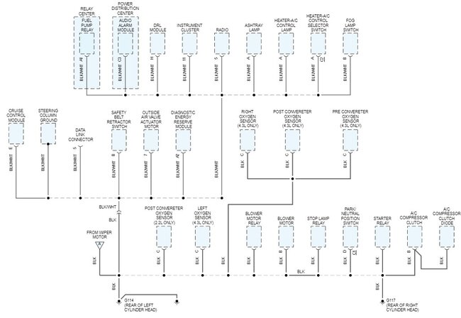

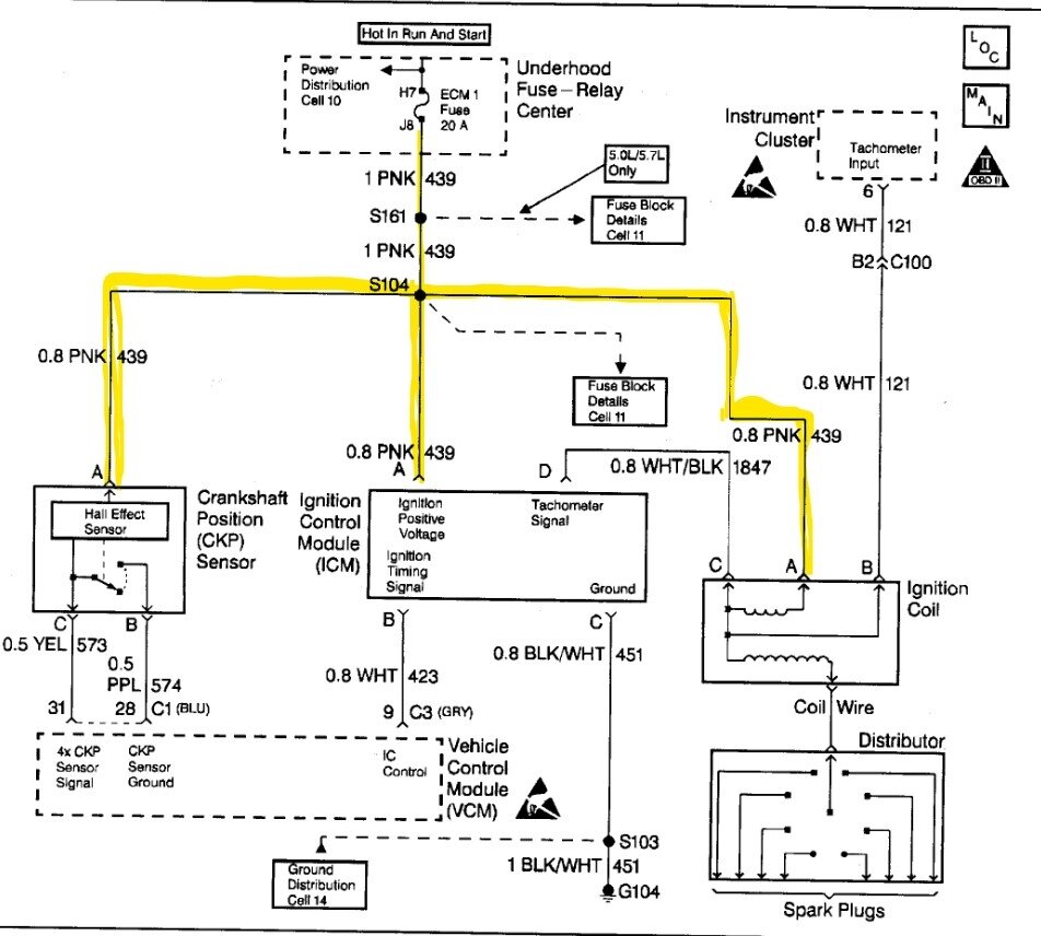

Test ground by running a jumper cable in parallel to the current ground. One clamp on ground post one on engine block. If it suddenly works you have a bad cable. If not, you didn't spend money. OOOhh P1361 - Low voltage to ignition system! That could stop it from firing and burning the fuel. This might help
The enhanced ignition system provides the timing input to the Vehicle Control Module (VCM) with a crank sensor. The VCM uses this reference pulse in order to determine the individual ignition spark timing for each cylinder.
Once the VCM calculates the ignition timing, the ignition coil module on the Ignition Control (IC) circuit receives the timing signal. Each timing pulse received by the ignition coil module, on the IC circuit, triggers the coil module in order to operate the ignition coil. The secondary ignition voltage is induced, and then the secondary ignition voltage is sent to the distributor for distribution to each spark plug. This DTC is a type A DTC.
The IC signal voltage ranges from about 0.5 volt to 4.5 volts.
CONDITIONS FOR SETTING THE DTC
The engine speed is below 3000 RPM, and the voltage on the ignition control circuit is below about 0.04 volt.
DIAGNOSTIC AIDS
A poor connection, a rubbed through wire in the insulation, or a wire broken inside the insulation will cause an intermittent.
Check for the following conditions:
1. Poor connection
2. Damaged harness Inspect the VCM harness connectors for the following conditions
Backed out terminals GR 9 and Bk 18.
Improper mating.
Broken locks.
Improperly formed or damaged terminals.
Poor terminal to wire connection.
Damage harness.
3. Intermittent test - If connections and harness check OK, monitor a digital voltmeter connected between VCM terminal GR 9 and BK 18 while moving related connectors and wiring harness.
If the failure is induced, the voltage reading will change. This may help to isolate the location of the malfunction.
TEST DESCRIPTION
The numbers below refer to the step numbers in the diagnostic table above
2. If the engine starts at this point, the DTC 1361 is intermittent.
3. This check determines if the IC signal from the VCM is available at the ignition coil module.
9. The remaining tests begin to check that the ignition coil module circuitry is OK. If the ignition coil module loses its voltage source, the secondary voltage will not be produced, and a DTC P1361 will set.

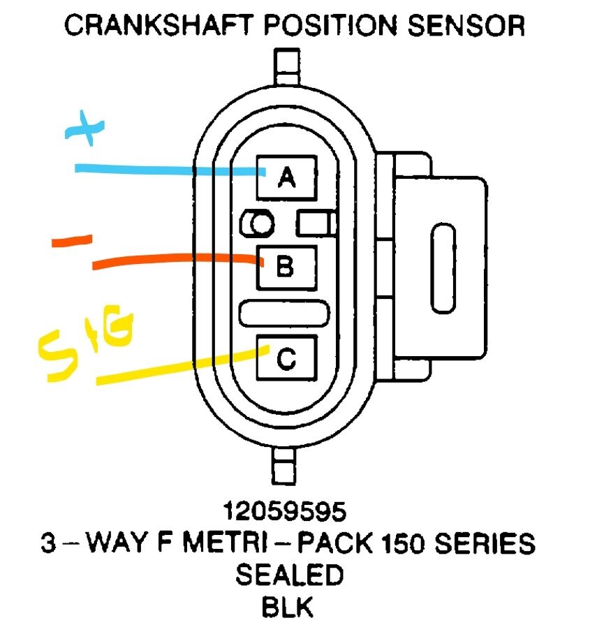

I would check for voltage at the coil, ICM and crank sensor using a test light. A meter will show voltage if even one strand of wire is OK. Another thing will be to check the ground from the ICM and coil. The ICM grounds through pin C the coil grounds through the body. OH on the ICM, apply some compound to it, those have a very bad habit of frying from heat. It's why the one in my 2002 was mounted to its own heat sink.

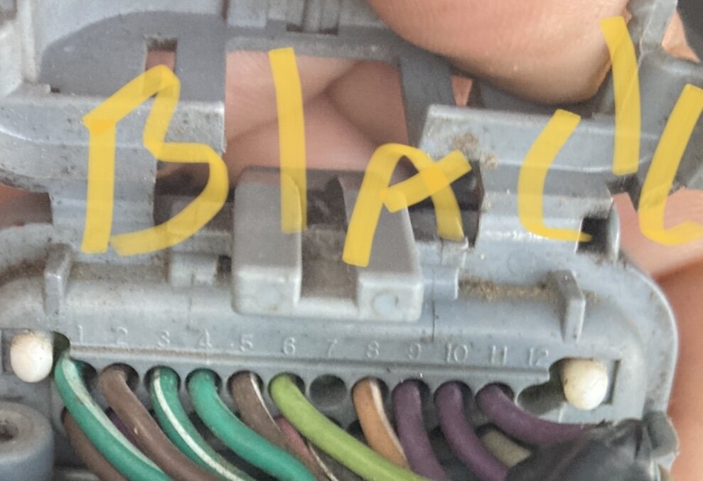

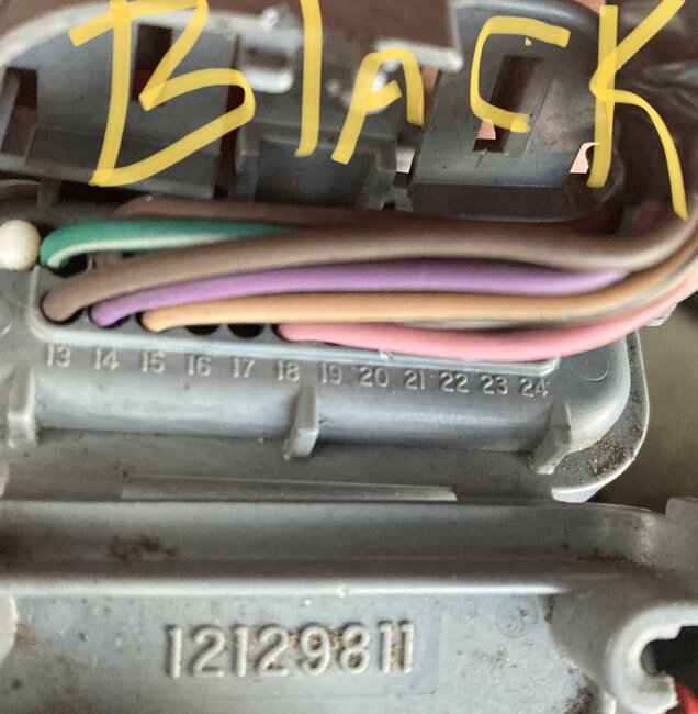

G9 isn't likely the problem, if it was you would get a different error. You want to check the voltages at the other three. Then the ground on the ICM. That would be more likely.

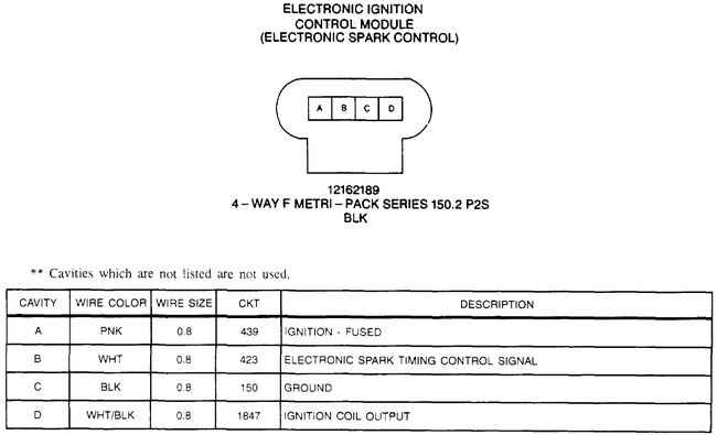

So, I put my original ignition control module in and ran the same tests and results were:
ICM
Key off 12.75
Key on 12.75
Cranking 10.8
Coil (pink/bk)
Key off 12.75
Key on 5.5
Cranking 1- 1.15

One last piece of the puzzle I’d like to add, I believe I have found a short that is associated with fuse #9 ECM/BATT and I did so using this method:
https://youtu.be/9wLrTjeb9TY
Jun 2, 2023 at 5:22 AM
I haven’t found the short yet, I just figured this out and wanted to pass it along. Thank you
