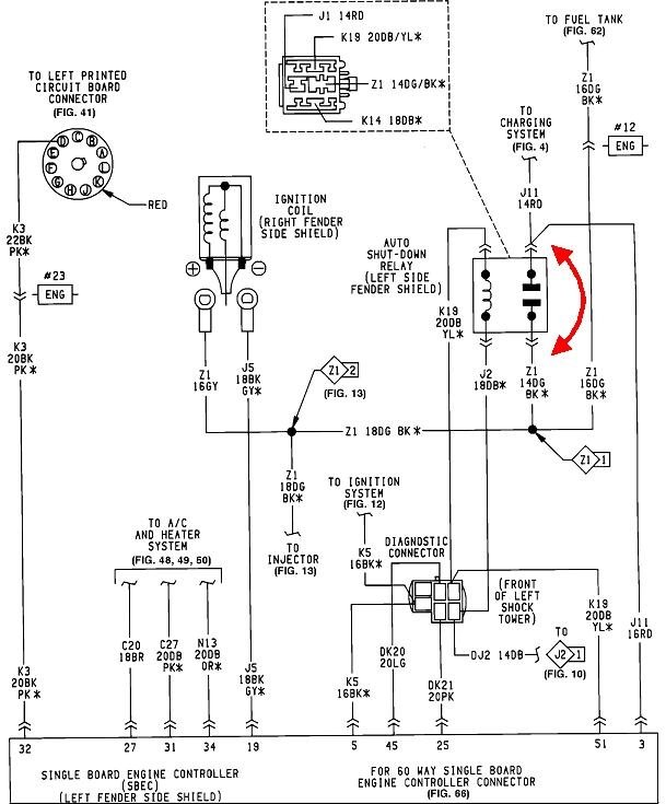

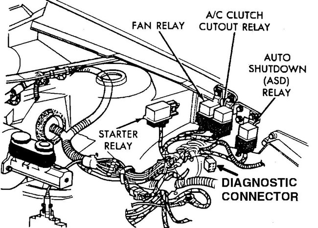

There is no separate fuel pump relay on this dandy little car. The fuel pump, ignition coil, injector, and alternator field all get their 12 volts from the automatic shutdown, (ASD) relay. That relay is turned on by the Engine Computer any time the engine is rotating, (cranking or running). It knows when that is by the signal pulses it receives from the distributor pick-up assembly.

Car shut off while driving. Has gas cranks but does not start, clean fuel filter put in new pump in and still do not hear pump coming on. Took all the relays off and car still cranks with them off.

Cranking has nothing to do with the ASD relay. If you do have spark, we know the ASD relay is turning on, so the cause of the dead pump has to be after that. You will need to check for 12 volts on the dark green/black wire in the fuel pump's connector, but you have to do that while a helper is cranking the engine. As an alternative, you can unplug the ASD relay, then use a stretched-out paper clip, or piece of wire, in the socket to jump the red wire to the dark green/black wire. The ignition switch does not have to be on for this. The jumper will put 12 volts on the dark green/black circuit so you can test for that at the pump's connector.

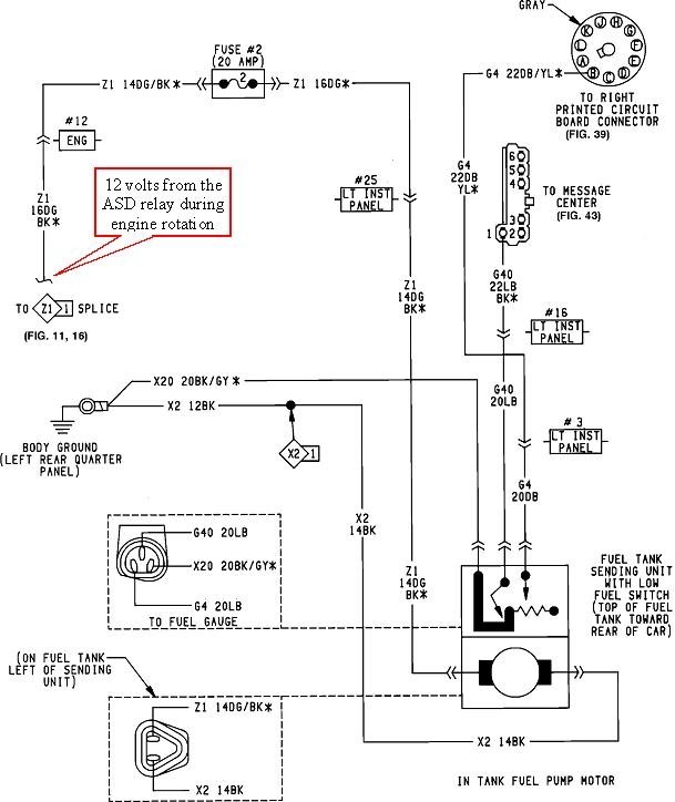

You said that already. That's how we know you have spark, and that's how we know the ASD relay is turning on. That is what sends 12 volts to the fuel pump, so if the pump is never running, you have to have a break in the 12-volt feed wire, a burned connection in the pump's electrical connector, (I've run into that twice), a bad pump, or a break in the ground wire.
Don't overlook fuse # 2. It is for only the fuel pump. In the rare event the old pump motor was shorted or locked up, it would likely blow that fuse, then your new pump would also be dead.

You missed the most important parts of my story. First of all, you jumped the ASD relay and you observed the fuel pump runs. You're done. The pump circuit is working and there is no point in looking at that any further.
The second point is you must not have 12 volts at the pump when you are just sitting there with the ignition switch turned on. You will have 12 volts for only one second when you turn the ignition switch on, then it must go back to 0 volts until you start cranking the engine. If that 12 volts does not come back during cranking, that is because the ASD relay is not being turned on at that time, and that is almost always due to the failed distributor pick-up assembly.

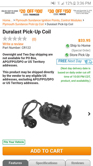

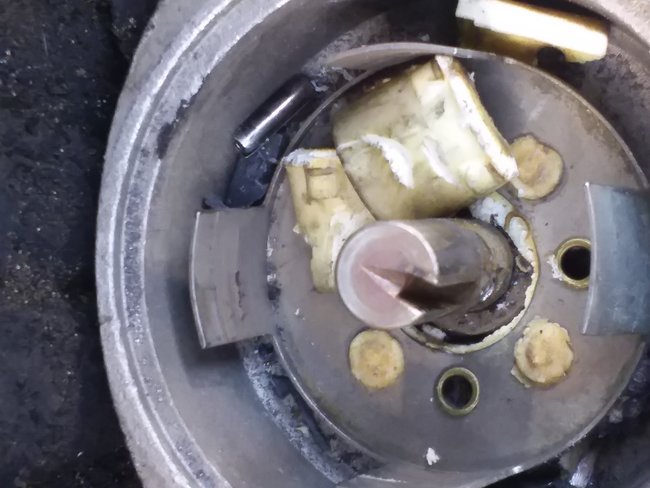

Did not get a spark. Is this what I need to replace under the cap and rotor?
Nov 6, 2018 at 1:38 PM
MARC WOODS
  • 53 POSTS

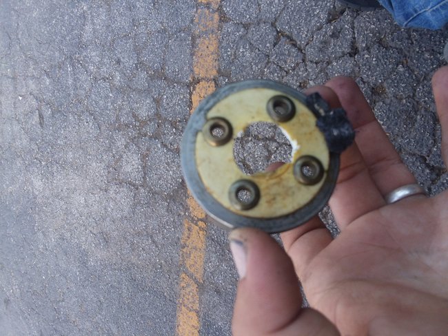

This is what I found under pick up assembly.
Nov 6, 2018 at 1:50 PM
CARADIODOC
  • 34,321 POSTS
Yes, that is a high-failure item. Lots of people used to carry spares in the glove box.
What is that white piece the blue arrow is pointing to? That looks like a piece of broken rotor. The red arrow is pointing to what looks like a roll pin. Neither of those things should be there.
Nov 6, 2018 at 1:58 PM
MARC WOODS
  • 53 POSTS
Did not put the arrows in there but yeah did not think they should be there. I will check rotor make sure it is not damaged too. Thanks for the help will let you know if it is the fix.
Nov 6, 2018 at 2:35 PM
MARC WOODS
  • 53 POSTS

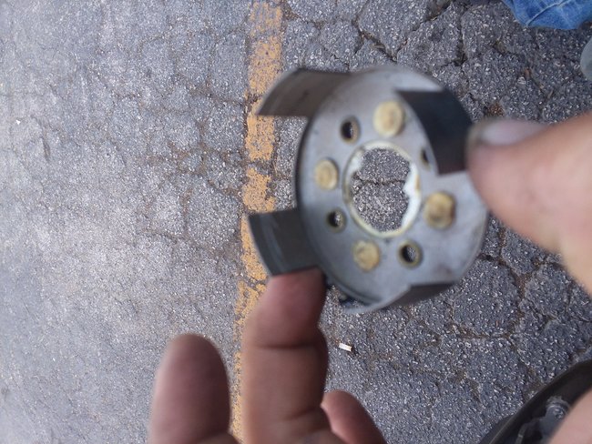

The white stuff went to this not sure what it is but was under the pick up assembly. Not sure if it comes with the new one.
Nov 6, 2018 at 3:34 PM
CARADIODOC
  • 34,321 POSTS
That is the shutter wheel. To generate a current mechanically, you need a magnetic field, a coil of wire, and most importantly, movement between them. In this case, there is a magnet in the pick-up assembly, and a "Hall Effect" transistor. That is a special transistor that is turned on in the presence of a magnetic field. The movement in this case is when one of those shutter blades passes between the magnet and the Hall Effect transistor, it disturbs, or bends the magnetic field. The change in the strength of the magnetic field is what triggers the transistor, and that pulse is amplified by the circuitry in the pick-up assembly. Those signal pulses arrive at the Engine Computer, and that is how the computer knows the engine is rotating and it's time to turn on the ASD relay.
