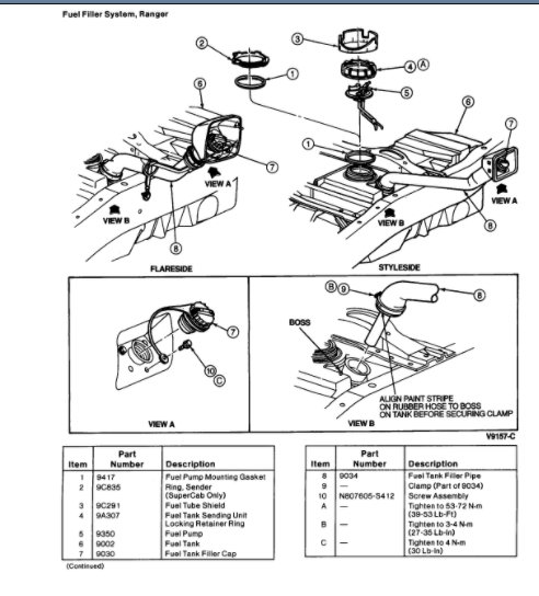

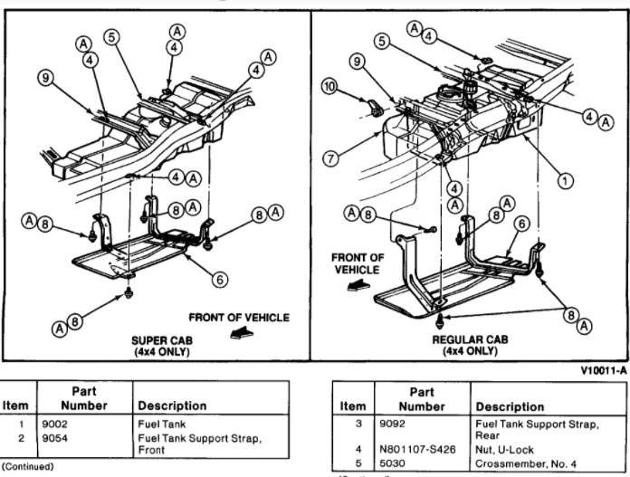

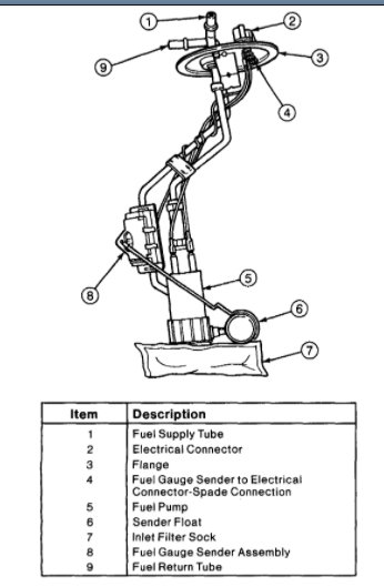

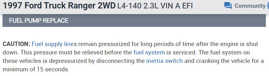

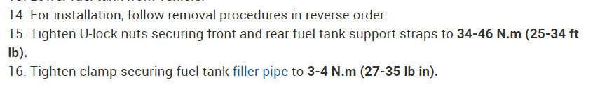

It would save a lot of time and money if it's just the relay. Here is a tutorial showing how to test a relay:
I would suggest performing a fuel pressure test to rule out a weak or failing fuel pump. Here is a tutorial showing how to perform a fuel pressure test:

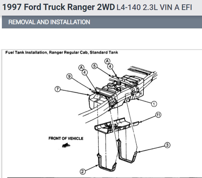

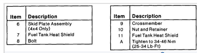

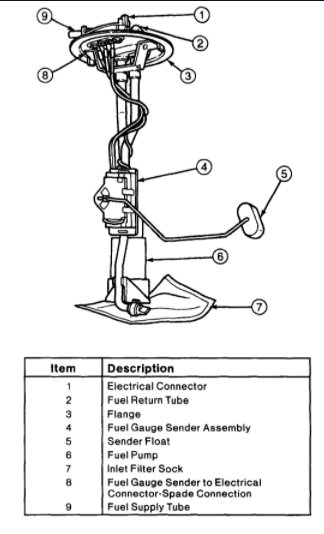

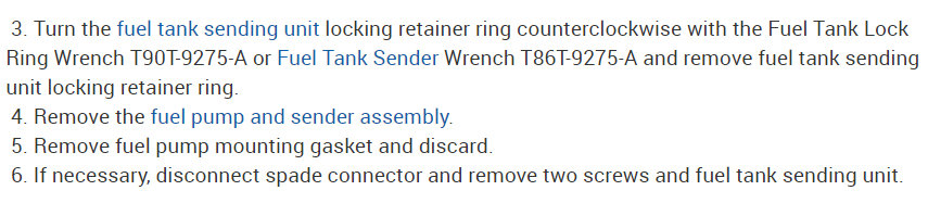

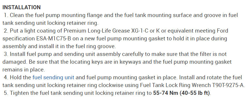

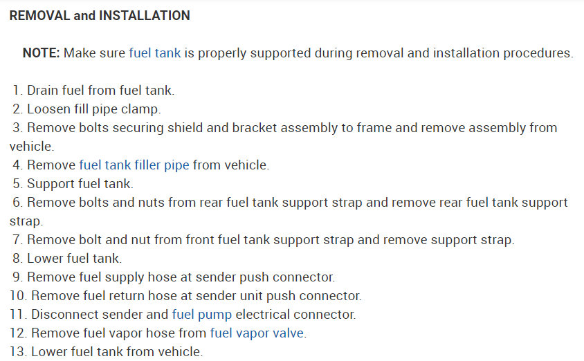

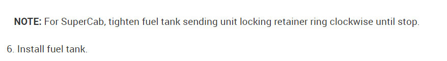

The correct fuel pressure specification for your Ranger is 35-40 psi when running. After performing these tests get back to us with the results and we'll go from there. If the pump is bad here is a tutorial showing how to change an in-tank fuel pump:
https://www.2carpros.com/articles/how-to-replace-an-electric-fuel-pump

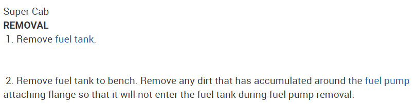

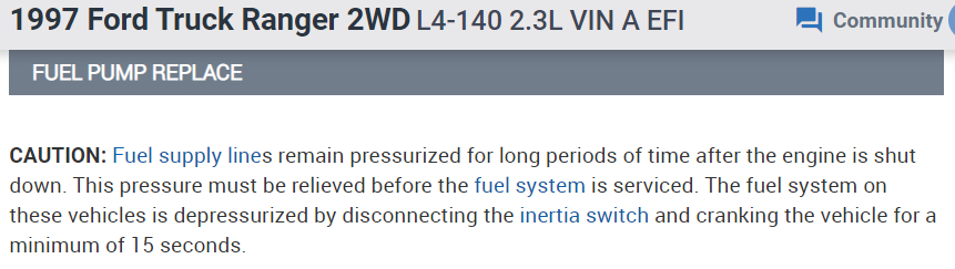

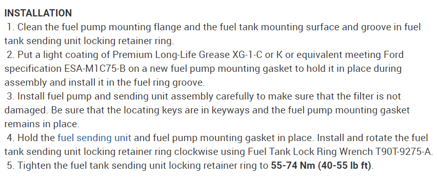

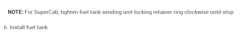

Here are picture steps attached below on how to drop the fuel tank and replace the fuel pump for your truck. Hope this helps and thanks for using 2CarPros.

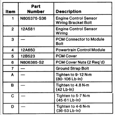

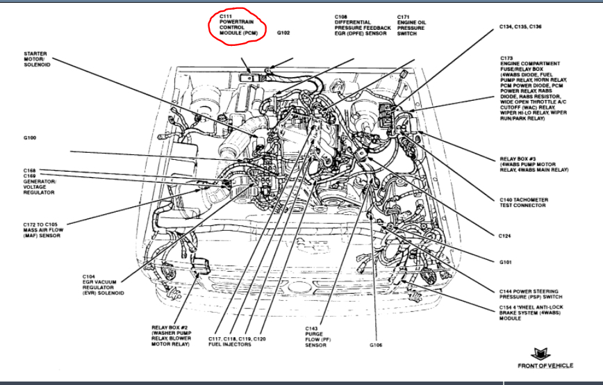

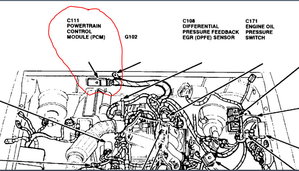

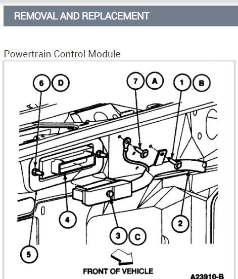

So I figured out my trucks ignition module is integrated with the ECU. Where is that located? In cab, passenger side wall? Or top of fire wall passenger side in engine compartment?
Jan 4, 2021 at 4:00 AM
DANNY L
  • 5,648 POSTS
Hello again.

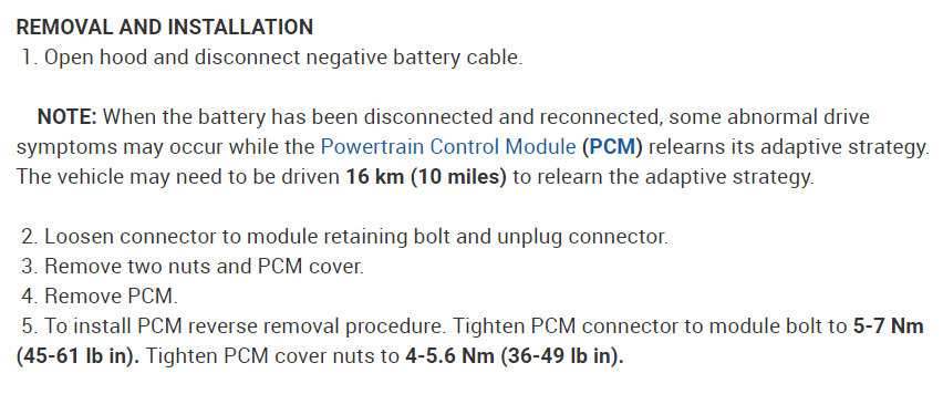

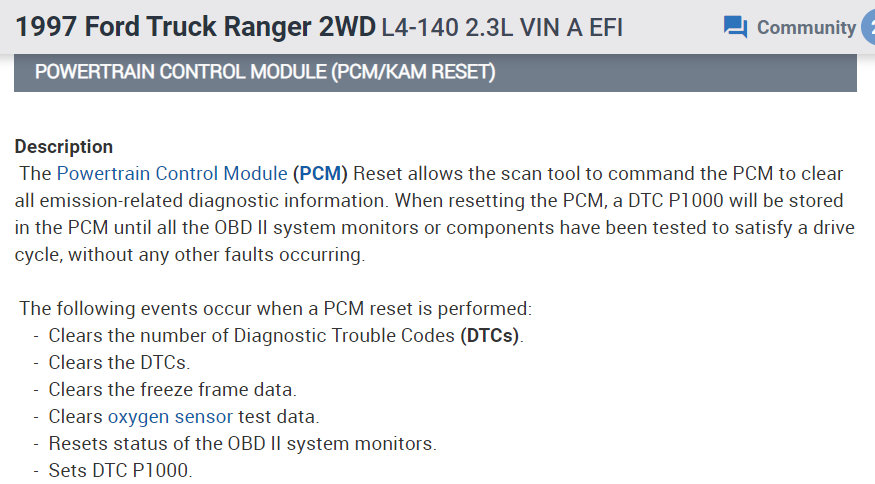

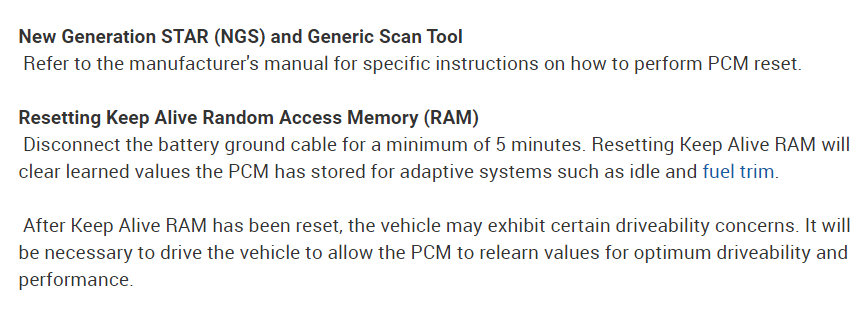

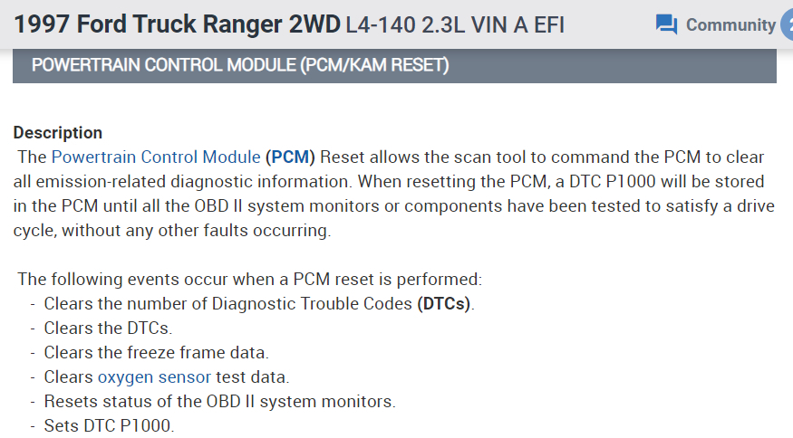

Yes, that is correct. The ignition control module is built into the pcm- powertrain control module. By using a professional scanner you can perform a PCM reset. You might want to try that before replacing due to the high cost of a PCM. You can save money by going online to get a refurbished pcm or find a site that is less expensive than getting from a Ford dealer. I've attached picture steps below on the reset procedure as well as how to remove and replace the PCM on your truck. The location is under hood on the firewall and its picture is attached as well and circled in red. Hope this helps and thanks again for using 2CarPros.
