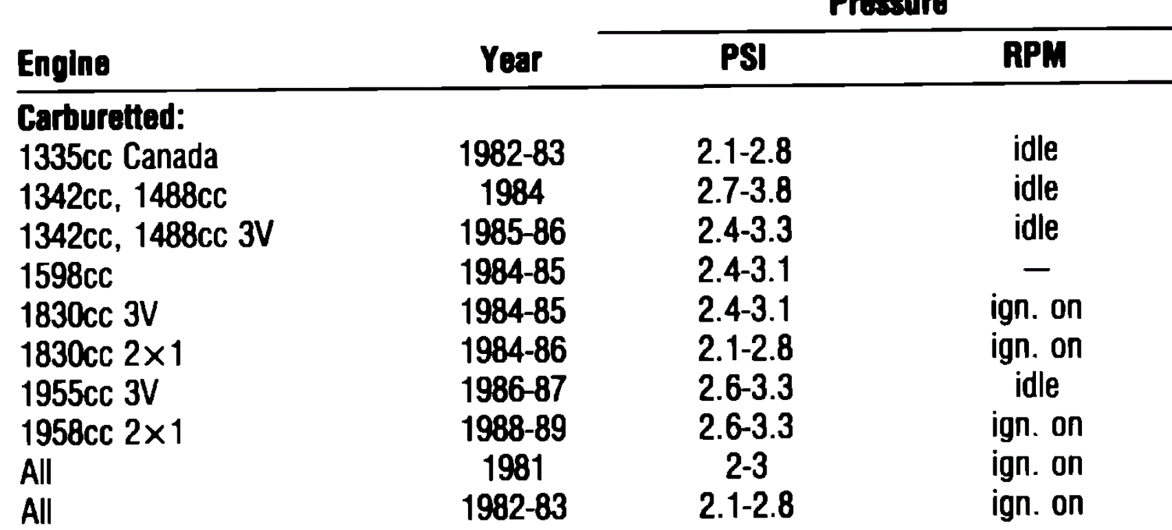

1985 Honda Accord (manufactured in Japan) 4-door sedan "S" (Standard) with 132,000 miles, a 1.8 liter carbureted engine ("Low Altitude (49 ST)" Emission Group), and a 4-speed automatic transmission starts normally but immediately wants to shut off unless the accelerator pedal is vigorously pumped. Even then, keeping it running for any length of time is extremely difficult. This began as an intermittent problem and later progressed to the point where it is now stuck in my garage.
It has an automatic choke which appeared to be functioning properly the last time I was able to check it (the choke plate closed when the engine was cold, and it slowly opened as the engine warmed up). The air filter, distributor cap/rotor and fuel filter were replaced just recently.
Is there any chance this is enough information for you to know that the fuel pump is the problem and not the carburetor or one of its many components?

As far as the fuel pressure, I attached a pic below showing what the pressure should be. You could get a 'T' and put it between the fuel line and carburetor to confirm pressure. Here is a link that shows in general how it's done:

I caved and took it in to a carburetor expert. He found what appeared to be a failing electrical connection at the primary main cut-off solenoid valve. He cleaned it up and secured the connection. So far, the car appears to be back to its old self. However, he expressed some apprehension saying that he's never seen this particular electrical connection fail before (his shop has at least 50 carburetors of all types and sizes on the wall, and he's been at this for years--lots of classic muscle car work). He also said that the solenoid is no longer manufactured. He told me to drive it for a while to see how it behaves. I will keep your guidance handy just in case. Thanks again....
