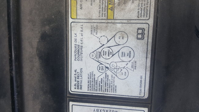

Hopefully this will help to indicate the engine size.

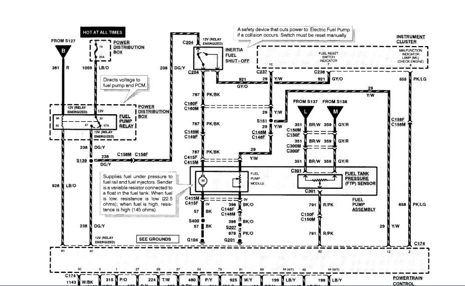

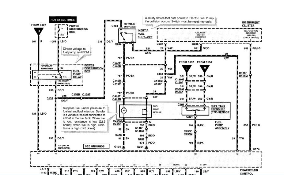

Good afternoon.
There is no driver module on this model.
Two relays? There is only one fuel pump relay.
I attached a wiring diagram for you to view.
Verify power to the inertia switch with the key on. It will only be there for two seconds. Then when you crank it, there should be constant voltage.

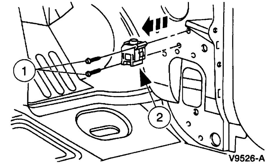

Excellent!! Thanks for the information. As I review the diagram, I understand what I need to troubleshoot. What I do not recognize is where to begin the search. Is this under the truck or under the hood?
May 31, 2021 at 5:43 AM

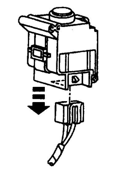

The inertia switch should be at the right kick panel. Remove the panel. It should only be held by some clips. It will have a button on top.
REMOVAL
1. Disconnect the battery ground cable.
2. Remove the RH cowl side trim panel.
3. Disconnect the electrical connector.
4. Remove the Inertia Fuel Shutoff switch (IFS switch).
1. Remove the bolts.
2. Remove the inertia fuel shutoff switch.
